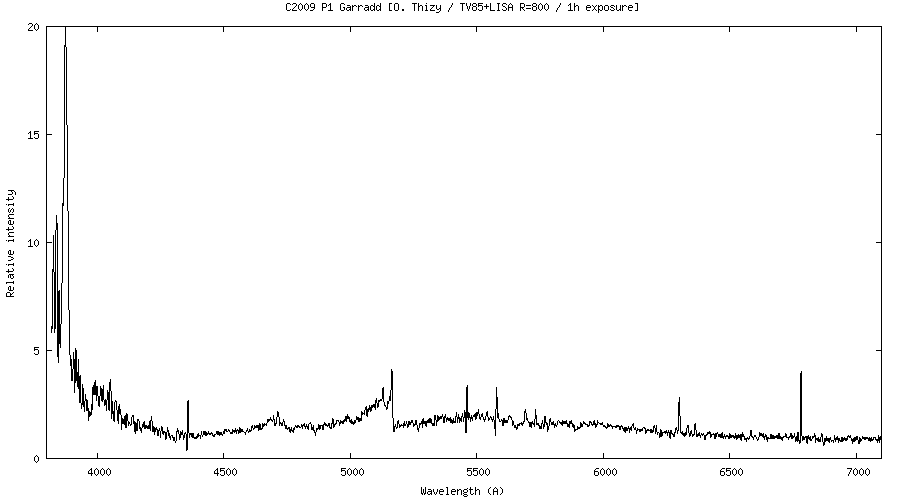

Re: Comet Garradd - 26/03/2012
Post by Olivier Thizy »
OK - here is my spectrum of C/2009 P1 Garradd in 1h exposure with LISA + Televue 85. Not as good but features well visible...
To process it, I created a dummy dark & offset frame (note: I had to do it in AudeLA and not ISIS as I had to set the exposure time for the dark). I then substracted the comet 2D images with the sky background images and added them together into a single 2D image to process.
This worked but I still have strong emission lines visible in my image - some pollution I couldn't remove.
Anyway, here is the spectrum profile:
Spectre de la comète C/2009 P1 Garradd.
20120331 C2009 P1 Garradd.png (5.6 KiB) Viewed 5176 times
