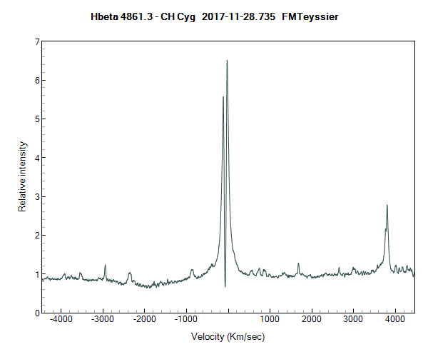

Spectrum obtained on Nov, 28
with a correct SNR in the bue (SNR 30 at 4200 A)
Absorption in the blue edge of H beta,with max velocity ~ -3000 km/s
but less deep than in James' spectrum

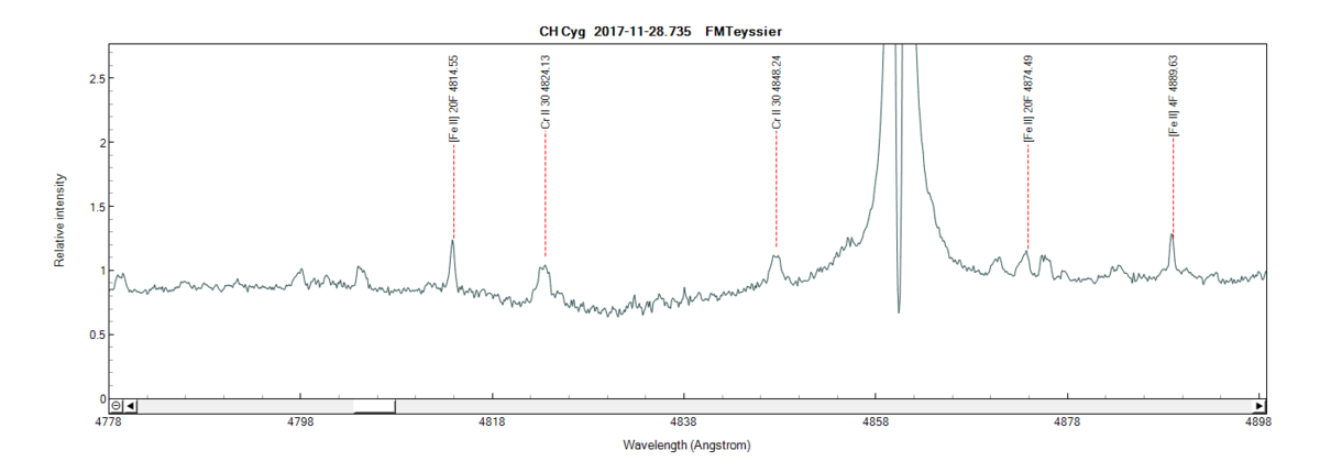

Blue region
Commented H beta range. Note the broad Cr II lines (FWHM ~ 80 km/s)
After strong variation at a time scale of minutes, CH Cyg current state shows important variation of the absorption in thye Balmer lines
A fascinating star!
