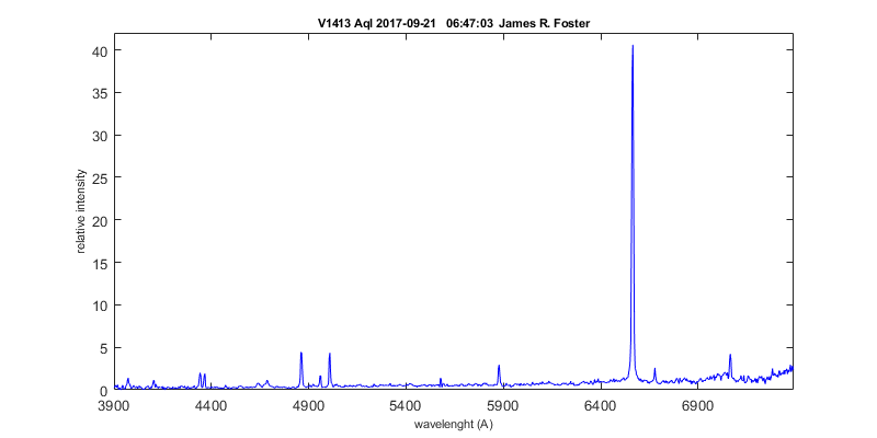

AAVSO LightCurve (V + Vis)
Last spectrum in the database, obtained by James Foster
ARAS Eruptive Stars DataBase : http://www.astrosurf.com/aras/Aras_Data ... 413Aql.htm
(Thanks to David Boyd for the message)
