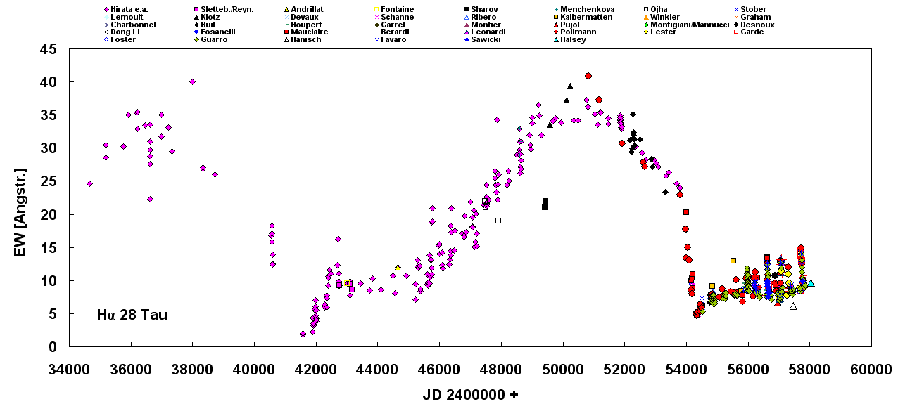

Dear colleagues,
the coming season offers again the opportunity to supplement our studies of Halpha radial velocity and V/R of Plejone (upper Fig.). Even if our monitoring so far did provide a fairly stable period of both, this measurements are performed while the Halpha EW of the disk was (more or less) in its minimum (Fig. bottom)
It is not known, what happens with RV & V/R if the disk EW growth up again.
