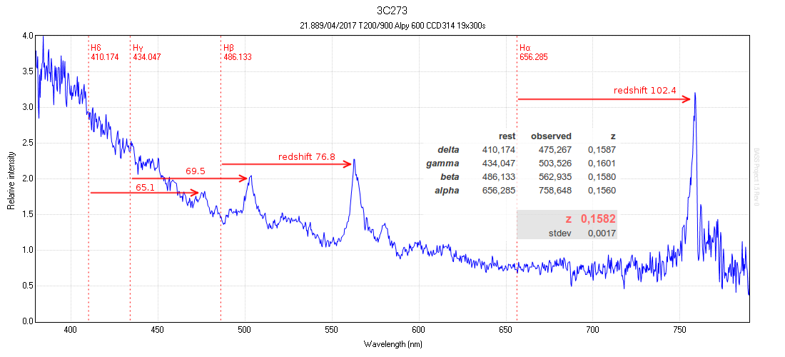

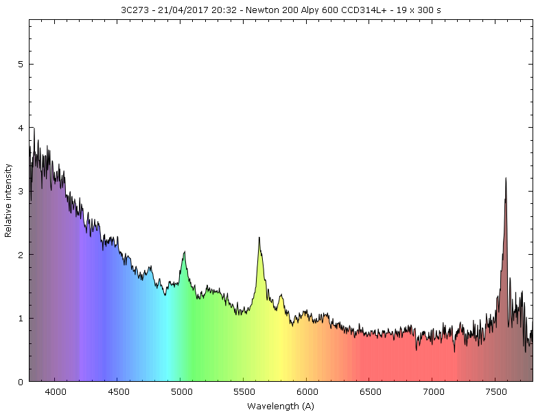

Posts: 154
Re: 3C273 with Alpy600
Post by JP Nougayrede »
Just another spectrum of this classic target, very fun to observe with the Alpy, even under orange skies.
Bon ciel à tous,
Jean-Philippe
