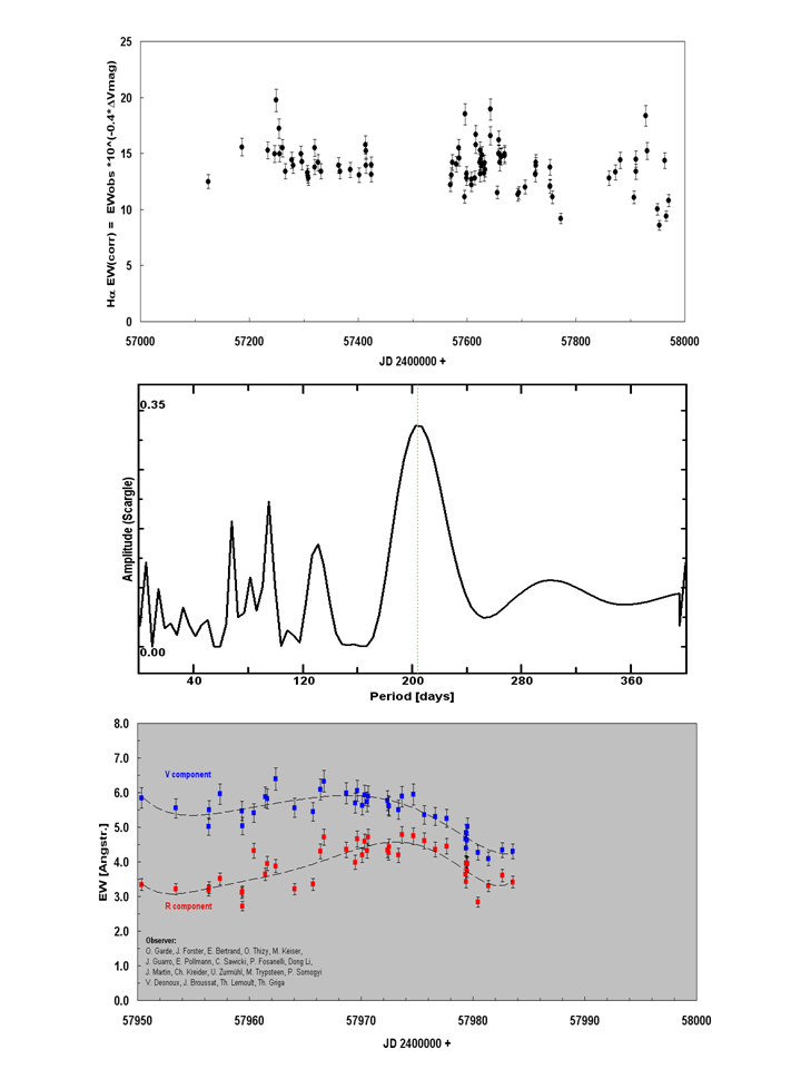

Dear colleagues,
has the eclipse really begun?
I would like to show the Halpha line flux (as delta Vmag corrected EW of the time span JD2457124 (April 11, 2015) to now (upper diagram of the attached Fig.). This quantity is not the line flux in physical units, but a quantity proportional to the physical line flux, corrected for continuum variations. I used this data in order find out some information about the character of the flux variability (period analysis, program AVE). The Scargle periodogram (middle Fig.) shows a period at approx. 200 days.
I don´t want to say that this period is really existing, but it gives at least an impression of the character of the Halpha (quasi) flux variability. Also the V&R EW of our monitoring seems to be at least not constant (but cyclic?). Question is what are the causes? Dense variability in the outer atmosphere of the M super giant?
Flux variability.png (91.89 KiB) Viewed 13264 times
Ernst
marcoastro+
Posts: 28
Joined: Thu Oct 11, 2012 8:12 pm
Re: Observation state of the campaign
Post by marcoastro+ »
Very interesting approach, Ernst.
Possible (non linear) pulsation cycle detected here?
Marc.
