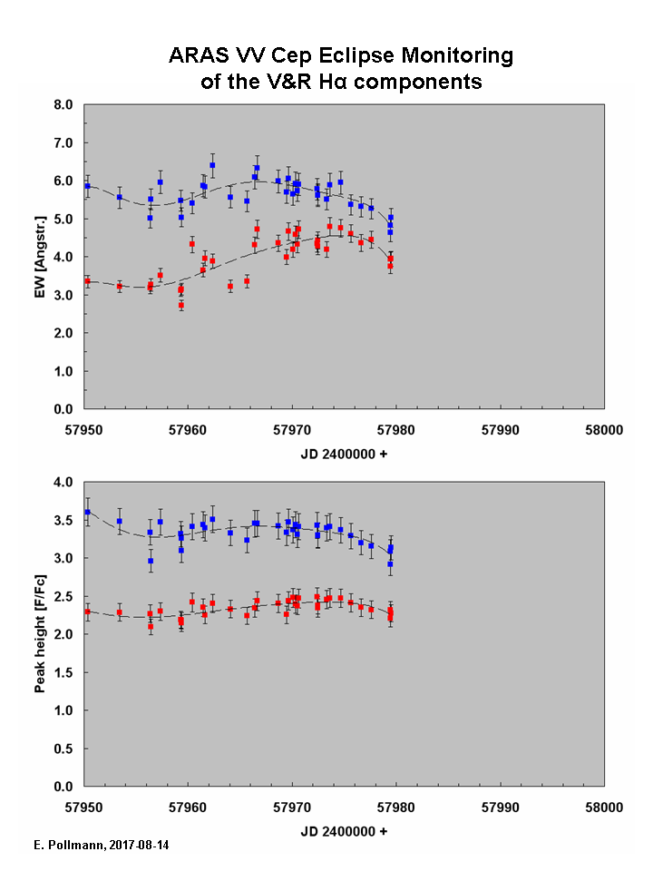

- Posts: 461
Re: Observation state of the campaign
Hi Thilo,
the diagram above is an enlargement the entire base line monitoring (the attached Fig.) of the group. It should show more in detail the EW & PH behavoir during the last few days. Hope this helps for your understanding.
The left-hand side (= blue component) of the accretion disk of the B-star (which will be obscured first by the semitransparent atmosphere of the M-super giant in the line of sight) already shows a recognizable descent at JD 2457967, both in peak height and in EW.
On the other hand, the right-hand side of the accretion disk (= red component) shows a time-delayed start of coverage at JD 2457976 (also in peak height and EW).
However, it would be to early, to make statements about the size of the disk with this (vague) temporal difference and the system radial velocity.
Ernst
Ernst

Dear colleagues,
Indeed, the remark on the "lucky weather" of Thilo is interesting.
In our region it is so far the worst "cloudy" night summer in the past 10 years.
Concerning the observation state of the campaign: Ernst mentioned a turning point can be expected.
However as nicely explained by Phil Bennett the H-alpha measurements are the sum of two contributions: the smaller "accretion" disk around the B star and the more exhaustive zone of the generated H II region, which stays during totality.
Important for the spectral behaviour here is the influence of the compactness of the H II region. If its density changes when passing in front of the spectroscopic line of sight, this can influence the recordings. All depends on the behaviour of high or low density clumps, which can also be remnants of earlier mass transfer or compressed zones by winds or magnetic fields. This also influences the "steepness" of the decreasing peak heights and represent a more impressive impact on the EW values. Therefore it is not so easy to detect the exact start of the real eclipse i.e. the disappearance of the accretion disk. Even during totality a varying spectral behaviour can be measured.
KInd regards,
Marc.

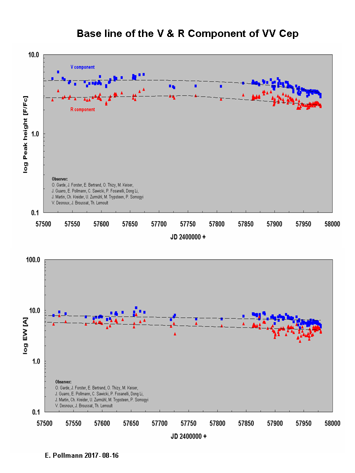

- Posts: 461
Dear colleagues,
the observation state of the VV Cep eclipsing campaign has been up dated:
http://astrospectroscopy.de/media/files ... erview.pdf
