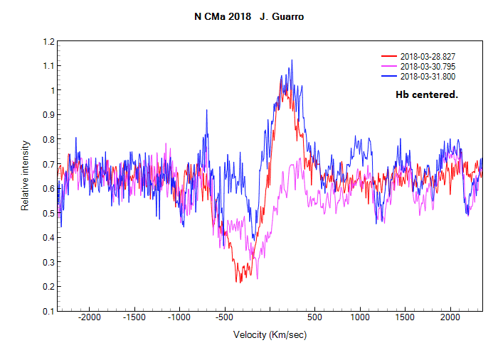

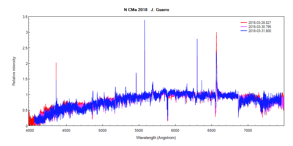

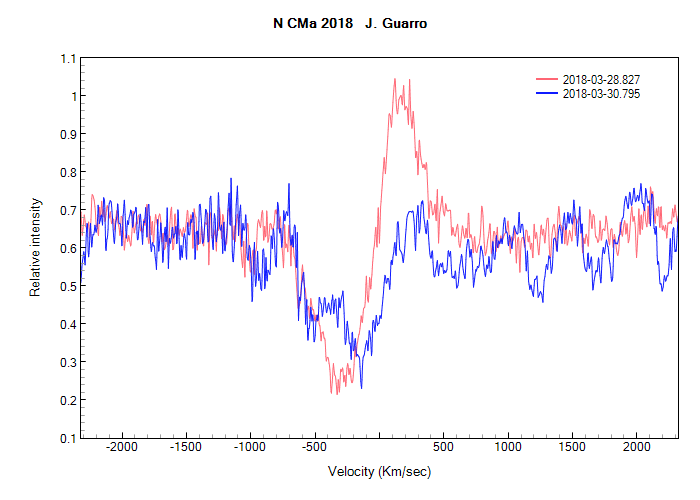

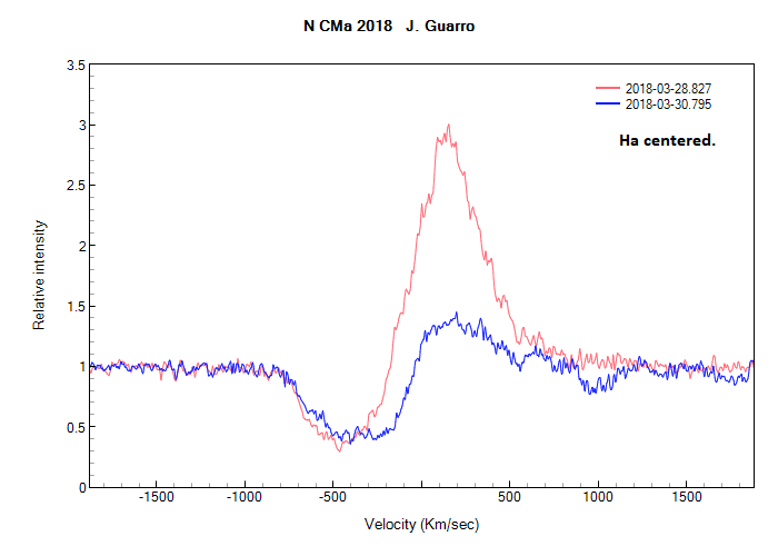

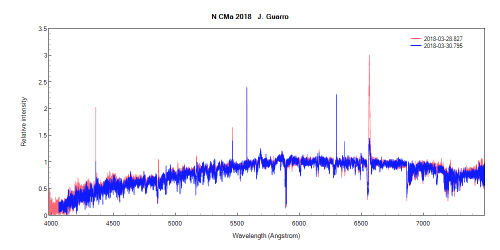

This past night, I was able to observe the N CMa2018. I have been able to make two integrations of 2000 seconds with the LINX of Sta. Maria, before the sky clouded and 5 integrations also of 2000 seconds, with MUSSOL de Piera. The blue graph is the result of the sum of all seven.
Certainly Olivier, the difference of a few degrees of latitude between us two, is very decisive. But Forrest has a lot better, (L = + 33º).
As it can already be seen in the graphs of Forrest, (days 20180327 and 20180329), the intensity of the lines of the Hydrogen is falling very depressed.
Regards, Joan.

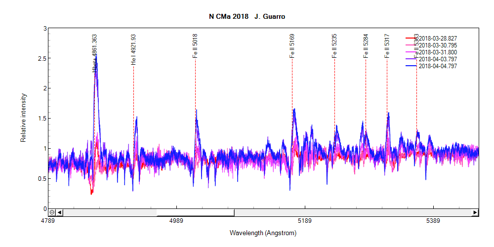

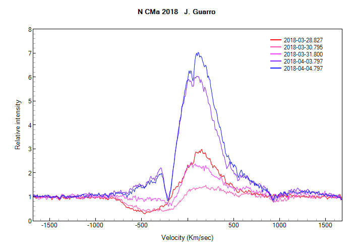

- Posts: 728
Re: Nova in Canis Major - N CMa 2018 = TCP J07134590-2112330

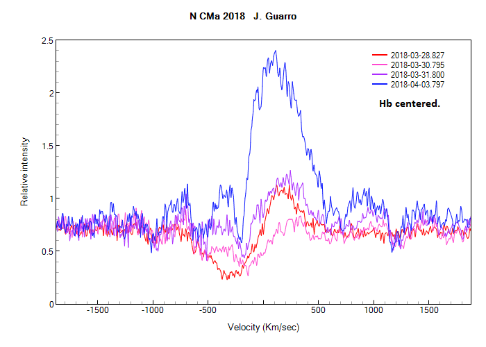

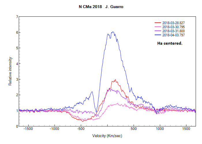

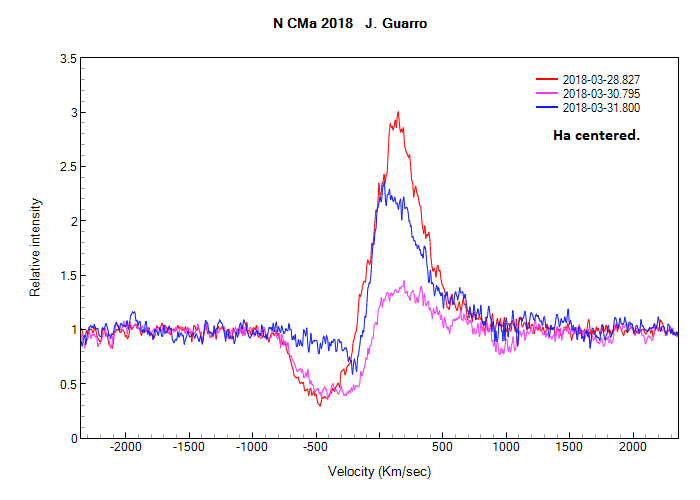

The star is making its evolution. The last night, in blue, shows the Hydrogen again in ascent.
The last graphic is the sum of the results of the two telescopes. The signal is weak, but I think it's enough to give a very schematic idea of its evolution.
Friendly, Joan
Friendly, Joan
- _ncma2018_20180328_827_J. GuarroFULL.png (72.49 KiB) Viewed 11888 times
- _ncma2018_20180328_827_J. GuarroHA.png (49 KiB) Viewed 11888 times
- _ncma2018_20180328_827_J. GuarroHB.png (81.02 KiB) Viewed 11888 times

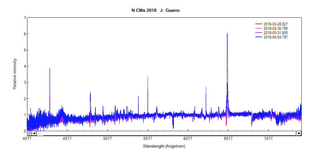

- Posts: 728
The Hydrogen emission is activated again.
Joan.
Joan.
- _ncma2018_20180328_827_J. GuarroFULL.png (58.57 KiB) Viewed 11823 times
- _ncma2018_20180328_827_J. GuarroHA.png (45.13 KiB) Viewed 11823 times
- _ncma2018_20180328_827_J. GuarroHB.png (70.98 KiB) Viewed 11823 times

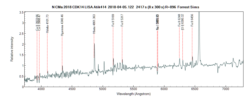

Forrest Sims
- Posts: 86
I acquired fresh data last night on N CMa 2018 in a very narrow window of no clouds at the time just after dusk when this target is available to me. I used HD041692 as the Reference star. As Joan points out there are changes going on in the spectrum. The identification lines are just proposals but they look significantly different from the data I acquired on 29180329_129. I do not know what the two emission lines might be between Hbeta and the FeII 5169 line. I will check again for hot pixels, just in case.
Cheers!
Woody
Cheers!
Woody
- ncma2018_20180405_122_Forrest Sims annotated.png (38.92 KiB) Viewed 11790 times
- Posts: 1565
Excellent, Woody and Joan!
This is Fe II (42) multiplet : 4922 & 5018 (the third one is 5169)

This is the summary of last nights. Yesterday cloudy here.
Joan.

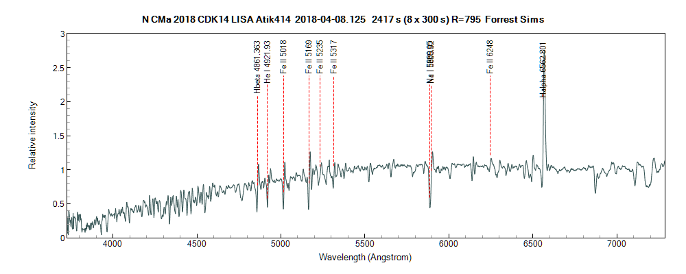

Here is my data on N CMa 2018 from last night just after dusk. I used HD041692 again for a Reference star. In just 3 nights since the last data the airmass spread has increased between this star and the target at the mid point of each image sequence. But it was still the best positioned Miles star to use as a reference. The H Balmer emission lines look to have diminished considerably since my first data on 2018-03-27.126. The Sodium Na lines are however much more pronounced.
Cheers!
Woody
Cheers!
Woody
- ncma2018_20180408_125_Forrest Sims annotated.png (38.99 KiB) Viewed 11703 times
