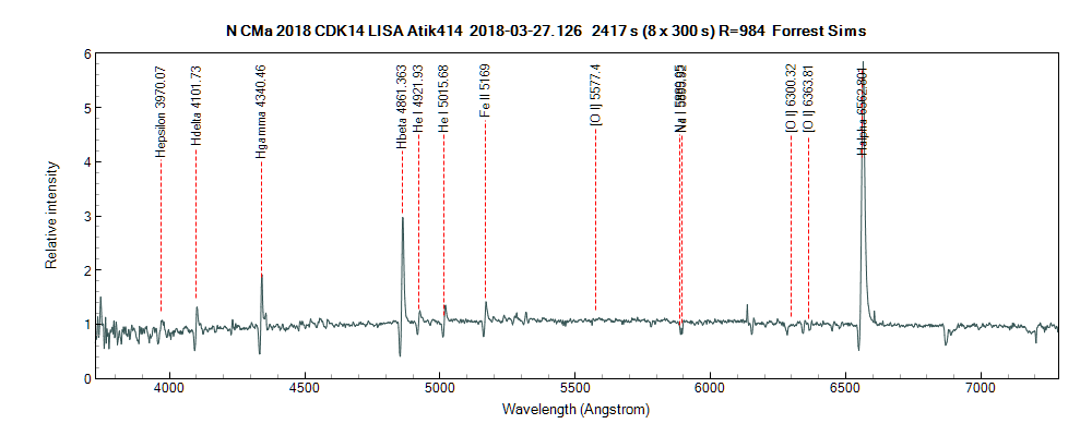

Early this morning the clouds cleared and I was able to collect data on this Nova.
http://www.astronomerstelegram.org/?read=11475
I took 8 300sec exposures of the target and used the Reference star HD031295 for determining the response correction. Putting the target on the slit without getting the nearby Mag 13.1 on the slit was tricky/lucky.
The P Cygni profiles are still very prominent on the Balmer lines. I calculate the Halpha absorption component velocity at about -1,800 km/sec.
Cheers!
Woody

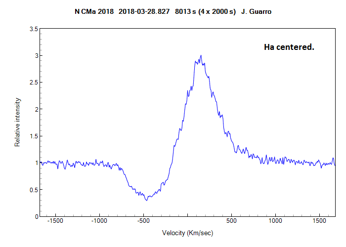

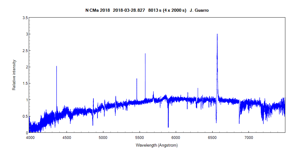

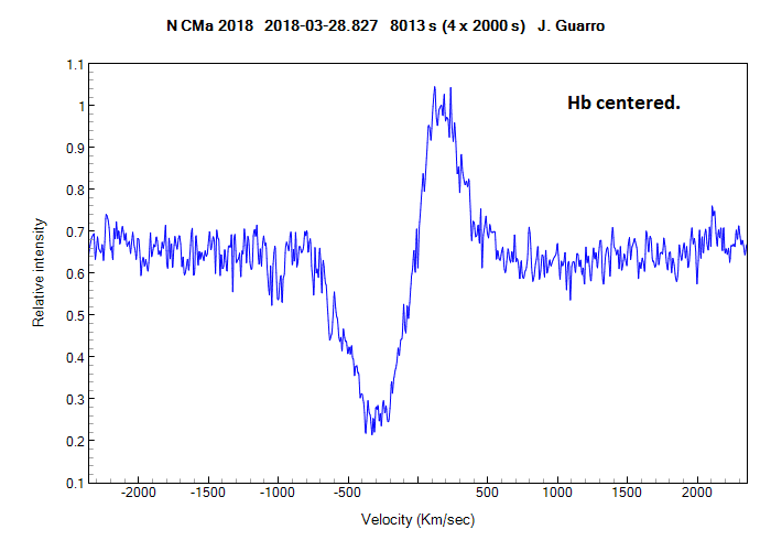

Hallo Forrest and all,
Last night I intended observe the Nova CMi 2018 with both echelle spectrographs. I showing the best results with the MUSSOL, ( Piera Observatory ).The results with the LINX are worse. The magnitude of the Nova was around 11 th.
Regards, Joan.

Posts: 1273
Re: Nova in Canis Major - N CMa 2018 = TCP J07134590-2112330
Congratulation Joan for your spectrum, I will try this night (hope to have a clear Sky not like last night...)
Posts: 1565
Congratulations for the spectra, Joan and Woody
Joan: your spectruOIm is welcome for the base
Woody: the identification of the lines is good
But [OI] is hasty
The ejecta is still thick
[OI] lines appear at about 2 mag under maximum luminosity when the ejecta turns thin
Description of the evolution of a typical nova: http://www.astrosurf.com/aras/novae/Nova2013Del.html
or : http://www.astronomie-amateur.fr/Docume ... /Novae.pdf

Forrest Sims
Posts: 86
Post by Forrest Sims »
Thank you Joan and François.
I only added the annotation for [OI] to show that even though it was listed in the Atel #11475, that it was not visible in my data. I should have been more clear:)

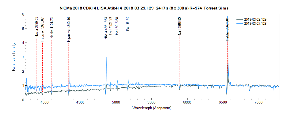

Here is more data from last night. This time I took (5) 600sec exposures. I used HD059612 as the Reference star. There are large changes in the intensities of the absorption and emission lines.
Joan, I hope your clouds go away soon!
Cheers!
Woody
