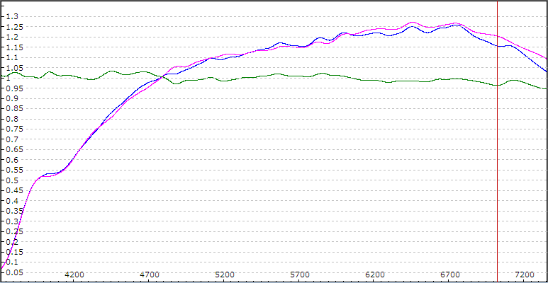

Olivier and I did some comparisons with his own measurement (see before), and the agreement is generally ok-ish although not perfect. Now no clue if that may come a change of the continuum global shape in 1-2 days time.
Simon
Hi Simon,
I suggest dividing one spectrum by the other as I did. Differences due to flux calibration errors (chromatism, focus change, extinction etc) will be a smooth curve. Real changes,for example changes in TiO absorption band depth will be obvious

Hi Robin,
As far as I understand you are comparing spectra having the same resolution, right? In our case we were just comparing the global shape of ALPY and echelle-made spectra. Beside the average resolution difference, I suspect that the resolution changes across the spectra, if not fully under control, may lead to fake peaks/dips where slopes are steepier. I mean, it would be easier to compare to ALPYs :-)
Simon
Simon

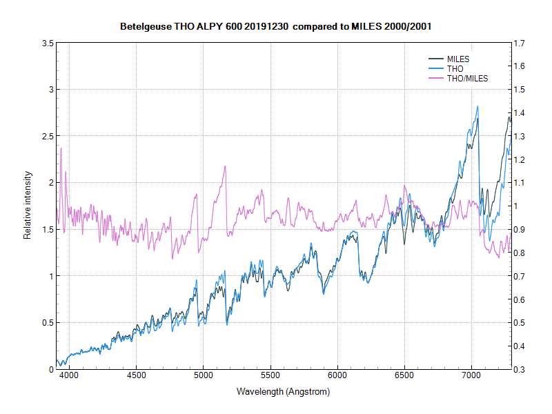

Hi Simon,
That is why I suggested comparing with my ALPY 600 spectrum from 20191230 in the BAA database. That is very accurately flux calibrated and will be a direct comparison with your spectra. I have attached it as a zipped fits file.
The comparison of my ALPY spectrum with the MILES spectrum from 2000/2001 at slightly higher resolution than the ALPY is reliable I believe and shows a decrease in effective temperature of ~200-300K from the strength of the TiO bands ( ~1.5 points from say M2 to M3.5) That is also consistent with the results from my high resolution LHIRES spectrum and with the findings reported from 20191219 in ATel #13365 when the drop in brightness was less than it is now.
http://www.astronomerstelegram.org/?read=13365
The drop in temperature is enough to explain approximately half the drop in brightness but the radius may also have reduced due to the lower temperature so that might explain the total brightness drop seen. There is no sign of dust production in the spectrum as that would be expected to produce preferential dimming in the blue. I expect the brightness drop is just an exaggerated example of the normal pulsations but it will be interesting to see how low it goes.

Re: Betelgeuse
Here are my ALPY600 spectrum from 20191230 (version with telluric bands removed) and the MILES reference spectrum, filtered to match the ALPY resolution
_betelgeuse_telrem_20191230_949_Leadbeater.zip
(29.22 KiB) Downloaded 722 times
betelgeuse.zip
(26.04 KiB) Downloaded 702 times

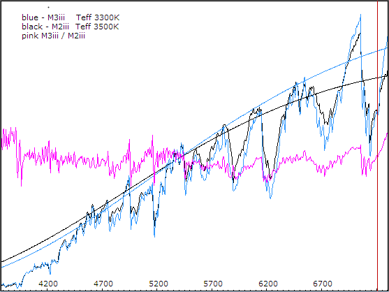

Re: Betelgeuse
Here for comparison is the change in Pickles spectra from M2iii to M3iii . Note the similarity to the change between my spectrum and the MILES spectrum from 2000/2001
http://www.spectro-aras.com/forum/downl ... hp?id=6488

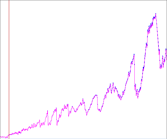

Re: Betelgeuse
Here is my stitched spectra data of a ORI from my Alpy600(Atik414ex), 01Jan20 & LISA-IR(Atik460ex) on 06Jan20:
I see a couple of dips in the IR CaII bands. I've been dodging the storms here in SoCalif, so my spectra have much
more H2O vapors than when I shoot from hifgh and dry Mt. Pinos, CA.

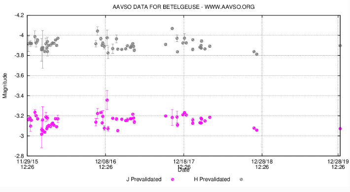

Re: Betelgeuse
It is interesting to see that far into the IR. There have just been a pair of H,J magnitude values added to the AAVSO database (The first for over a year)
It shows that Betelgeuse is not fading in those IR bands where Betelgeuse is much brighter
