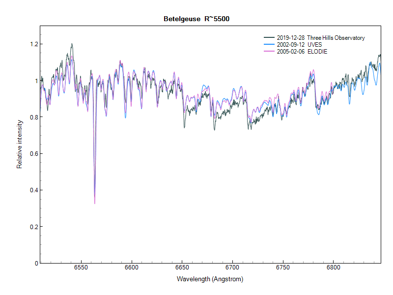

Re: Betelgeuse
While waiting for the skies to clear properly to continue with the TESS Be star and X Per campaigns , I took a quick medium resolution (R~5500 spectrum of Betelgeuse covering ~6500-6850A. To put the region into context here is the spectrum overlaid on the MILES library spectrum of Betelgeuse
and here is the spectrum overlaid on spectra from UVES and ELODIE taken at times when the brightness was more typical, around 0.6 Visual
There are no dramatic differences but the underlying "pseudo continuum" dips more in my spectrum indicating perhaps an ~10% increase in depth of the dominating TiO band in this region. A carefully flux calibrated lower resolution full range spectrum would likely show this more clearly however.

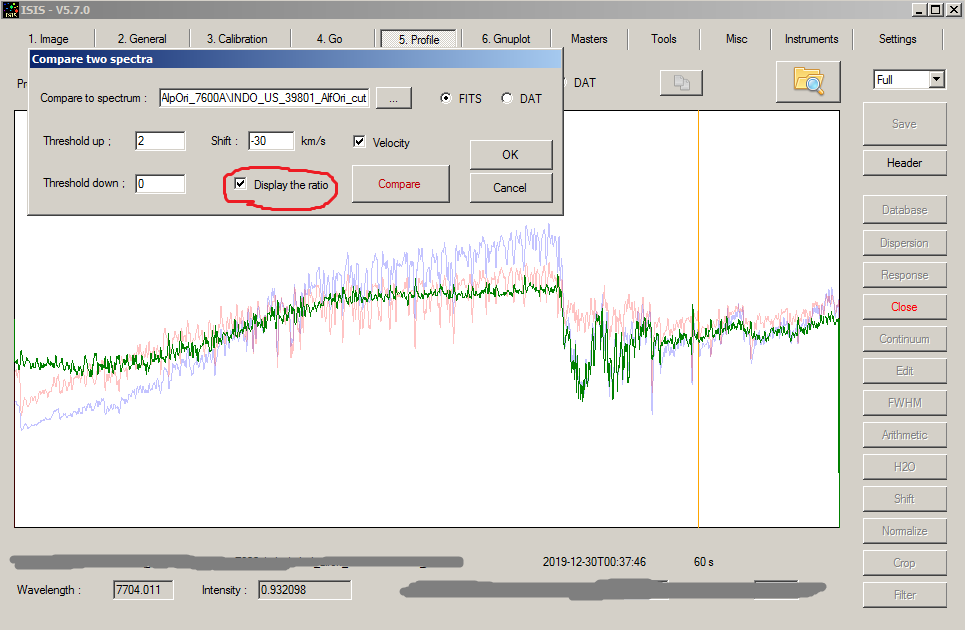

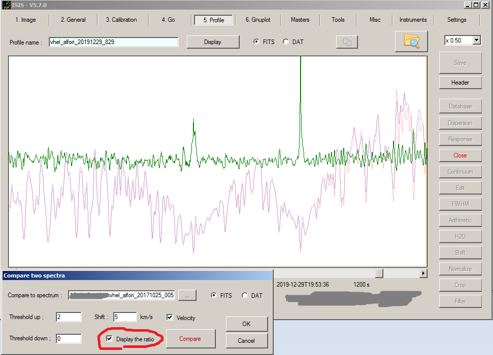

Fresh result from yesterday, scanned near-UV and NIR ranges, allowing comparative exploration:
1. 3870-4010A (CaII region):
R~5300A, LHires III 2400/mm, 35 micron slit 1 x 20 min (more than enough signal), bin2x2, luckily had an earlier own spectrum in 2017: The 2 CaII components (3933A, 3967A) have higher EWs.
Continuous U-mag drop (see aavso) may mean that only the continuum has dropped, not the core CaII emission.
Note: James's spectrum of 2019-11-18 show similar state of the core CaII emission as mine in 2017, however can't compare the one of his 2019-12-11 due to resolution difference.
2. 8250-8950A, Ca II triplet region, R~5000 (rare setup: 15 micron slit + IR filter + 600/mm grating + bin 1x1)
Comparison against INDO-US (year 2004, https://www.noao.edu/cflib/): Whilst absorption is dominant, ratio show outstanding difference at CaII triplet.
3. 7100A-7800A (checking the often mentioned K I 7699), same setup: There is really some change at 7699, however not so outstanding (same INDO-US spectrum used).
For visual purpose, here I made a telluric removal using other hot stars (multipe ones to have a check, this reduction is not perfect in the 7605-7680 range, similarily problemmtic as more INDO-US spectra).
But I agree with Robin, most prominent change here is the higher depth of TiO band, best to observe that at low resolution + full range.
Submitting spectra to aavso is in progress. Hope to see new comparative results from others.

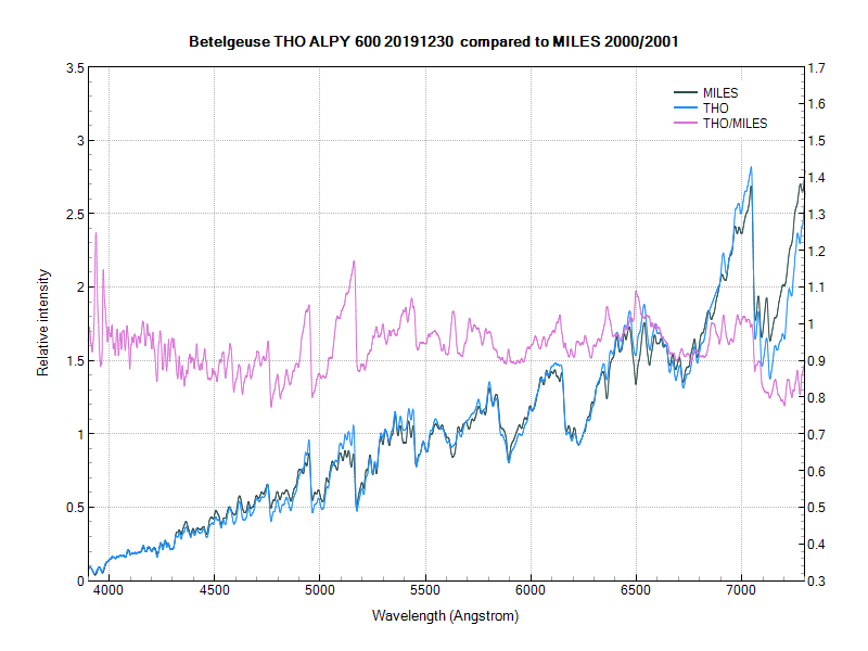

Re: Betelgeuse
Carefully flux calibrated ALPY 600 spectrum (using repeat spectra and 2 reference stars) confirms small increase in depth of molecular bands compared with MILES spectrum from 2000-2001. Spectrum added to BAA database

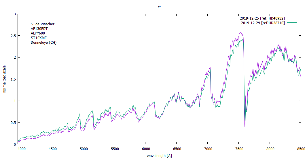

Re: Betelgeuse
Here are some first results I had with the ALPY600+ST10xme mounted on a AP130EDT (processing with IRIS): I managed to get two spectra on Dec 25th and 29th. Just be careful with my results, these are the first "serious" ones I manage to get with the Alpy, so it might very well be that some things are still not under control (most probably on the processing side).
As we can see these are not identical. Unless someone has a spectrum taken at the same time I can only speculate about the most probable systematic uncertainties:
a) The ref star used on Dec 25th is Mu Ori, which is...a variable star (good shot...)
b) the weather conditions was varying quite fast on Dec 29th (fast varying fog/humidity), so it might be that the the atmospheric transparency varied between the ref and betelgeuse measurements.
Olivier and I did some comparisons with his own measurement (see before), and the agreement is generally ok-ish although not perfect. Now no clue if that may come a change of the continuum global shape in 1-2 days time.
Simon

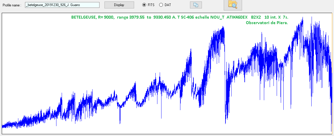

- Posts: 731
Re: Betelgeuse
Whee have I to send this spectra, please ?
Joan.
Joan.

Simon:
Trés correct.
Toujours utiliser la même étoile de référence, comme tu le notes dans ton message.
Et des durées d'exposition sufisamment longues pour éviter les effets de bords sur la fente (minimum 30 secondes). Pas facile avec un objet brillant ... Raison pour laquelle Véga est une trés mauvaise étoile de référence avec un Alpy ou un LISA.
