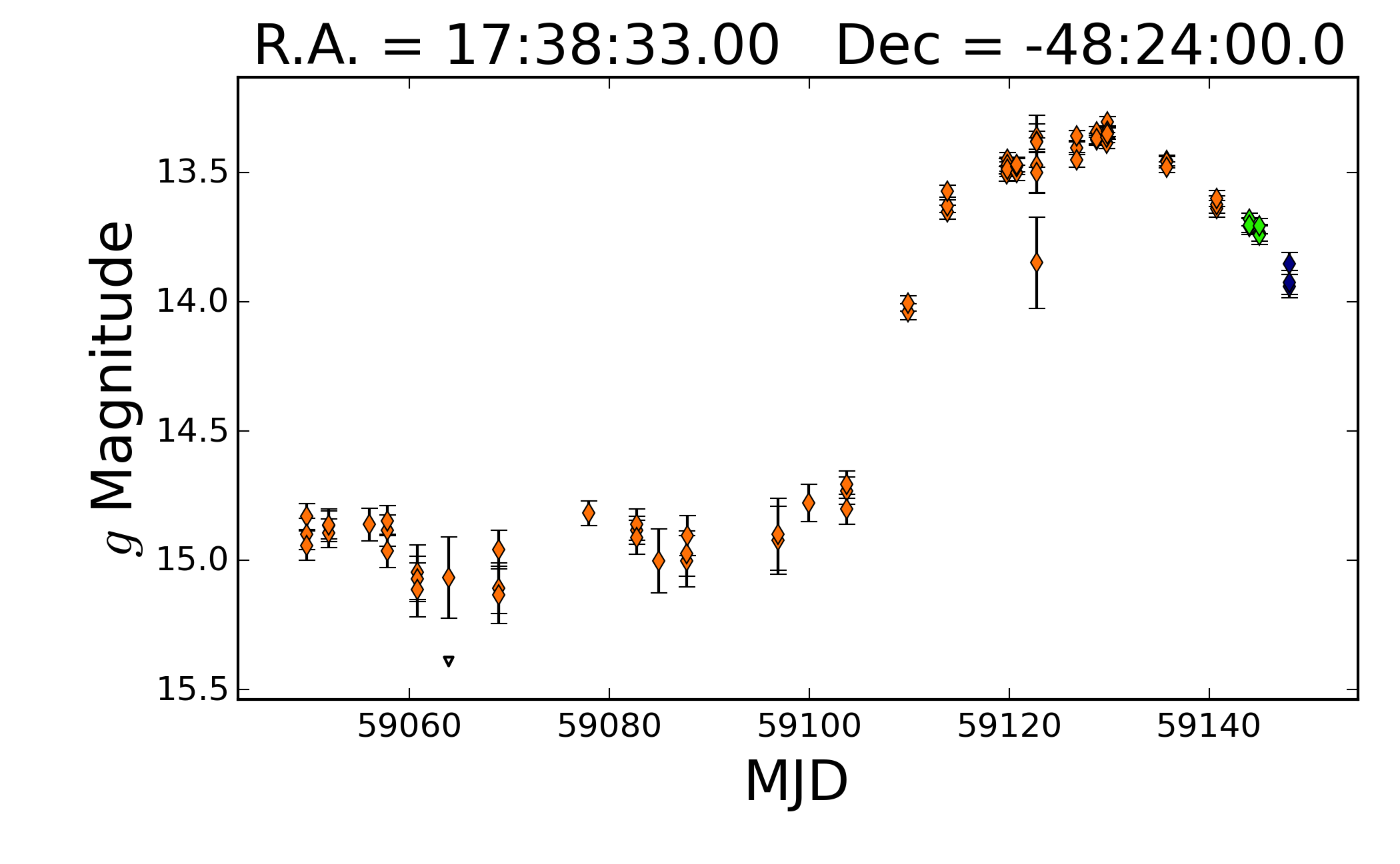

Brightness is declining. Raining here today so no chance of an observation.
Latest asas-sn light curve included above. If it is a nova then I guess emission lines should get more obvious.

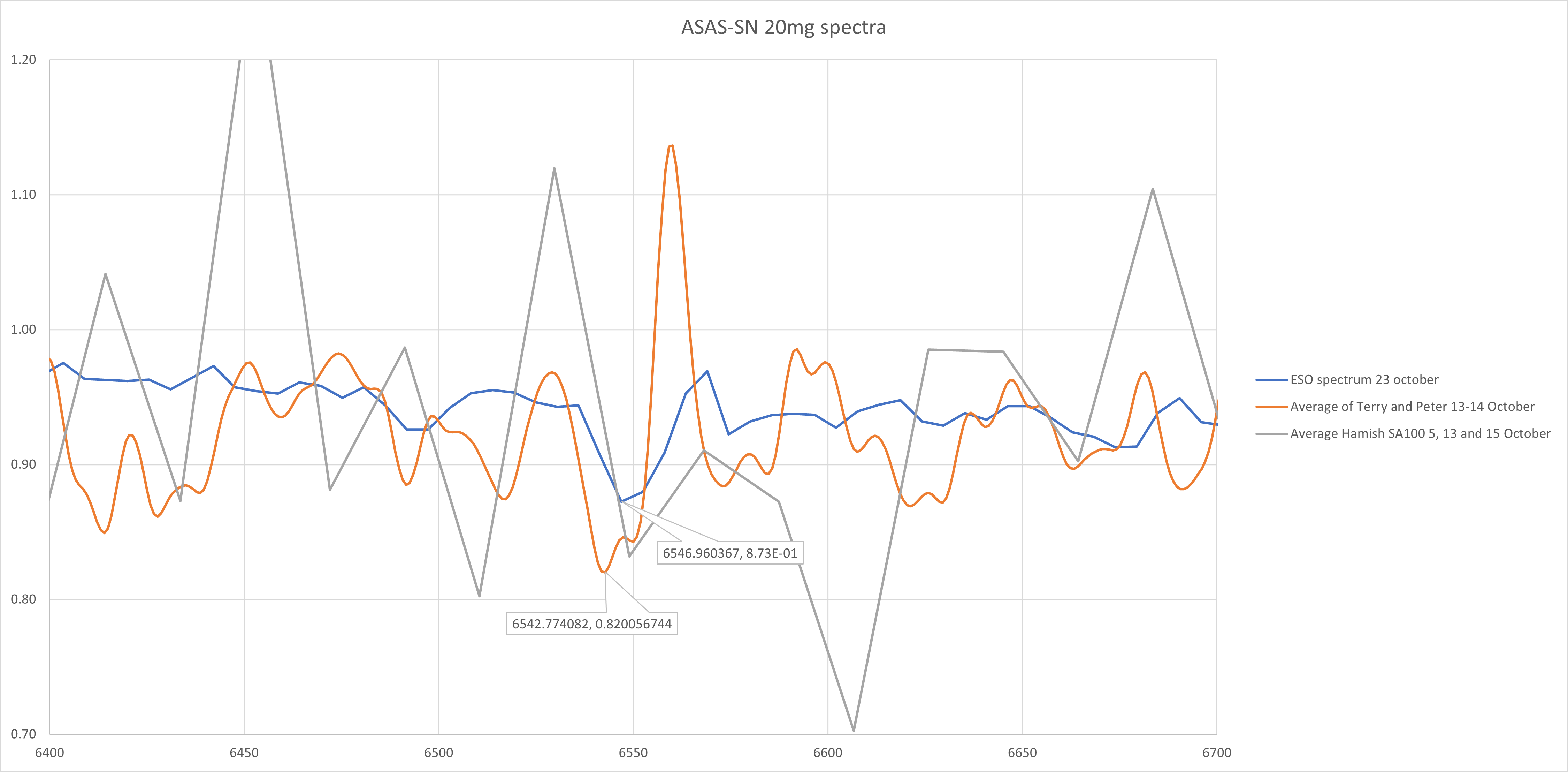

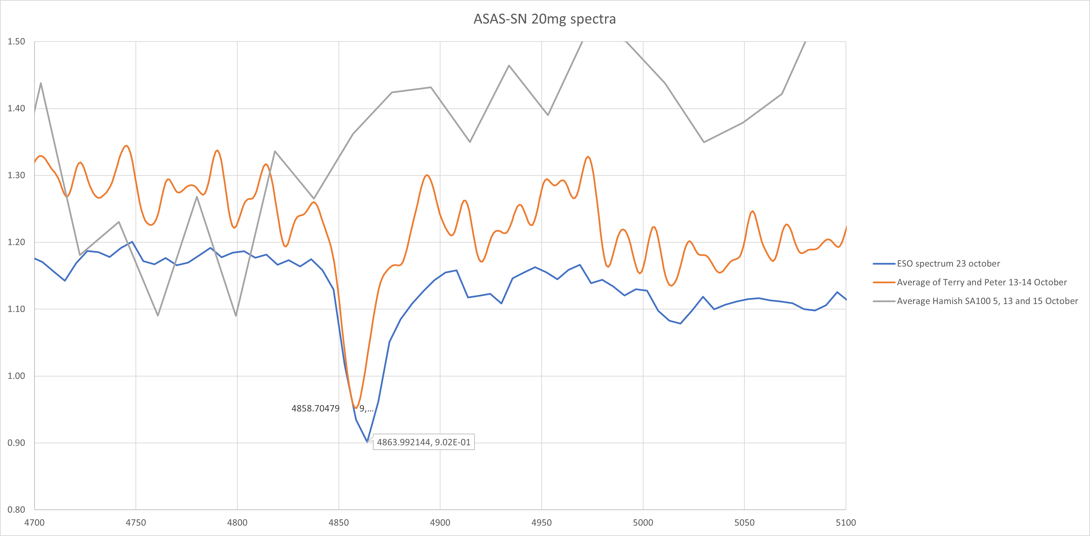

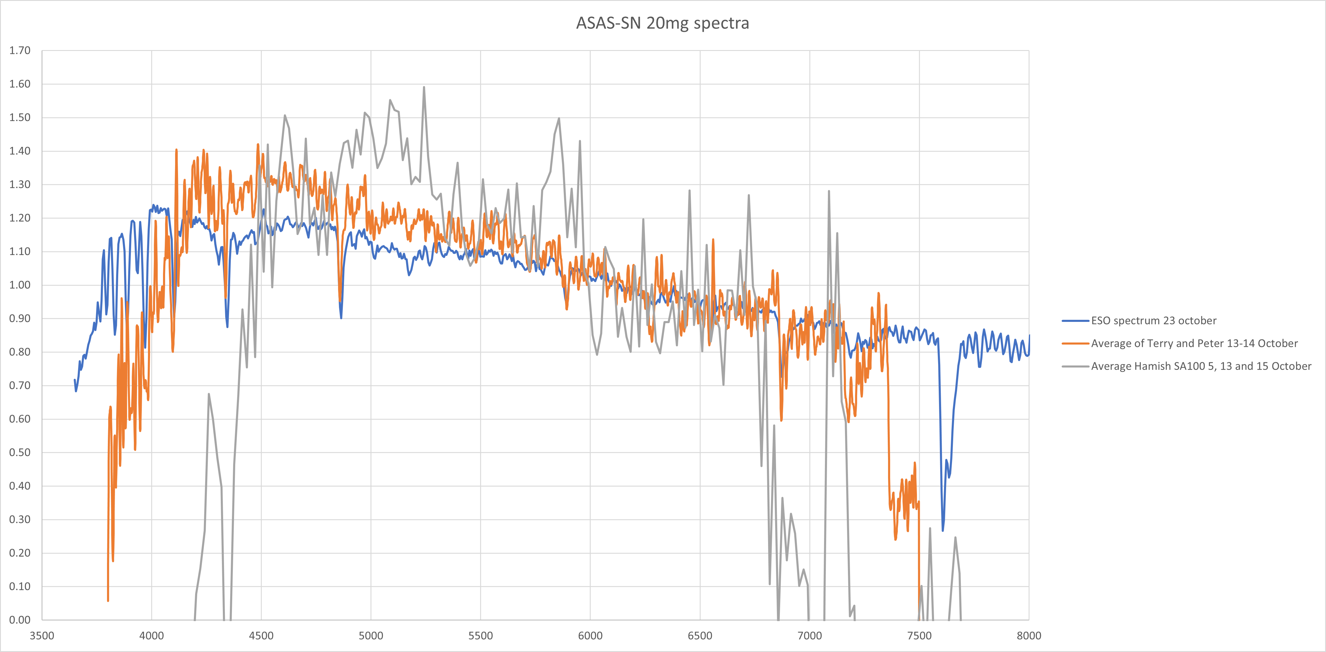

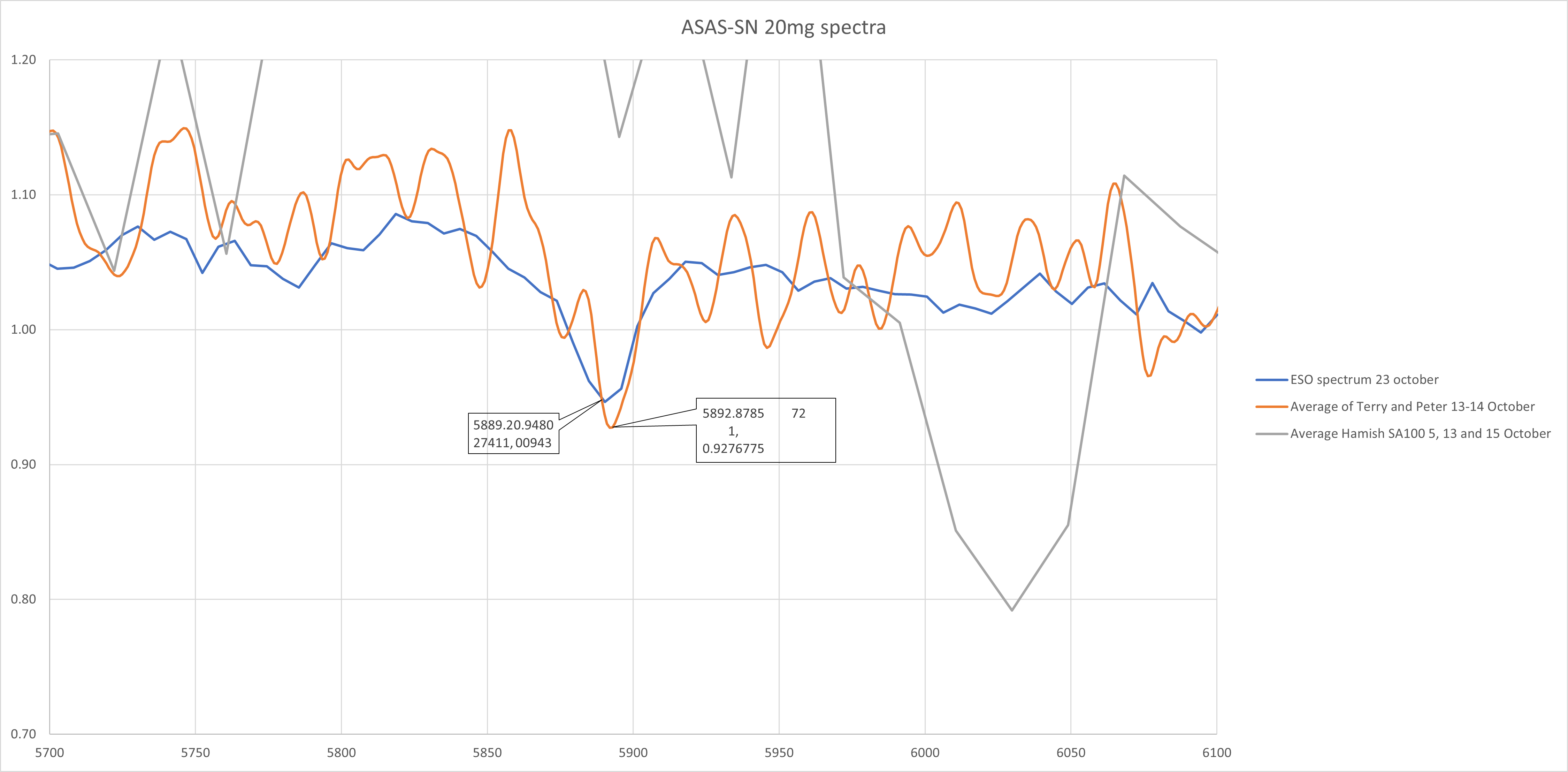

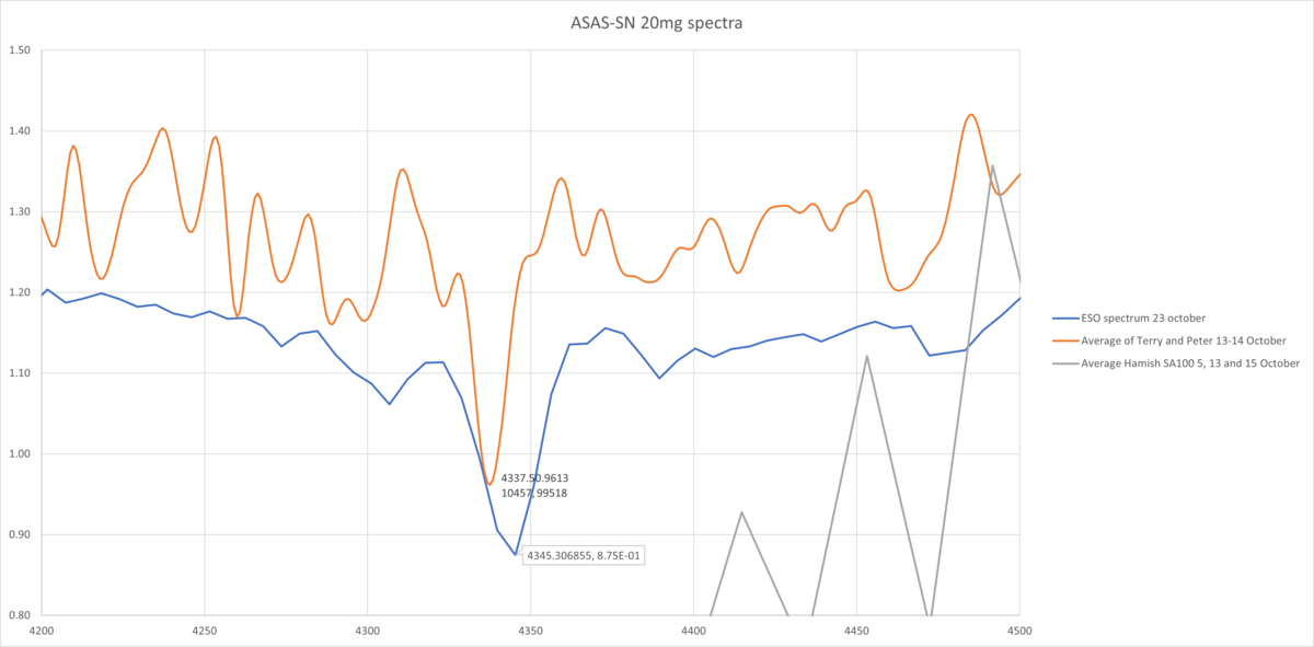

I combined Terry and Peter's spectra (note observations were different by a day) to reduce the noise a bit and overlaid the ESO spectrum from 23 October and my crappy SA100 .
I prepared an overall, and zooms on Halpha, beta, gamma and (maybe) sodium D regions.
anyone with CV expertise? Are they normally hotter than the apparent continuum slope seems to indicate in Terry and Peter's observations of around 6000K?
Hamish
