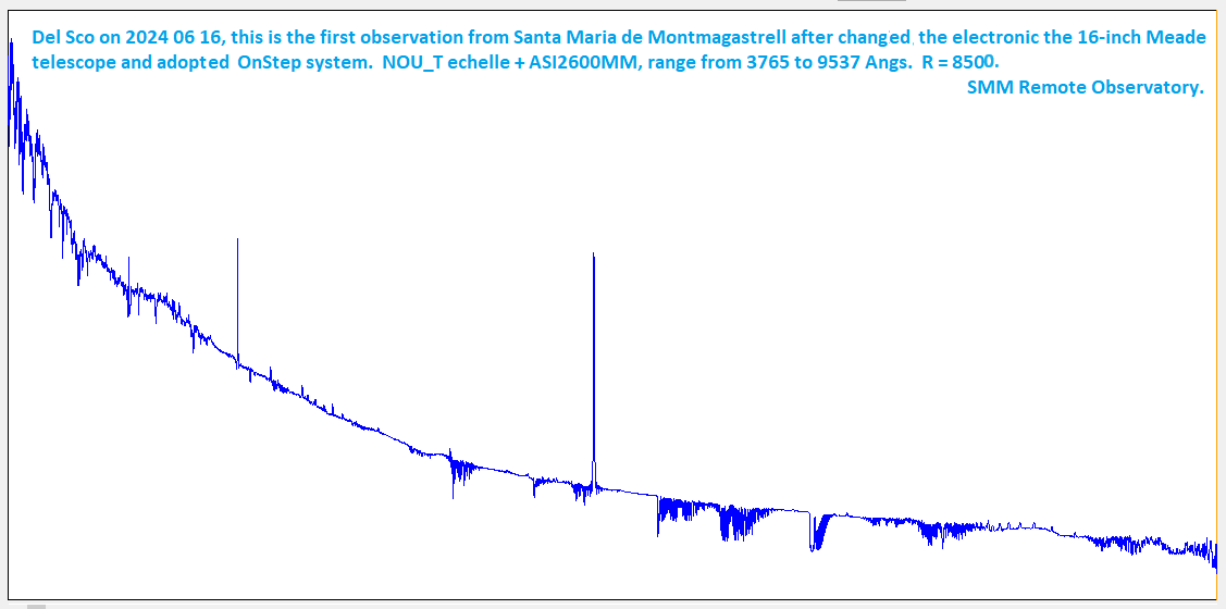

Last night, Toni and I were making the last tune-up in the sky with the 16-inch OnStep ( Meade LX200 ?) telescope, we made a 9 stars alignment, new features maximum error go to precision 30" arc minutes on next stars tours Mizar to Denebola, Denebola to Alphecca, Alphecca to Vega, Vega to Arcturus, Arcturus to Spica, Spica to Antares, Antares to Alkaid and Alkaid to Dened.
All without backlash, of course.
We also tested the SMM equipment by taking a Del Sco spectrum, you can see it below.
Many thanks to Howard Dutton not only for making the Onstep but for your daily work expanding and improving it !!

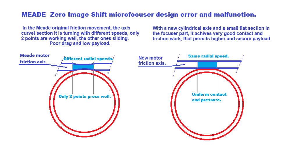

In addition, Toni Jové found a factory and design defect in the Meade Zero Image Shift Electronic Micro-Focuser, that does work it wrong with bad consequences during the observation time.
You can see in this sketch, the problem and Toni Jové solution. So if some of you have the same issue he can help you with it.
