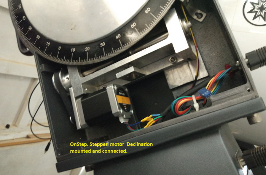

Hello at all,
SMM Remote telescope has been stopped for around three months.
The Meade 16-inch LX200 GPS mount suffered an unfortunate incident when it was observing, as a result, my colleague Antoni Jové and I were been trying to mend and change its damaged electronic cards without success, mainly, due to Meade being deaf, I want to see that Meade doesn't have spare pieces either electronic cards around the world, so it seems that this trade mark has forgotten and abandoned their old clients.
I'm not complaining about it because it's useless, I just explained it as an introduction.
The solution to this problem comes from Antoni Jové, who has enough knowledge about mechanics, electronics, software, and computing management.

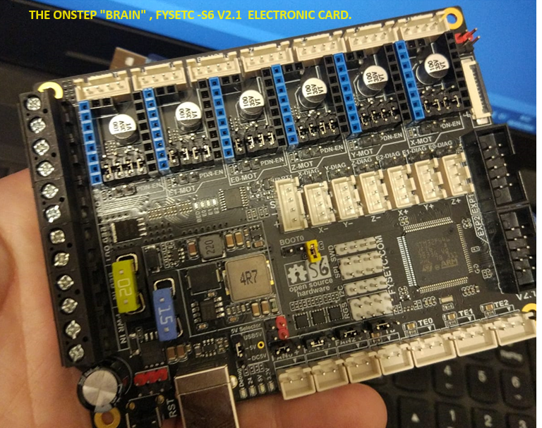

Finding a solution on the internet, we chose the OnStep system by Howard Dutton as the best way to get ready again for the SMM 16" Telescope and its NOU_T echelle.
I would tell you with the aim that if some have damaged some Meade mount or another one, you have a good and cheaper opportunity, not only about mending it if not improving it too.
In this way, from time to time, I'll tell you and show pictures of how it's doing, you can see the first ones.
Cheers, Joan.

- N 001.png (1.22 MiB) Viewed 33976 times
- N 002.png (684.76 KiB) Viewed 33976 times
- N 003.png (955.72 KiB) Viewed 33976 times

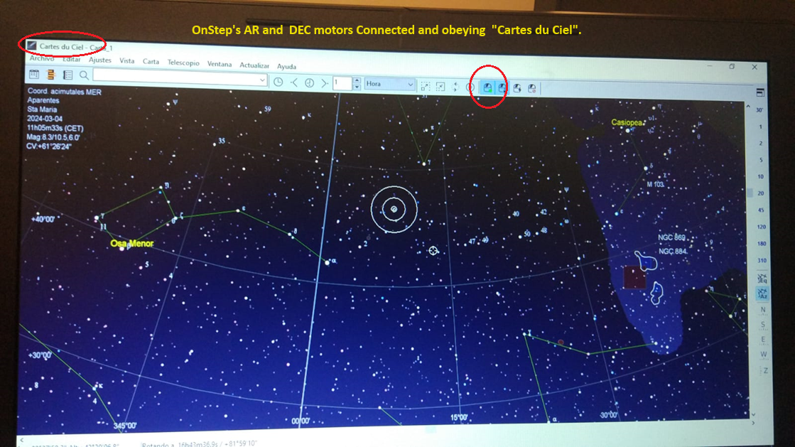

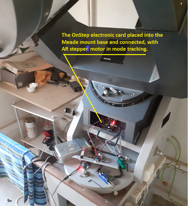

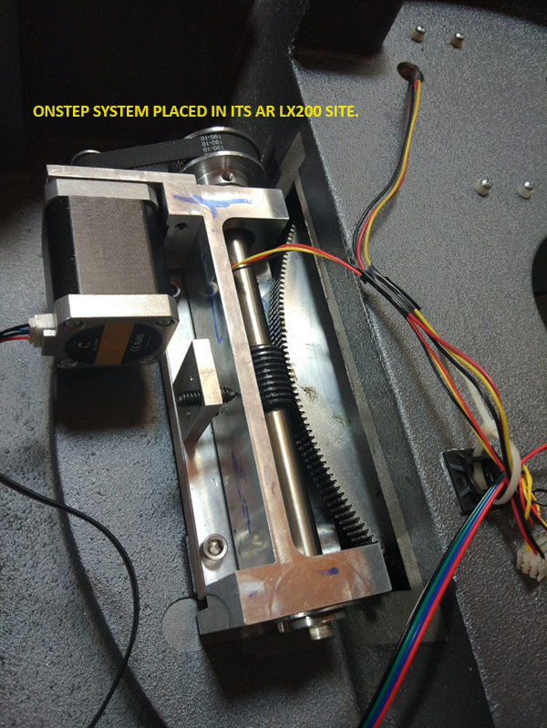

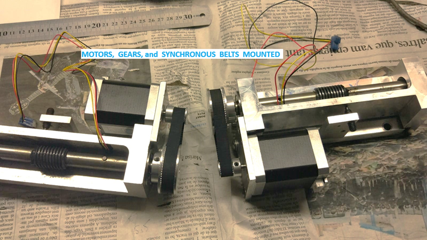

New tests and advancements.
J. Guarro.
J. Guarro.
- N 004.png (1.51 MiB) Viewed 33959 times
- N 005.png (1.24 MiB) Viewed 33959 times
- N 006.png (945.29 KiB) Viewed 33959 times

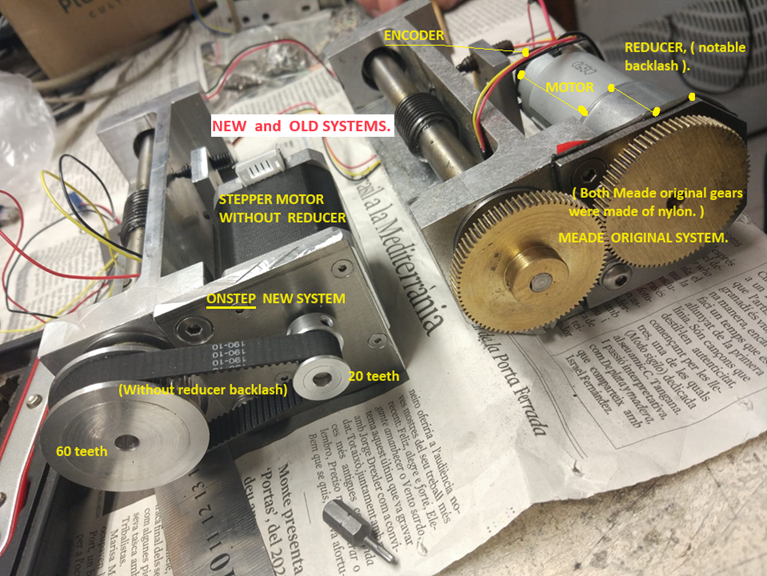

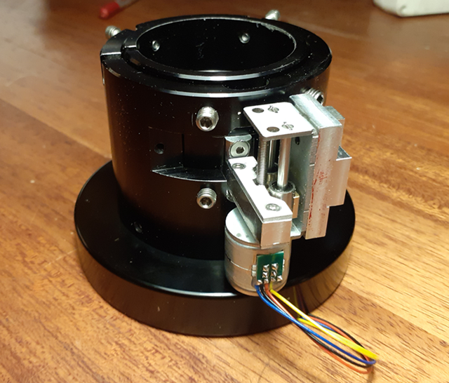

Theoretically, OnStep permits the use of normal motors DC for focusers, but sure that this application hasn't been tested yet, they don't work.
We've stopped working and waiting now for a suitable stepper motor from China, and when it arrives we intend to mend this lack.
Now it's only a matter of time before the SMM telescope will be ready again.
Regards, J.Guarro.
Regards, J.Guarro.

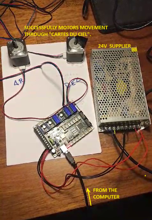

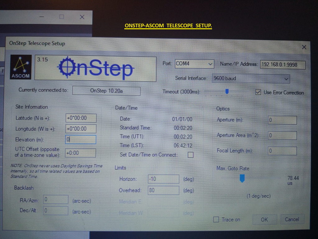

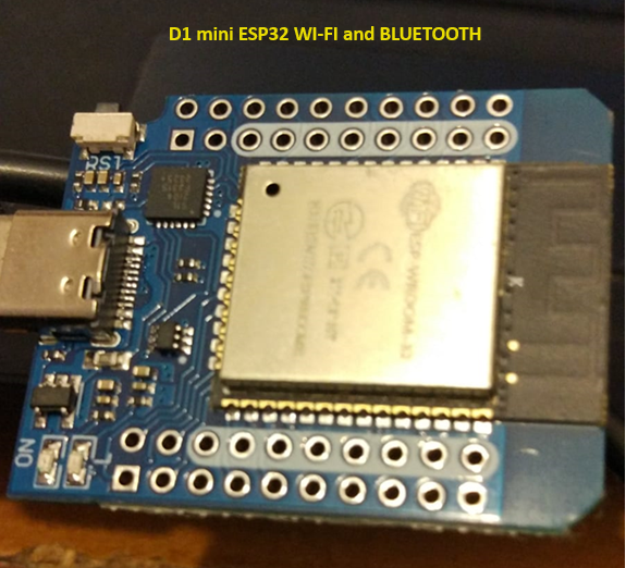

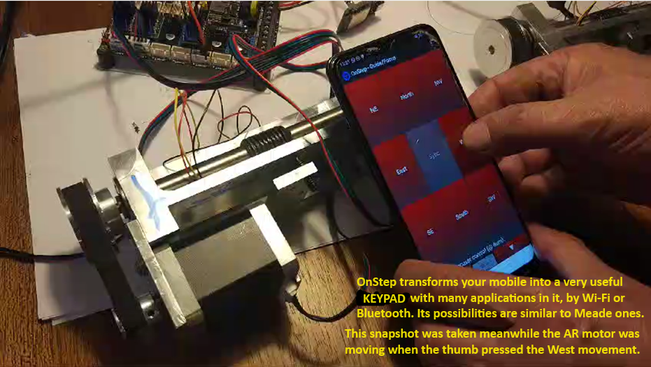

The OnStep test made with all its elements mounted in the 16-Inch Meade LX200 telescope was a success from the first moment.
The AR and Dec stepper motors worked very well moving and tracking the telescope
without any problems and with a very nice sound, which is a signal of good work.
The connection computer/telescope was wireless by wi-fi, also the fantastic and virtual keypad on the mobile phone.
All of that wouldn't have been possible without the hard, long and brilliant Toni's software work.
Every mount needs one minimum of powerful electrical and electronic supply that come determined by the electronic card and its drivers and stepper motors Amperage. So for the 16-Inch Meade mount OnStep requires its own.
On the other hand we're forced to change the 12V DC focuser motor that OnStep doesn't recognize, but we're going to take advantage of it
improving its focusing movement.
Next steps until the SMM telescope will be ready for observing will be easy, and only is a matter of time. I'll tell you about them next time.
Regards, J.Guarro.

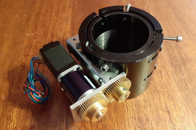

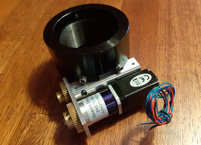

I attached here a photo that shows part of the job that Toni and I did to update the Meade 1209 focuser
to join one stepper motor that OnStep requires.
At the same time, we prolonged the draw tube travel by 2.5mm., so it's 14.5mm. now.
After a lot of hours of work, we tested it with no better results, the motor was unpowerful.

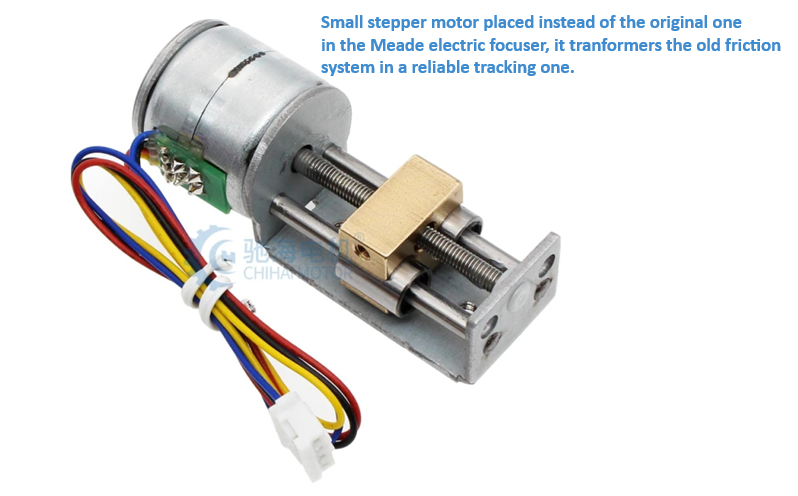

To find a solution we're going to apply this system that we have found on the Internet,
https://davidallmon.com/projects/meade- ... er-upgrade
I think that it is good to show your own mistakes too.
Regards, J. Guarro.

Hi Bernard,
You can find the teeth gears and belts easily by AliExpress on the Internet, also all theelectronic cards and drivers, de most difficult part is to program their software.
In our case, it wasn't hard to configure AR and Dec motors, only laborious, but now we'restuck trying to connect the new stepper motor in the ONstepx software, - a new ONstep version.
Our plan B is to connect this stepper motor by ARDUINO, out of ONStepx program.
You and all can see the last modification in the Meade focuser with an 8HS15-0604S-PG64 stepper motor.
Things are going more slowly than I wanted to, I hope that in a few weeks, I can show you the operating results.
Let me know if I can help you with something more.
Cheers, Joan.
Cheers, Joan.

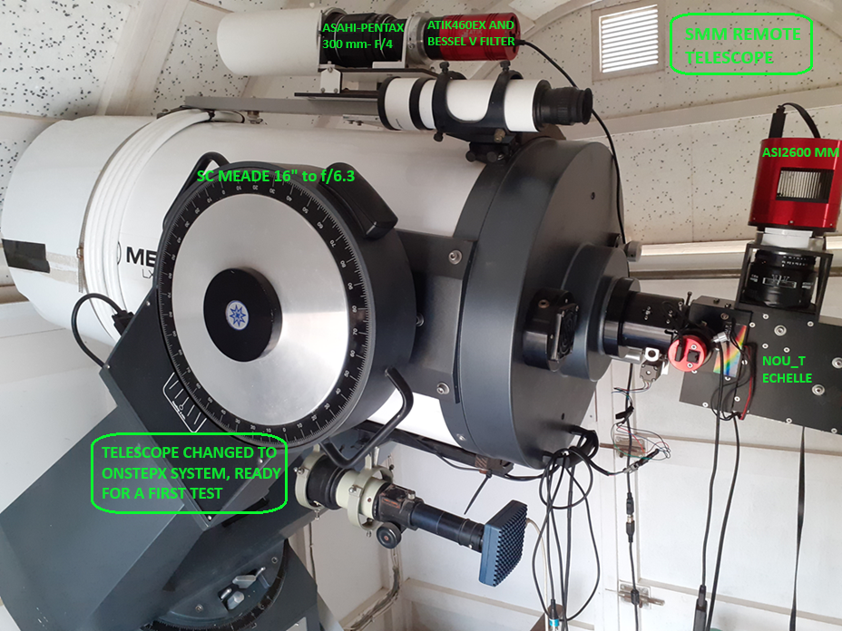

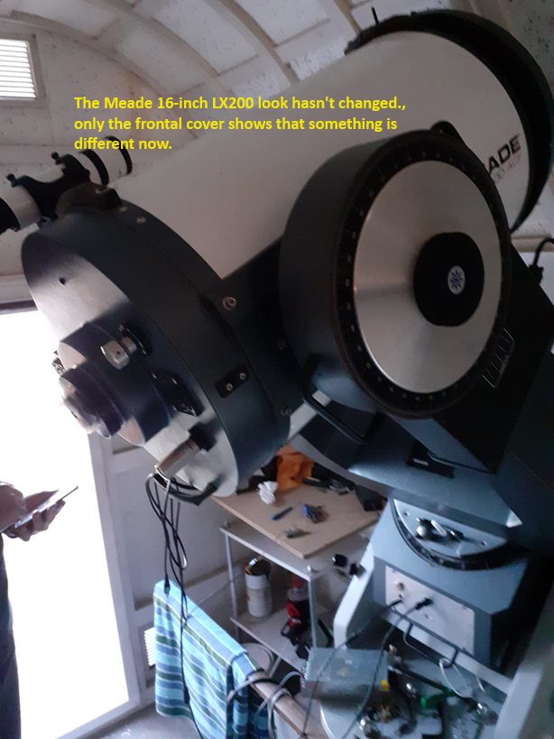

After solving some mechanical and software issues Toni successfully finished the installation of the OnSetpx System, it wants to see its mechanics and electronic work very well. As you can suppose, he spent a lot of time on it, overall it is his first one.
The second Toni's repair was easier, he transformed another SC MEADE telescope to OnStepx, meanwhile, we were waiting for the SMM telescope components.
You can see in the picture the SC16" OnStepx telescope in its shelter, ready for the first test in the sky, although today is raining in SMM.
Cheers, Joan.
