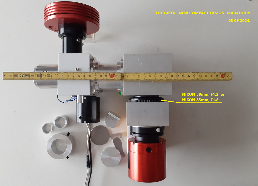

Re: POLARIMETER DEVICE PROJECT
That is more compact now.
JG.
JG.
- THEGIVER 3.png (817.57 KiB) Viewed 103673 times

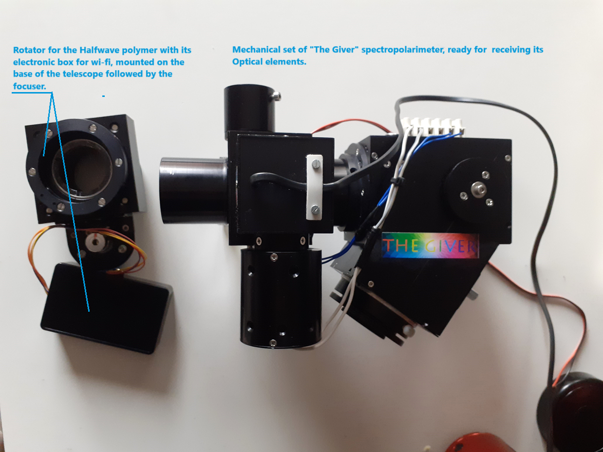

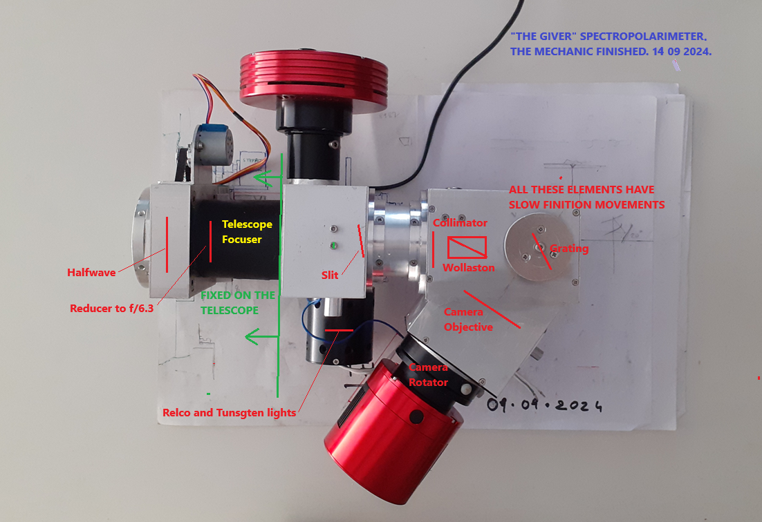

- Posts: 731
Hello at all,
This is the mechanical part almost finished, next step is anodizing these pieces, and finding the optical elements.
Cheers, Joan.
Cheers, Joan.
- THE GIVER MEC FINISH.png (928.18 KiB) Viewed 103471 times

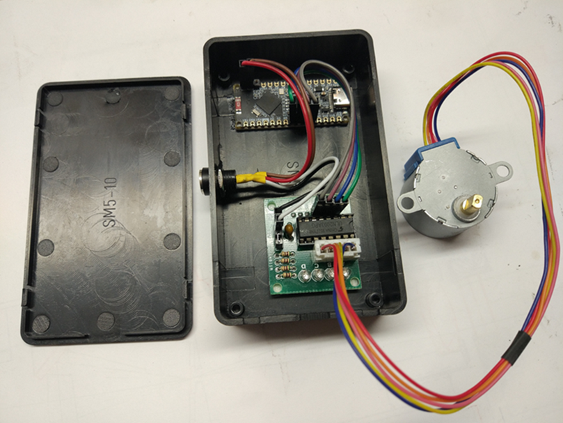

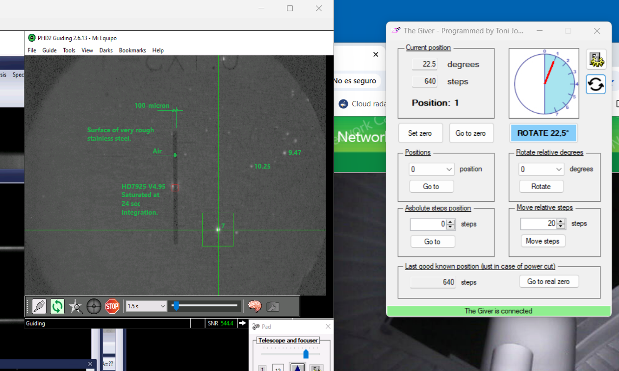

- Posts: 731

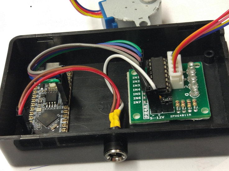

Meanwhile, I'm waiting for the last optical components, Toni has made an electronic set for moving the stepper half-wave retarder motor, all tested with Toni's software, which contains 22.5º pitch movements and position resets.
Its supply is 12V and is connected to the computer by wi-fi.
Cheers, Joan
Cheers, Joan
- ELECTRONICA 1.png (663.18 KiB) Viewed 103213 times
- ELECTRONICA 2.png (778.86 KiB) Viewed 103213 times

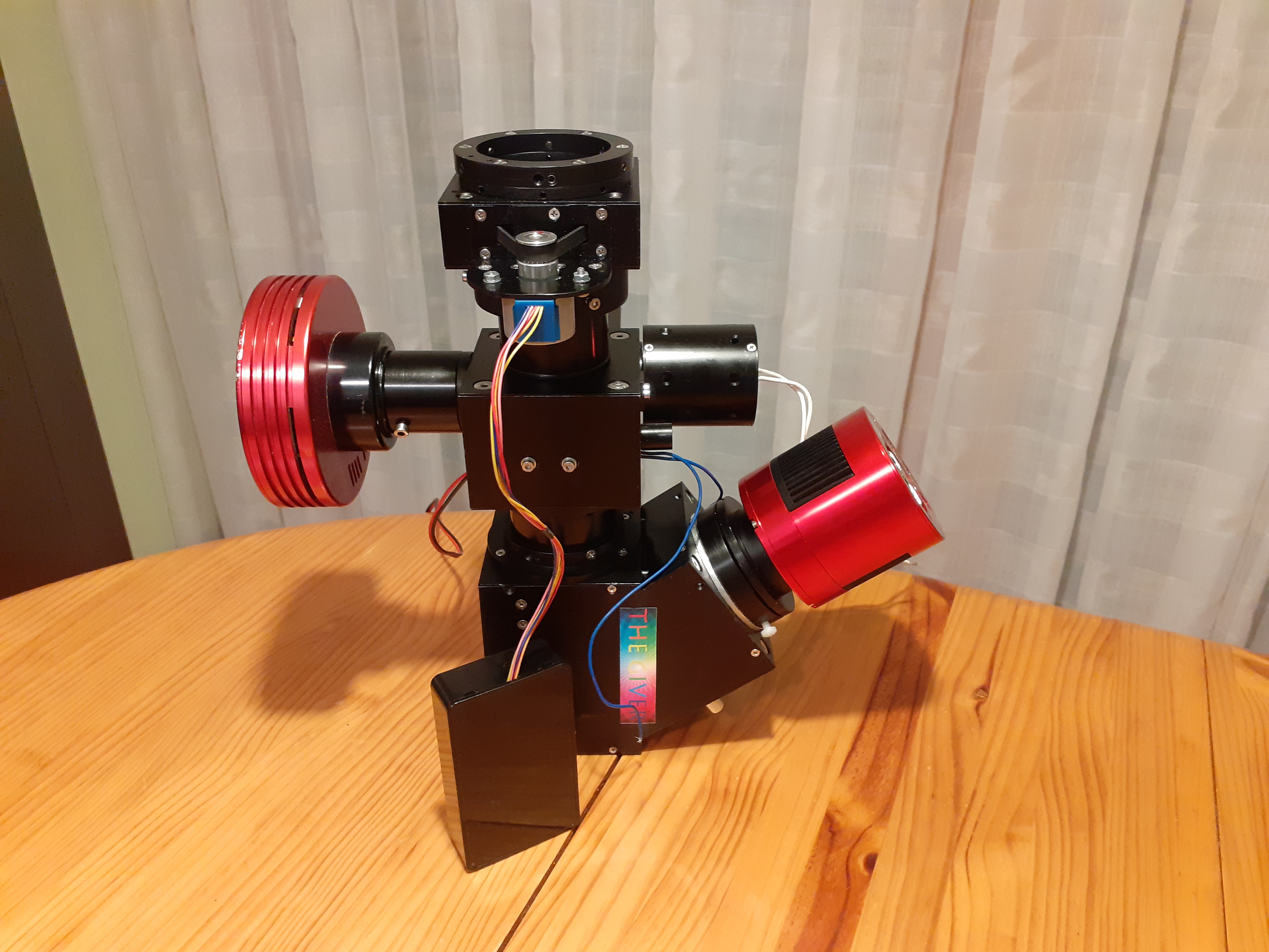

- Posts: 731
You can see these pictures of The Giver, the low-resolution spectropolarimeter, it's ready to mount its optical components. At the moment it's only a set of aluminum pieces.
Cheers, Joan.
Cheers, Joan.

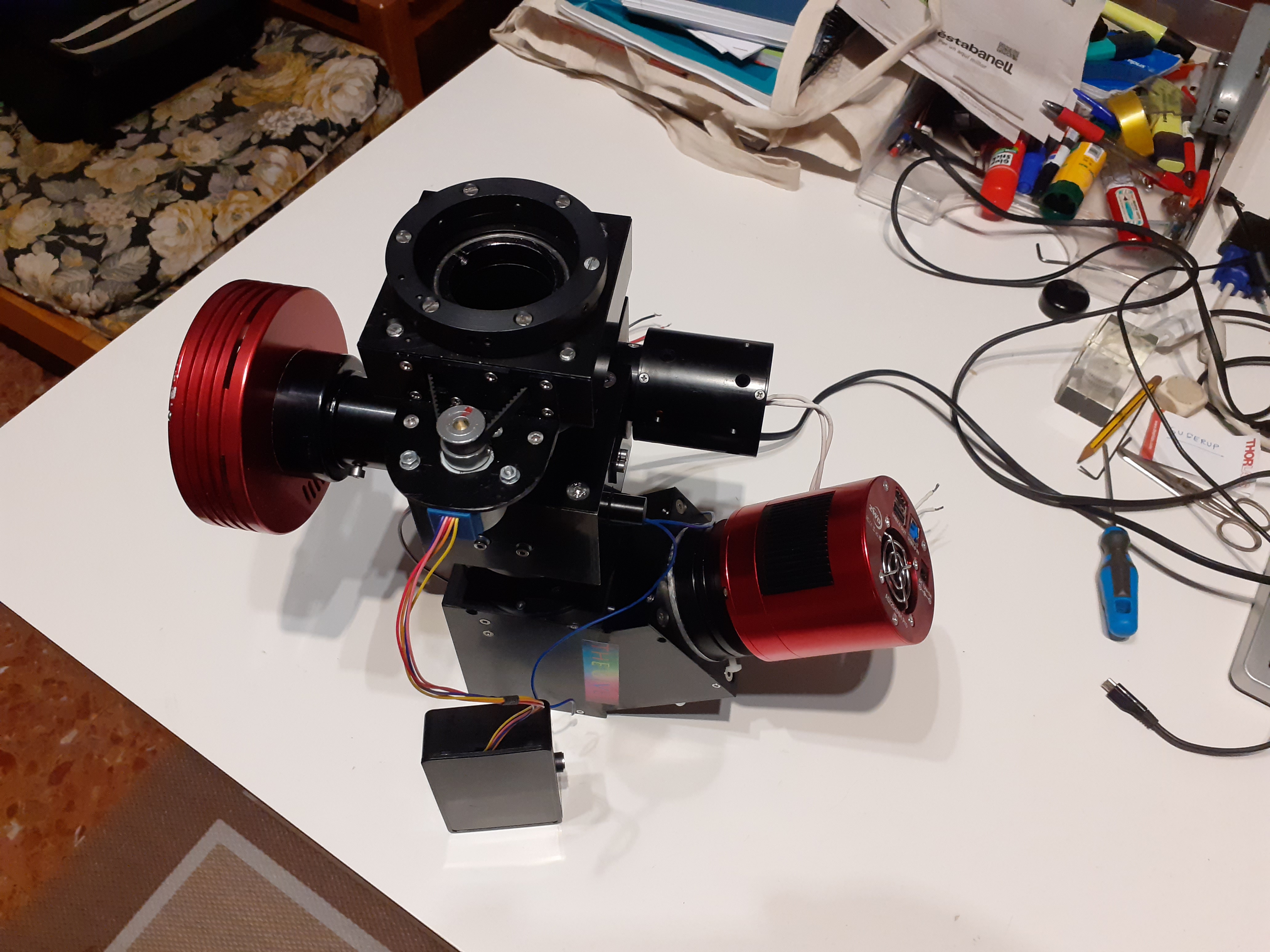

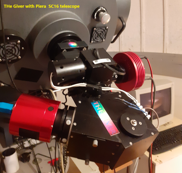

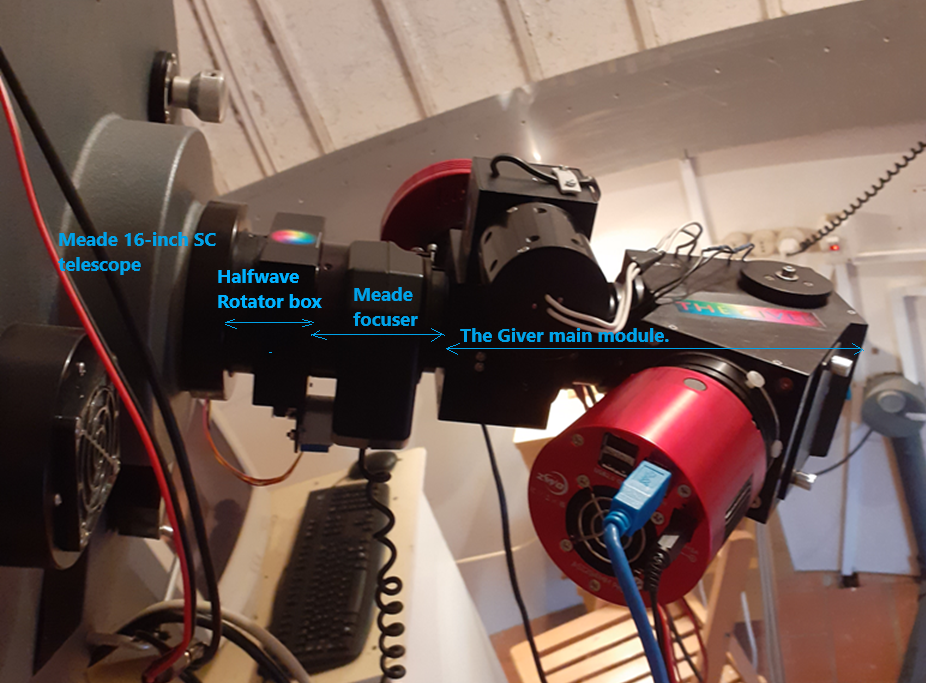

- Posts: 731
Slowly, The Giver spectropolarimeter is going, it's placed on the telescope for its first partial test, still lacks a lot of work to adjust it.
I'm very excited about this instrument's possibilities.
Every idea and suggestion will be welcome.
Cheers, Joan.
Cheers, Joan.

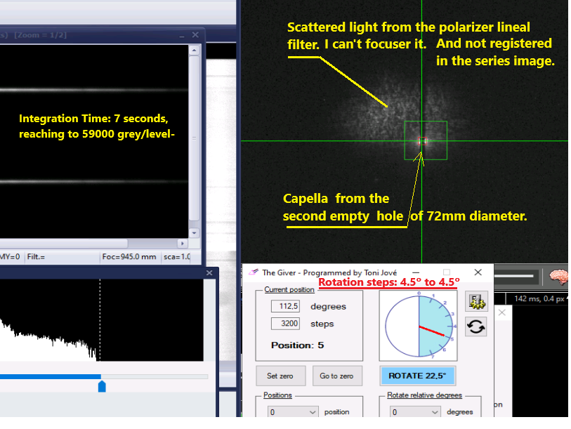

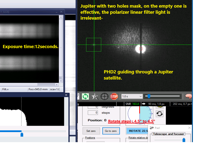

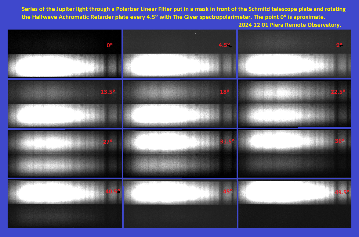

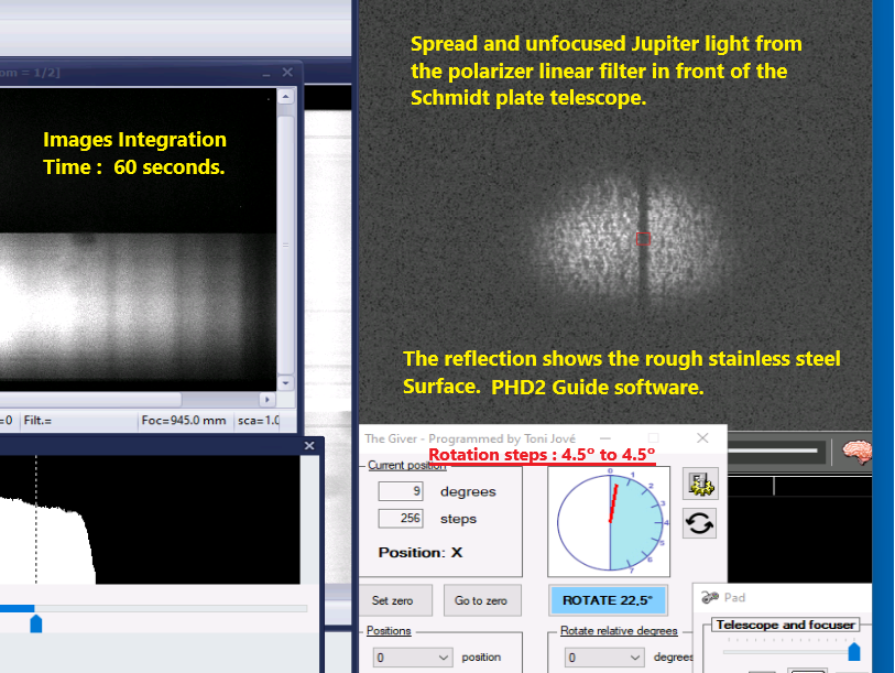

- Posts: 731
The Giver project is near to be a reality.
J.G.
J.G.
- CAPELLA 2 HOLES.png (318.44 KiB) Viewed 102082 times
- JUPITER 2 HOLES.png (366.91 KiB) Viewed 102082 times
- JUPITER 1 HOLE.png (485.92 KiB) Viewed 102082 times
- JUPITER SERIES.png (651.87 KiB) Viewed 102082 times

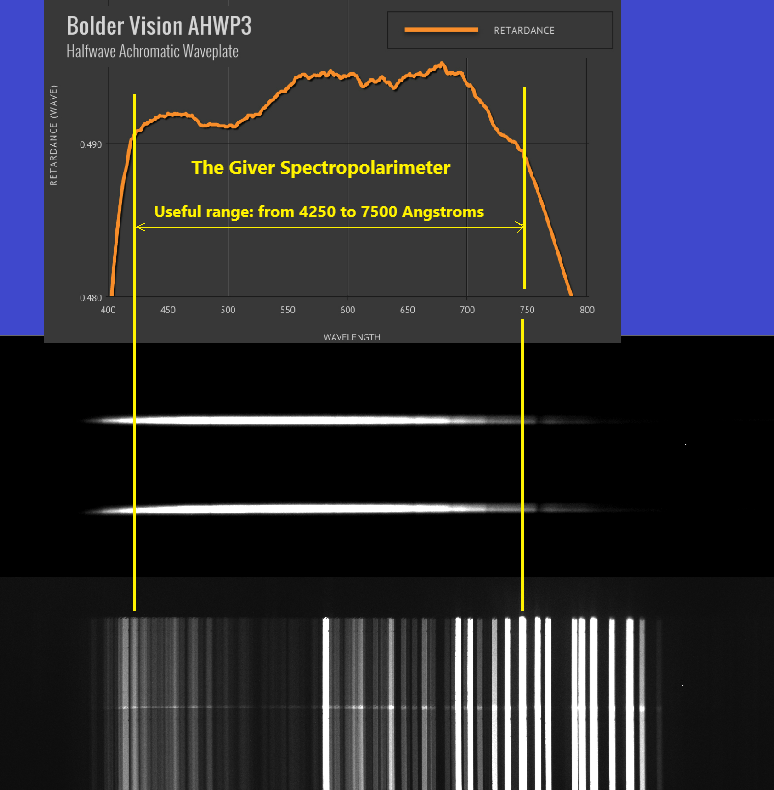

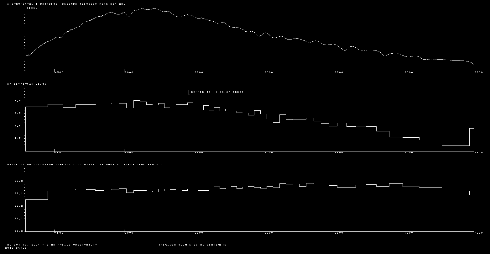

- Posts: 731
Seconds Gary Cole found making a test with a HD204827 star observation, The Giver works well.
You can see the results here.
Cheers, Joan.
Cheers, Joan.
- SPOL_Giver_TRIPLOT_0.07_8242.GIF (9.52 KiB) Viewed 101973 times
