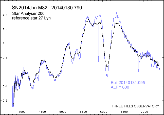

Here is my result from last night using the new SA200. I have overlaid Christian's result from the same night with the ALPY 600. The resolution is lower of course but I am pleased that the shape is the same confirming the accuracy of the background galaxy subtraction, instrument response and atmospheric extinction correction.
