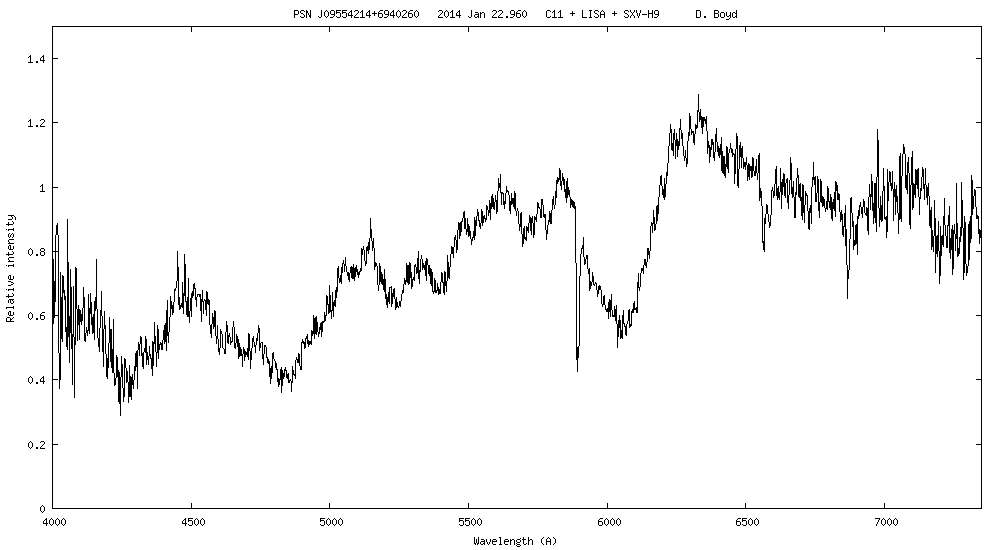

Spectrum on the supernova in M82 taken tonight with C11 + LISA, 30x3min. Clear but very damp conditions.
Photometry at the same time gave
B = 12.78
V = 11.49
R = 10.72
I = 10.31
B = 12.78
V = 11.49
R = 10.72
I = 10.31

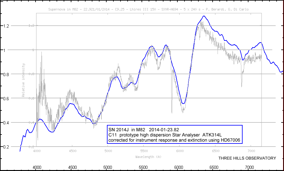

A spectrum from tonight using a prototype high dispersion Star Analyser mounted in a filter wheel just 26mm from the camera sensor giving R~120 at 6000A. It confirms a reddened type 1a supernova.
I have overlaid Paolo's spectrum from last night for comparison

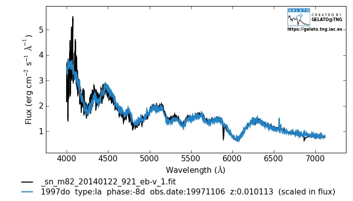

Very interesting Francois. I also got a good fit with SN 1997do if I simulate a de-redden from E(B-V)=1 (spectrum of 22 jan).
http://quasar.teoth.it/forums/download/ ... &mode=view
Do ATel mention B-V, not IS reddening? The problem seems that there is an upper limit because the SN is already too bright, considering the distance, for an E(B-V) high value.

Excellent ! Paolo
That matches very well
Yes, ATel gives B-V and compares the value to expected B0-V0= 0 value (without reddening)
*B-V=1.2 (instead of B-V~0 for a normal type Ia at the same epoch)"
So you get E(B-V) = (B-V) - (B0-V0) = 1.2
