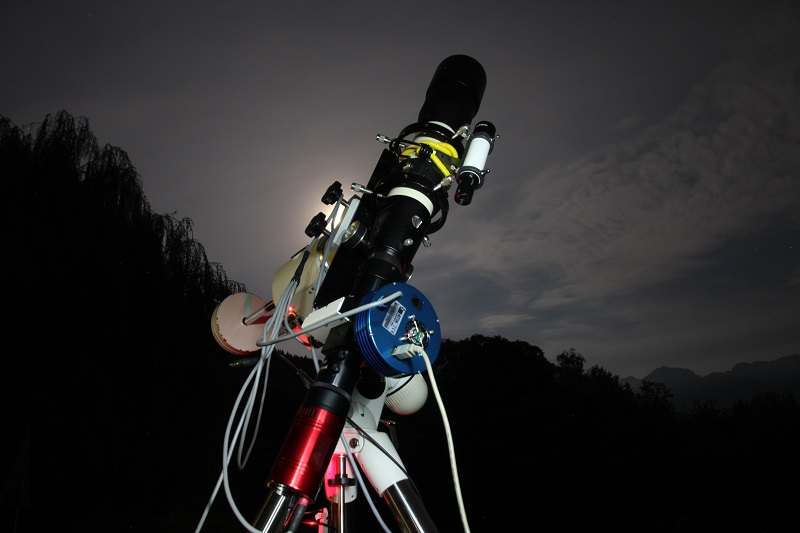

weather is turning bad but I had 30min window on the nova and I was able to get hd196544 as reference. SO I got my 9th night spectrum of the nova... :-)
Equipment is still the small Televue 85mm refractor and the Alpy 600 spectrograph with Atik Titan for guiding and Atik 460ex for acquisition. Spectroscopy is great because it can be done during full Moon and with foggy skies:
web_IMG_7190 Alpy600-TV85 moon and clouds.jpg (85.52 KiB) Viewed 27714 times

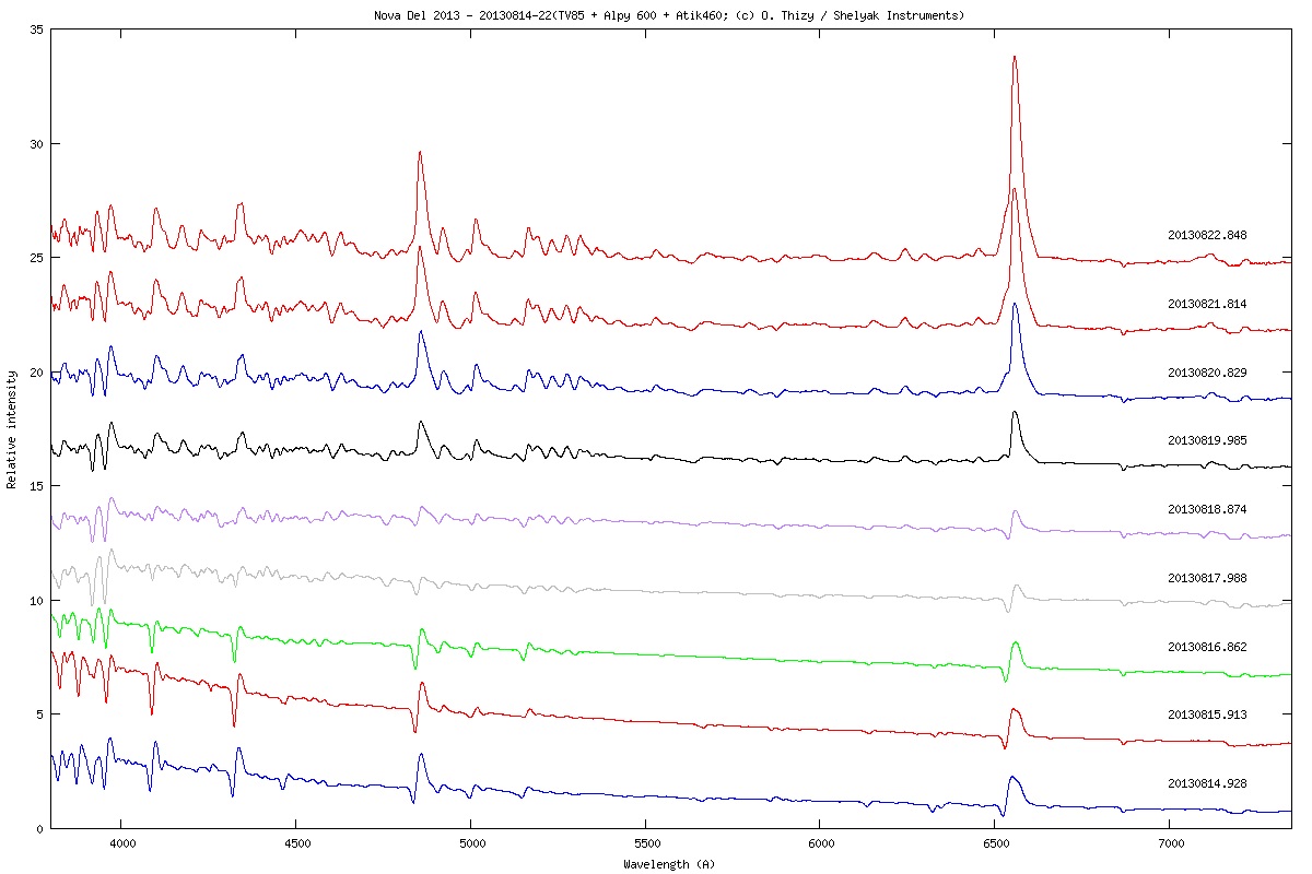

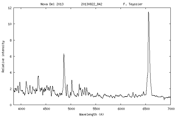

Here is the graph with one spectrum per night since the beginning on august 14th:
Halpha is actually continuing to grow drastically! :-)

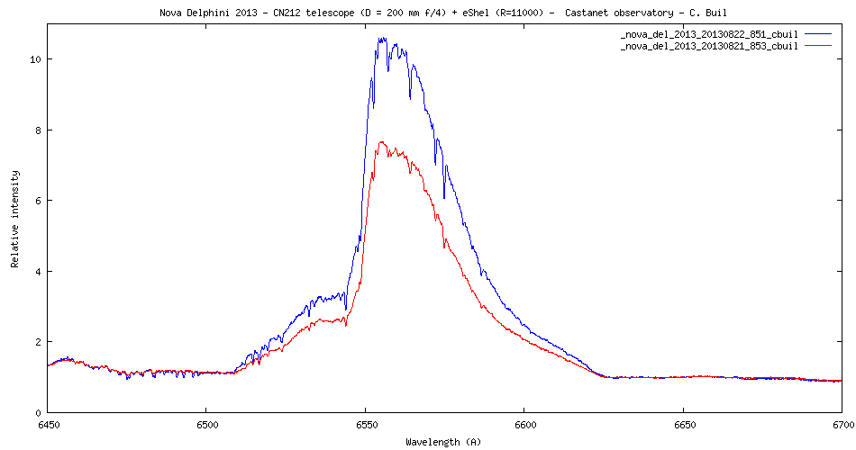

La comparaison de l'aspect de la raie Halpha entre hier et cette nuit.
Je lui trouve un air de famille de plus en plus prononcée avec
la nova Sagittari N°4 de 2012 :

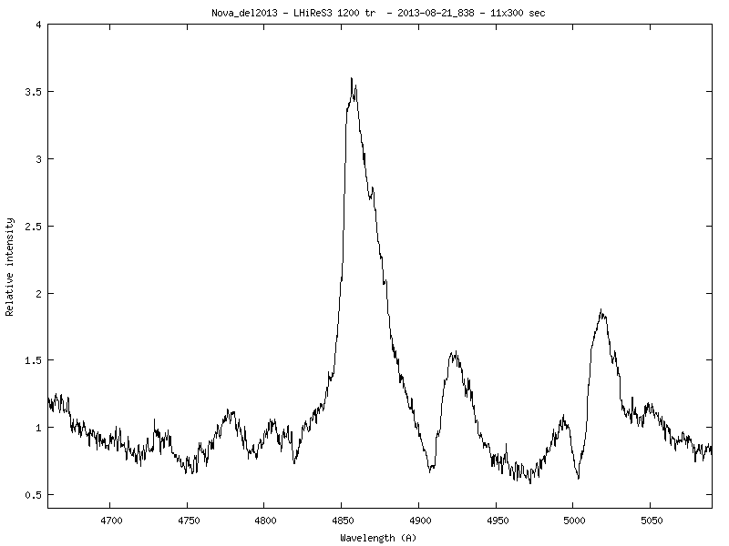

This night (22-23) blue region of nova with eShel (order from #51 to #55) i.e. spectral range 4050-4450 A :

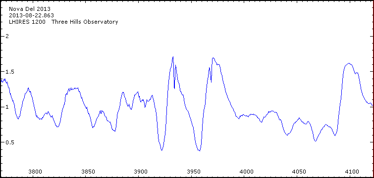

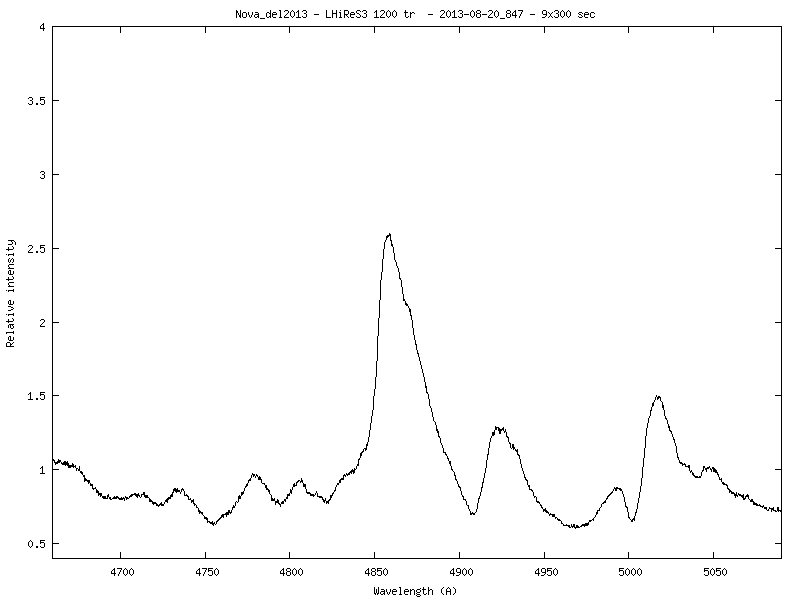

Here is the Ca II HK region (3770-4120A) with LHIRES 1200l/mm for 20130822.863

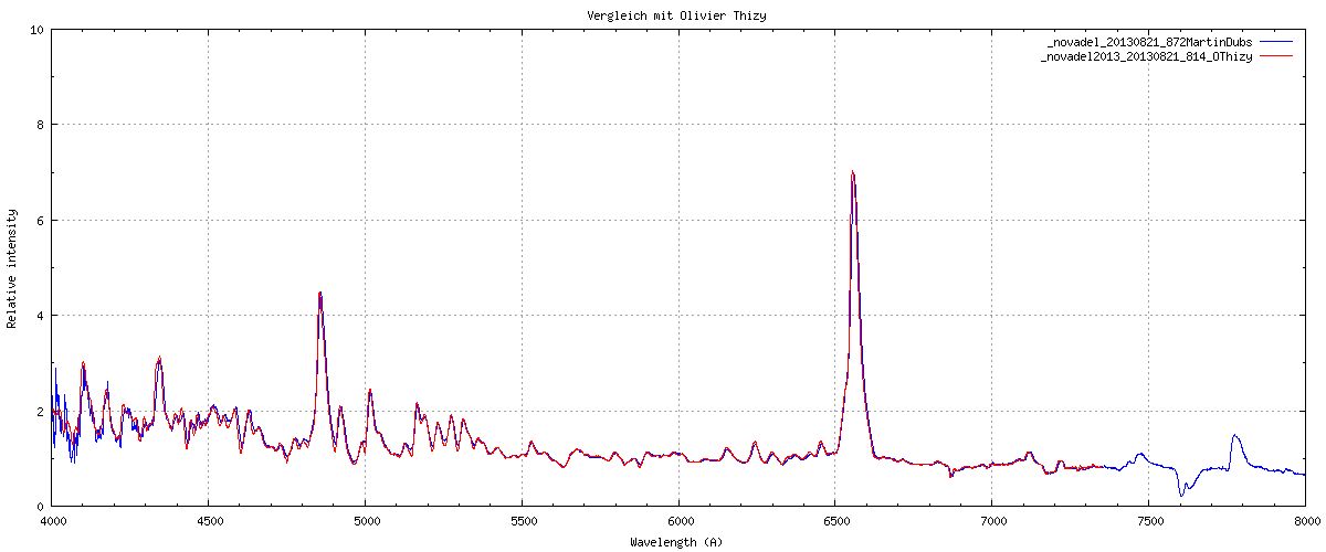

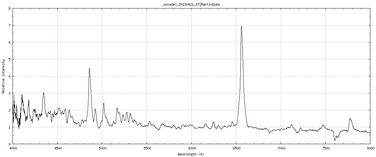

I did not want to miss this Nova. Here is my contribution to the campaign:
Special about this spectrum is, that it was recorded with my home built echelle, not as an echelle spectrum, but in the low resolution mode, bypassing the echelle grating. My echelle suffers from different drawbacks, poor grating efficiency, low camera efficiency, poor fiber transmission, small telescope (Vixen VC200), in addition hazy sky, so I had to switch to the low resolution mode (R = 650).
A comparison with a spectrum taken by Olivier Thizy from th ARAS database shows good agreement:
novaDel Thizy.jpg (61.13 KiB) Viewed 27703 times
It took me a while to figure out calibration (with A HgAr lamp) and instrument response (with a fiber flat), but it looks I managed it after a few headaches.
I hope to contribute some more spectra as soon as my LISA gets back from France.
Regards, Martin

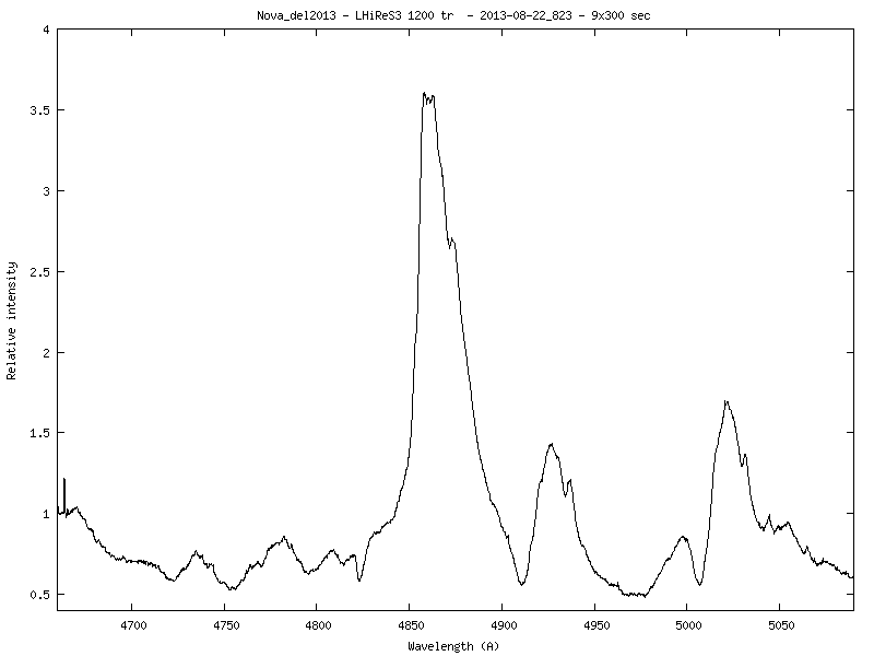

I'm currently processing the last night spectras.
H beta is still growing. We can clearly see that new spectral lines are coming on the red side of each larges emission lines ; this becomes more clearer this evening. By the way, H beta shows a new profile at the top. Christian Buil shows the same with is last spectras.
I have 35 images of 300 sec each around H beta and a sequence around CaII h&K. I've got some job for the rest of the day...

Eric, it's a great spectroscopy with a high signal to noise ratio !
Martin, welcome to the campaign. Your comparison with Olivier data is
impressive and your spectrograph work very well. You are a fine
instrument constructor. I appreciate very well and I love.
Here's some graph to compare data from 22th to 23th
H alpha line is always growing up and some change between 4200 to 4300 Å.
range from 4267 to 4353 Å (order 52 of the Eshel)
range from 4185 to 4270 Å (order 53 of the eshel)
