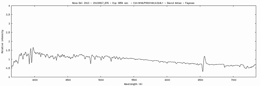

Belle évolution de Halpha!

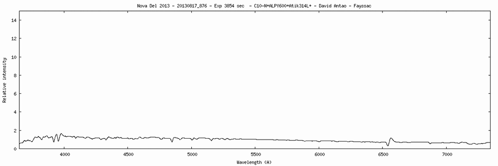

Voici ce que ça donne avec l'ALPY600.
Amicalement
David Antao
Evolution Nova_Del_2013 - ALPY600 T250mm David Antao - Y4.gif (200.82 KiB) Viewed 14964 times
Evolution Nova_Del_2013 - ALPY600 T250mm David Antao - Y15.gif (103.89 KiB) Viewed 14964 times

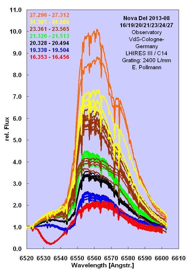

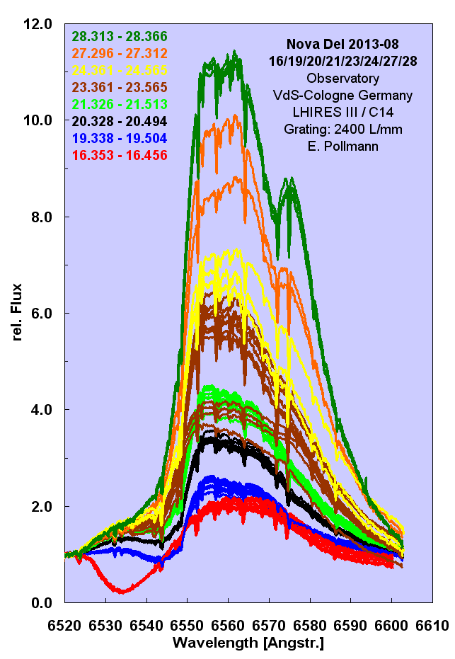

The Halpha emission is still growing and the profile size has contemporaneous changed. The extremly outer areas of the expanding gas cloud do have obviously lower expansion velocity than the inner parts.
The intensity on the ordinate is different to those of other observers, because of the small wavelength section of the 2400 grating of the LHIRES III and my normalisation on 1 at 6520 Angstr. Nevertheless, the essential expansion processes are vry well observable in this way.

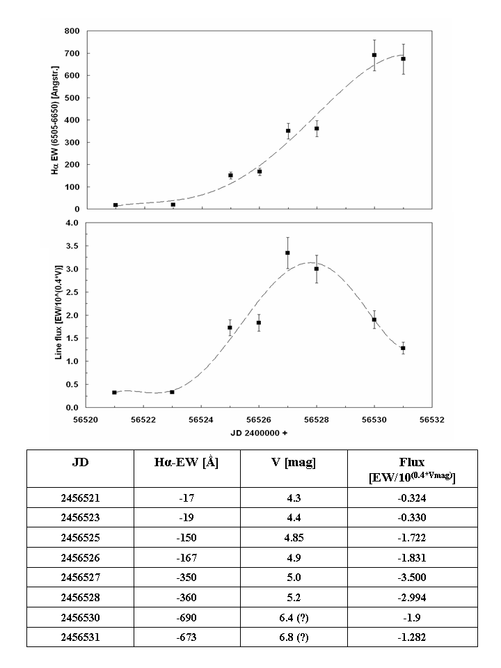

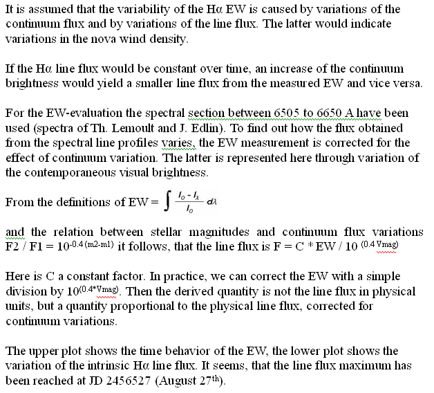

Corresponding to the posts of Martin Dubs and me (121 & 122) here some thoughts to the intrinsic Halpha line flux (see attachments).
http://www.astronomie.de/astronomische-fachgebiete
line flux.png (48.51 KiB) Viewed 14933 times
Very interesting Ernst,
Have you allowed for any relative change in flux level between the V band and where the H alpha line was normalised?
Since we have a set of Echelle spectra, a more direct measurement could be made by integrating the flux over the V passband in those spectra and using the result and the Vmag data to calibrate the spectra in absolute units.

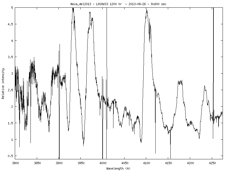

Décidément, j'ai du mal avec les logiciels de traitement. Il m'a fallu reprendre IRIS5.5 pour arriver à sortir quelque chose de mes images de la nuit du 26 au 27...
Je continue à chercher ce qui ne va pas.
Voilà ce que ça donne. C'est pénible car j'ai de l'info dans mes images brutes et je n'arrive pas à les exploiter comme il faut.
I'm still fighting with le processing softwares ; don't know why I can't do good things. I used IRIS5.5 to obtain this result with my images of the 26-27 august night.
I'm still looking what is wrong.
Here is the result.
ErIc
(Eric, tu fais une erreur dans ton traitement, et j'ai aussi l'impression que tu te complique la tache - il faudrait dans un autre fil que tu poste des images de brutes et queques étapes du traitement).

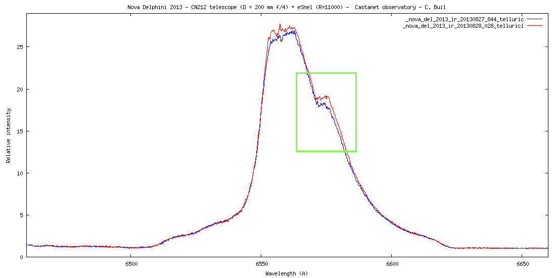

Just processed, aspect of Halpha line this night compared a with spectrum taken 24 hours ago (I have removed telluric lines for display only, and for compute precise EW... excellent analyse Ernst of actual situation and computation method):
Note fast feature development at the red edge level.
The IR spectrum:

Post by Ernst Pollmann »
The spectrum of August 28th shows still more clearly the two different velocities of the inner and the outer area of the expanding matter.
Christian: a confirmation of your observation!
Do we observe at the moment the development of a ring structure?

Ernst,
Two spectra taken at 3.4 hours interval the August 27th give some info (the evolution seem very fast at the date).
