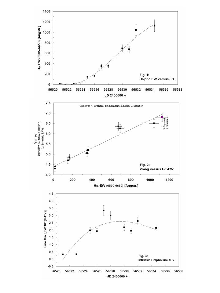

- Posts: 461
Corresponding my considerations (on page 14 this forum), here further evaluations regarding the intrinsic Halpha line flux (see attachment):
Fig. 1: Halpha EW versus JD (trivial)
Fig. 2: Vmag (550 nm) versus Halpha EW
Obviously a clear inverse correlation between both: an increase of the continuum brightness (here V mag at 550 nm) will yield a smaller EW and vice versa.
Fig. 3: Halpha line flux versus JD (see page 14)
The variability of the EW is caused by variations of the continuum flux and by variations of the line flux, the latter is caused by variations in the wind density. While the EW in Fig. 1 is continuously increasing, the line flux (wind density) seems to decrease since JD 2456529.
Comments are welcome!
Ernst
Ernst

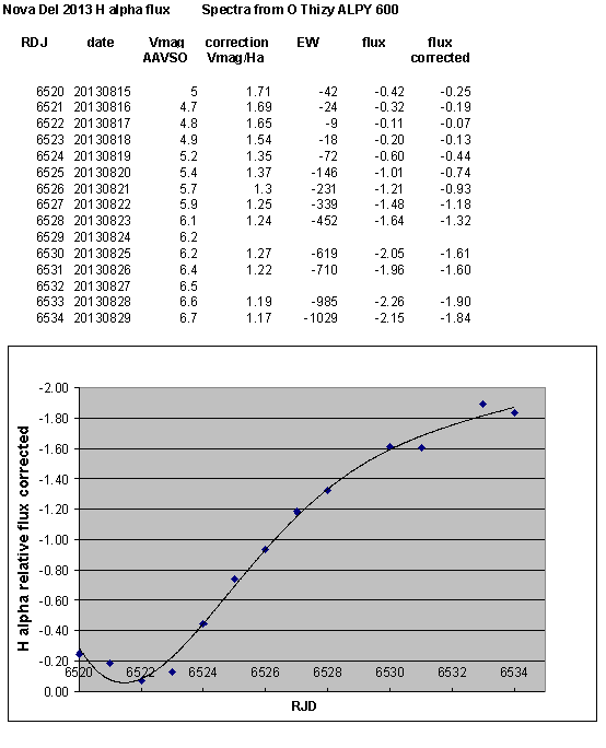

Hi Ernst,
My results derived independently show the H alpha flux still rising (see attached)
I think there are two significant differences between our data which produce the difference
1. The relationship between the Vmag flux and the flux in the continuum at Halpha is not constant but varies as the nova continuum cools
2. The V mag values you are using are significantly different from the mean values in the AAVSO database
I calculated the correction factor from V mag to H alpha continuum by multiplying the spectra (previously normalised at H alpha) by the normalised V mag filter response and taking the average of the result over the Vmag passband.
- novadel2013_halpha_corrected_relative_flux.png (9.23 KiB) Viewed 20636 times
Last edited by Robin Leadbeater on Sat Aug 31, 2013 1:12 pm, edited 1 time in total.
- Posts: 461
... why should the visual (estimated) brightness of the AAVSO data base be more correct (better suitably) than the photometric CCD values?
... can you demonstrate this?
Ernst
Ernst
Hello Christian,
I used a similar technique to improve Ernst's method of measuring H alpha flux, but for better accuracy should we correct the filter response to include the response of the sensor? This is hopefully a small effect at V but could be large I think at B where the typical CCD response is changing fast.Christian Buil wrote:Here the classic BVRI Bessel filter transmission

Hi Ernst,Ernst Pollmann wrote:... why should the visual (estimated) brightness of the AAVSO data base be more correct (better suitably) than the photometric CCD values?
Ernst
I used the photometric Vmag data in AAVSO (means of several observers) not visual estimates.
http://www.aavso.org/lcg/plot?auid=000- ... an=&vmean=
The relationship between the flux in the Vmag passband and the continuum at H alpha is calculated see the column labelled "correction vmag/Ha" The reduction in slope of the continuum with time is clear in the spectra. There is also an effect from the change in intensity of the many P Cygni lines, mainly from Fe in the Vmag passband. See for example the animation by Paolo here
http://quasar.teoth.it/html/spectra/novadel_15_21.gif
- Posts: 461
Robin you wrote:
The relationship between the flux in the Vmag passband and the continuum at H alpha is calculated see the column labelled "correction vmag/Ha".The reduction in slope of the continuum with time is clear in the spectra.
This is what Fig . 2 in my analysis is saying (although for 550nm):
an increase of the continuum brightness (below Halpha) leads to a smaller EW and vice versa, proven with the correlation coefficient of better than 0.9.
In addition: as Christian´s Bessel plot shows, there is obviously no significant difference of the continuum level V (5500) to R (6500).
Ernst
Ernst
Ernst
your Fig 2 appears to be a plot of H alpha EW against Vmag. I do not understand what this has to do with the correction I am making which is for the difference in flux between where the V mag brightness is measured and the continuum around H alpha where the spectra are normalised for the EW measurement. Are you seriously saying that the ratio of the mean flux in the Vmag passband to that in the continuum at H alpha has not changed during the past 2 weeks? The figures calculated from the spectra say otherwise (Including those made by Christian, who used the same technique as I did, though I do not see where this has been calculated explicitly)
The main difference between our measurements however is due to the difference in the Vmag values used. Do you know why the Vmag values you are using are significantly different from the values provided by other observers in the AAVSO database?
