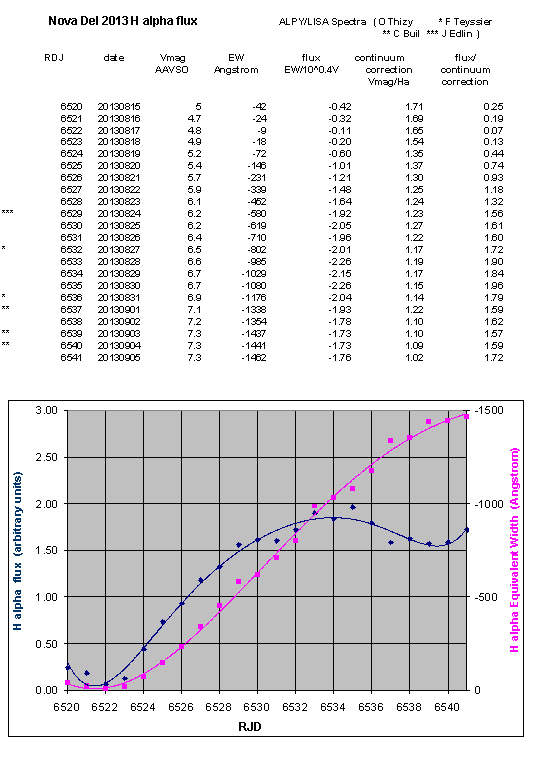

An update of my calculations of H alpha line strength (absolute flux, arbitrary units, click on the attachment to see the trend graphs)
The spectra are low resolution (LISA and ALPY) from the database and scaled to the continuum at H alpha
The H alpha EW is then converted to absolute flux (arbitrary units) using the AAVSO Vmag values (Flux = EW/10^0.4Vmag)
These values are then individually corrected for the ratio of the weighted mean flux in the Vmag passband to that in the continuum at the H alpha line.
(The weighted mean in the Vmag passband is calculated by multiplying the spectra by the normalised Bessel V response and calculating the mean of the result)

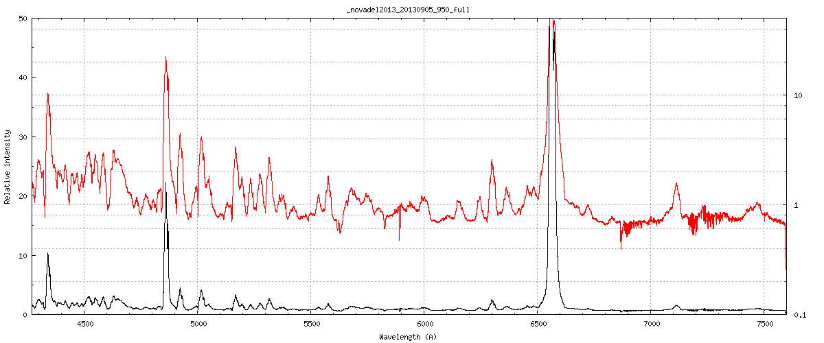

Martin Dubs
Posts: 144
Post by Martin Dubs »
I would like to announce that by kind permission of Noel Richardson and Thomas Eversberg from the WR13x-collaboration (see: http://www.stsci.de/wr134/index.htm
and with the help of the observing teams it was made possible to observe the Nova Del 2013 from the IAC80 telescope with an eShel at Teide on 13 nights between aug 17 and sep 5 (weather and equipment permitting some more to come).
The results have been uploaded to the ARAS database under the name WRx-collaboration. The thin dry air is especially useful for the observation of H-alpha lineshape. Of course the main goal is still the observation of WR stars, so only a limited time could be used for the observation of the nova.
To give an idea of the spectra obtained there the last example from sep 5,
merged spectrum, black linear scale left axis, red log scale right axis

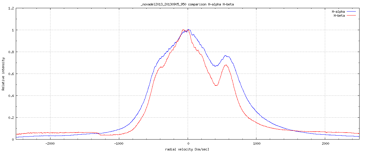

with an aditional plot for the comparison of H-alpha and H-beta from the same spectrum (O34 and O46) on a velocity scale, normalized to the peak height:
H-alpha and H-beta displayed in radial velocity
_novadel2013_20130905_950 velocity.png (8.83 KiB) Viewed 145611 times
Noticeable is the double peak and the different linewidth.

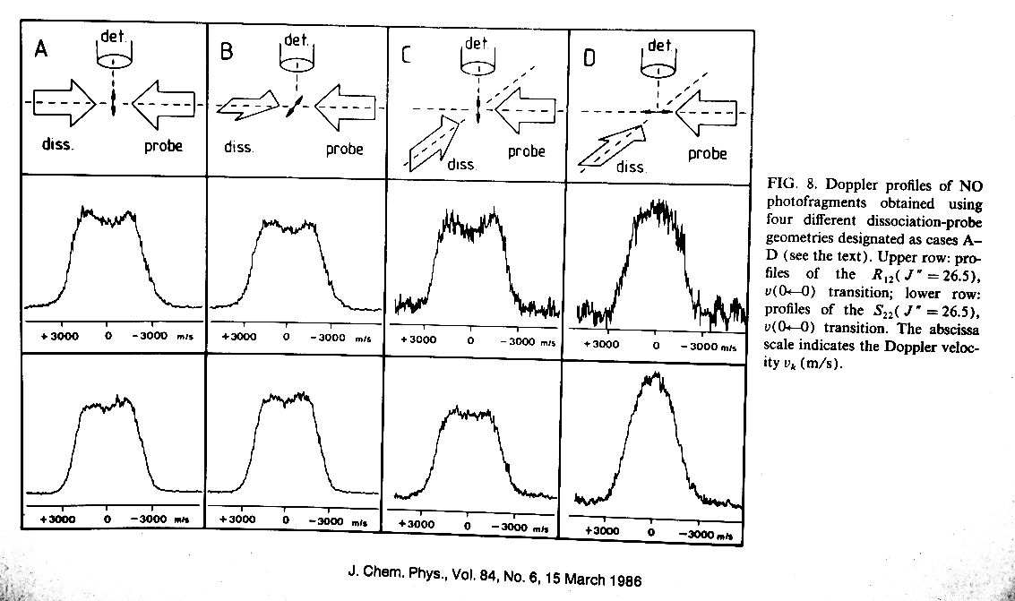

This profile reminds me of quite similar profiles obtained many years ago in a completely different context, the doppler spectroscopy of molecules, in particular the spectroscopy of molecules dissociating after a laser photolysis. In order to get high enough resolution a second tunable laser was used with a narrow linewidth. The difference to the above spectrum is the range of observed doppler widths, m/sec instead of km/sec, the observed volume: a mm^3 of low pressure gas instead of a solar mass and the possibility to observe the reaction from different angles with different lineshapes depending on laser polarization and viewing angle:
Doppler velocity profiles of laser induced photofragments viewed from different angles
NO doppler velocity.jpg (117.4 KiB) Viewed 145611 times
abstract: http://jcp.aip.org/resource/1/jcpsa6/v84/i6/p3106_s1
I know this is a bit off topic, but interesting that in physics the same problems occur in quite different fields, from tiny molecules to astrophysics.
Regards, Martin
Robin Leadbeater wrote:An update of my calculations of H alpha line strength (absolute flux, arbitrary units, click on the attachment to see the trend graphs)
Good work Rob in !
Could you compute the absolute flux ?

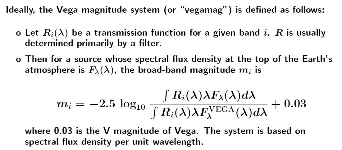

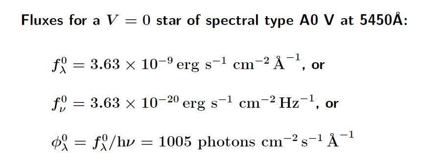

Hello Francois and Robin,
the calibration constant for conversion to absolute flux can be obtained by applying the same procedure to e.g. a Vega spectrum. The flux for a V = 0 star at 5450 A is:
flux Vega.jpg (30.58 KiB) Viewed 145608 times
from a reference which can be found by Google with "ASTR 511 magnitude color virginia"
The calibration constanrt can be determined to give the desired absolute flux for Vega based on the equation:
from the same reference.
So instead of using two measured spectra for the absolute calibration as Christian does it, one can use one spectrum and the V mag plus a calibration constant from a spectrum with absolute calibration.
I wanted to do this after a suggestion to Ernst but was busy with the Teide spectra and now Robin has done already 99% of it!
Would be interesting to see if you get the same results as Christian.
Regards, Martin
