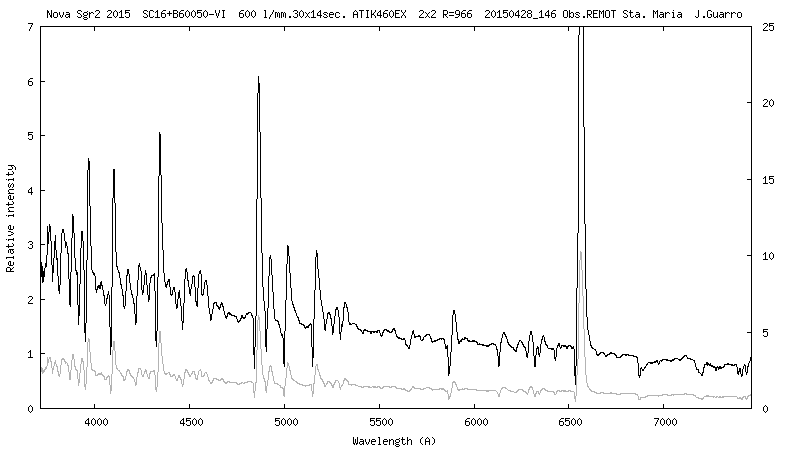

Hello:
The Nova Sgr #2 2015 in the last night.
Star of caparison, HD168646 A3III.
J.Guarro.
_novasgr#22015_20150428_146_J. Guarro.png (8.03 KiB) Viewed 10219 times
