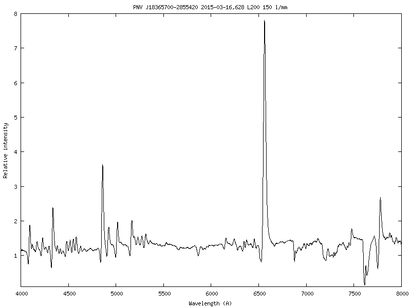

I have taken a low-resolution (R=260, 150 l/mm) spectrum of this. The spectrum appears to be that of a Fe II nova shortly after maximum. Prominent lines of Fe II are already showing at 4924-5018-5169 and 4491-4629. Strong P-Cygni profiles evident; at this low resolution the ejecta velocity appears in the region of 1400 km/s (+/- 250 km/s).
I'm currently collecting higher-resolution (1800 l/mm, R=c.8000) data of the H Beta region and redwards, including the iron forest around 4924-5018-5169, so should get a much better velocity calculation from that.
Jonathan

Here is the high-resolution data. 2 hrs data on the region 4770-5190, showing the H Beta and several of the iron lines. JD 2457098.2097
Ejecta velocity c.1100 km/s in this spectrum.
Jonathan

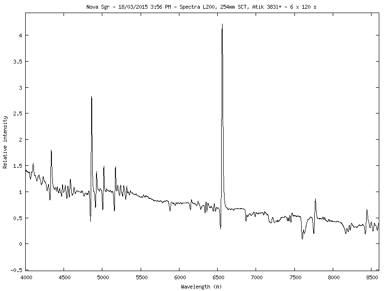

Here is a low-resolution spectrum from 18-3, and a comparison of the central section of the low-res spectra from 18-3 and 16-3. Interesting to observe the deepening of the P Cyg profiles and the reduction in expansion velocity over those two days.
