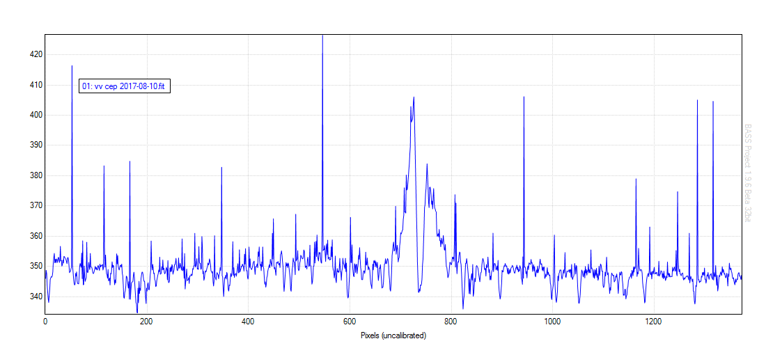

So here is the latest 'quick' spectrum tonight around 22.00 hr 2017-08-10 revealing no changes yet in the H alpha profile.
I keep monitoring with interest.

wonderful, your further engagement to contrubute to the campaign. But don´t worry when I say that this spectrum is not suitable for evaluation of EW and PH of the Halpha components because of the many spikes and the low S/N.

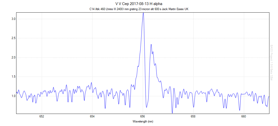

No changes in H alpha emission as of 2017-08-13, I am continuing to monitor.
Jack

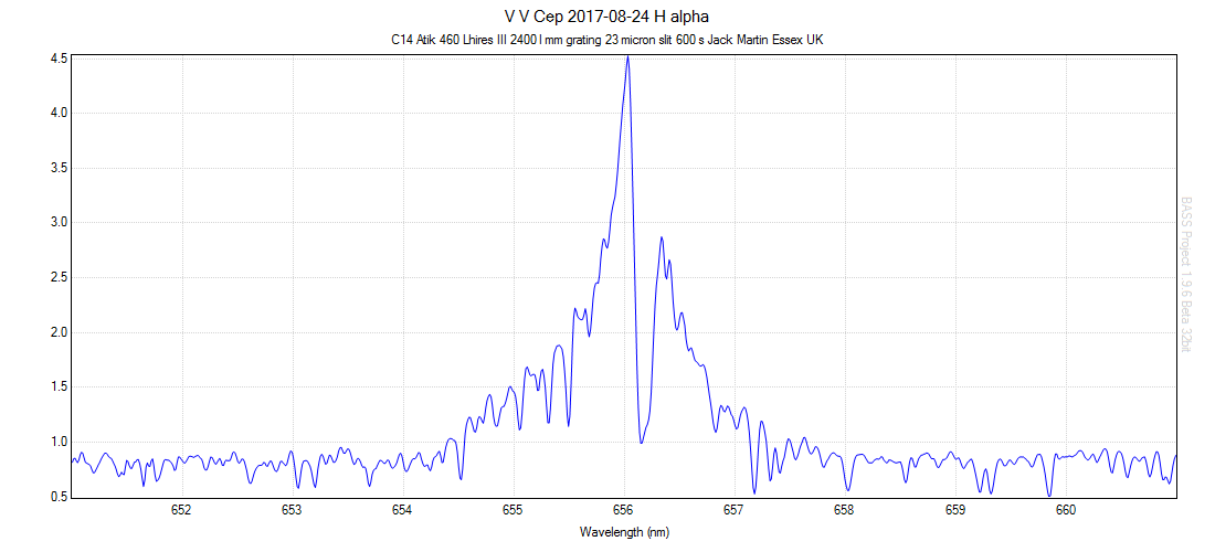

Latest H alpha emission profile as of 2017-08-24.
Regards,
Jack
Essex UK
