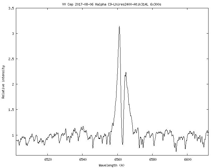

Voici le profil de cette nuit.
Cordialement.
Jean-Jacques

Pour le profil pris à l'OHP, j'avais une résolution de 10840.
Cette nuit, en région parisienne, la résolution est de 15840.
Le setup est le même. Il a été démonté/remonté pour le trajet.
Aurai-je mal focalisé à l'OHP?
Merci
Cordialement.
Jean-Jacques

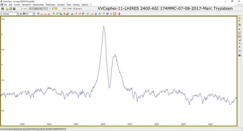

Hi Jack and Ernst,
Indeed, no major changes yet.
My last spectrum is from August 7th, I had a chance of a short time clear sky, just between two heavy rain showers, thunder and lightening.
For a while now the Peakheights of the V-component reside somewhere between 3 and 3.5 while the R -component fluctuates between 2.20 - 2.5.
Assuming mass transfer has taken place earlier, it is quite possible the predicted/calculated start of the eclipse will be later. If it is 68 days later then we can expect it to happen around the beginning of October! We could have a more precise guess if we know the orbital movements of both stars over the last year.
Monitoring on a "nightly" basis is possible if we can use a remote spectroscopy installation. Of course this is a quite expensive project, but with a team doable.
A nice place could be found with the e-Eye project.
http://entreencinasyestrellas.es/
Kind regards,
Marc.
