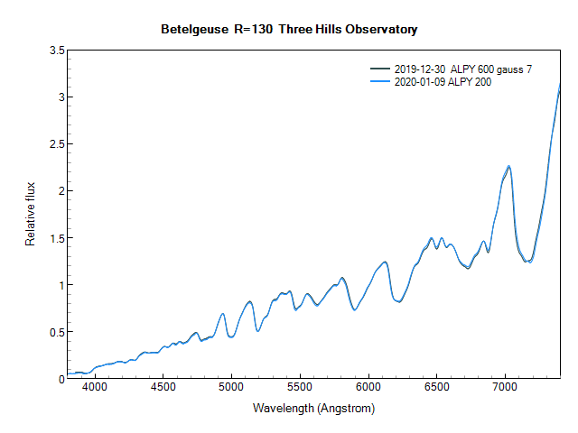

No change at all in the last 10 days in the visible at (low R~130) resolution. (yes there really are two spectra plotted there :) ) The latest one was with the ALPY200 which I happened to have on the scope. Not ideal for this sort of brightness. It saturated in 0.3sec so I had to average ~50 exposures to beat the scintillation :lol:
