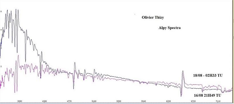

Re: Nova Cep 2013
Hi ,
I process my photometrics measurements and upload in U B V Rc Ic in the AAVSO database
The Ic [7250 - 8750 ] mag seems to grow up again, But there is no others measures in the database so i can't compare.
I look at the alpy spectra of Olivier and it seem to confirm that the spectra is higher in this spectral area also
(arasdatabase : _novadel2013_20130816_909_OThizy.fit and _novadel2013_20130814_928.fit
If it's not an artefact why the infrared part grows ?
Thibault
Thibault
- spectreOT.jpg (43.97 KiB) Viewed 35060 times
