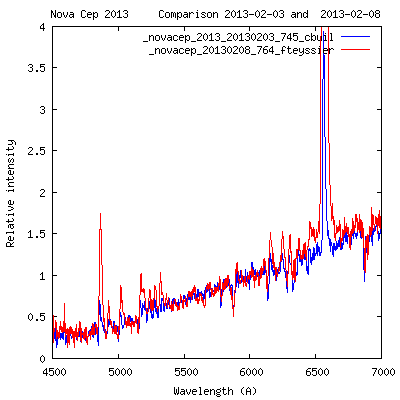

- Posts: 1562
Re: Nova Cep 2013
2 hours without clouds and a spectrum
Strong enhancement of Balmer and Fe II emission lines.
Comparison between 03-02 and 08-02 spectra
I opened an Aras page dedicated to Nova Cep 2013 :
http://www.astrosurf.com/aras/novae/Nova2013Cep.html

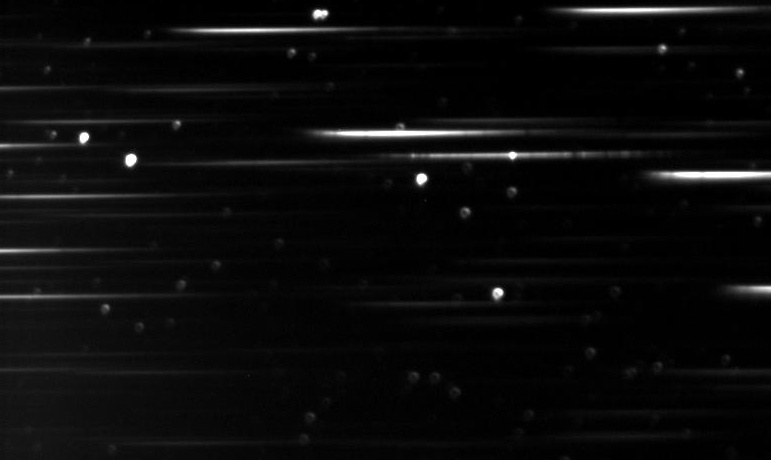

Re: Nova Cep 2013
This is how it looked with the Star Analyser on 2013-02-06. The spectrum in the far red beyond H alpha looks interesting but would need to be checked for interference from the second order of course.
(It was a first test after an observatory rebuild and it looks like I have some more work to do on collimation)
- Nova_Cephei_2013_20130206.jpg (49.78 KiB) Viewed 51509 times

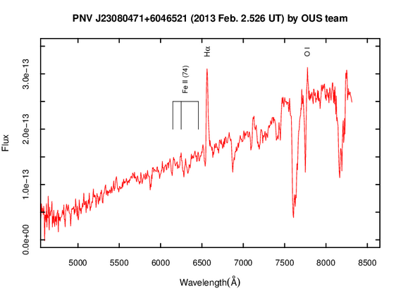

Re: Nova Cep 2013
Does anyone know what the 74 next to the Fe lines in the confirmation spectrum means ?
download/file.php?id=785
