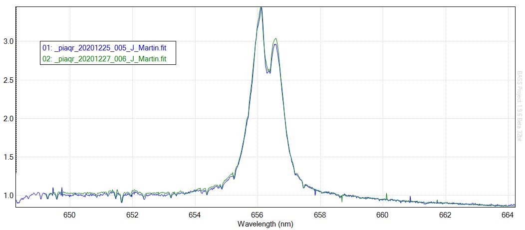

Followup observation 2 nights apart.
Any comments ?

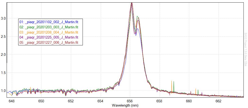

Here are the differences in 5 H alpha line observations from 20201102 to 20201227.

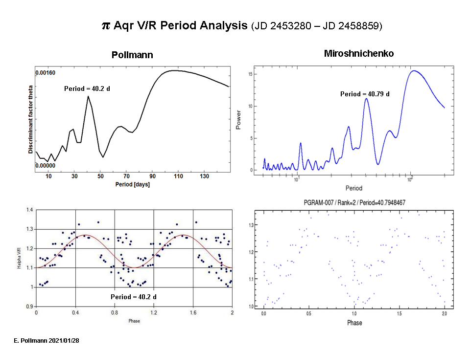

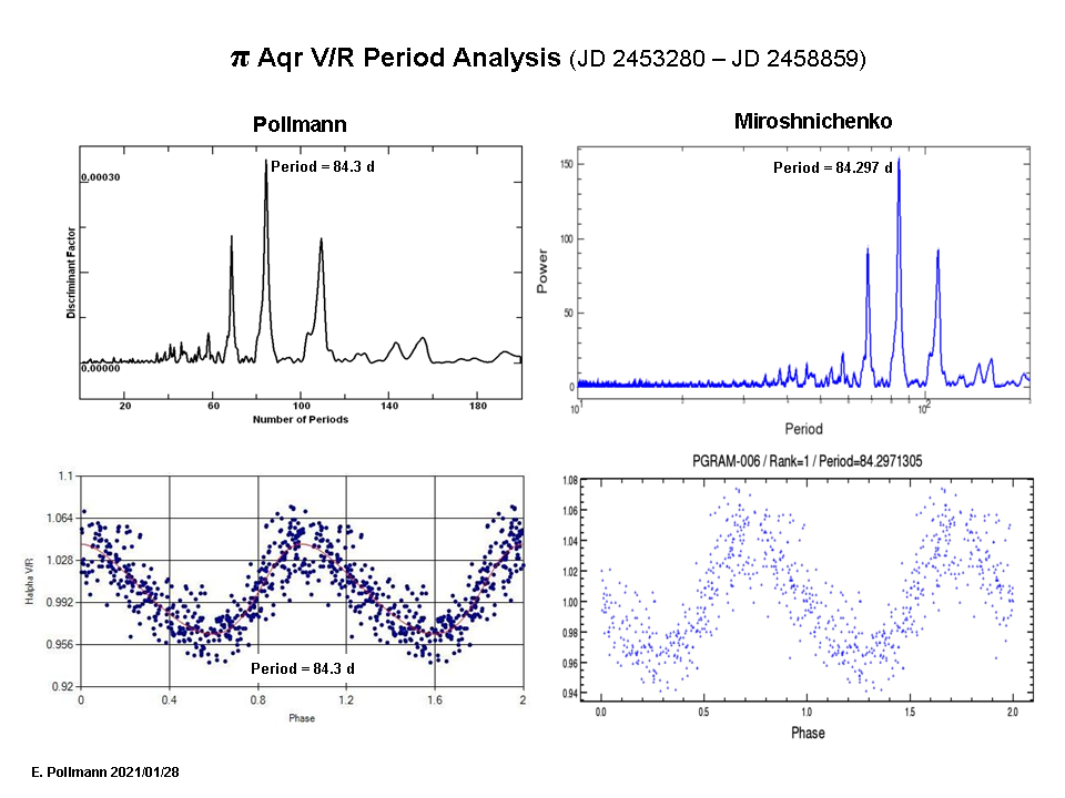

the comparison of the Fourier analysis of Prof. Dr. Anatoly Miroshnichenko to my analysis of the V/R data before the increase (JD 2453280) and after them did yield almost a perfect accordance (see attachment).
The recent data (JD 2459057 to JD 2459227) don´t show such a strong peak in the power spectrum and the phase curve for the 42-day period is not as good. This is probably partially due to the 84.3-day orbital period and a lack of data, because this data set covers only 150 days which is not even 2 orbital periods.
Anatoly commented:
we need more time coverage before making any conclusions. I think that as the disk becomes larger and accumulates more matter, its structure may change and we may see a single-peak Halpha profile in the nearest future. This kind of profile was observed in the spectrum of Pi Aqr in the 1980's (K. Gosh_1988, A&AS) when the Halpha line EW was about 40 A.
It is questionable whether we get a seccond opportunity to observe such a V/R event again.
Unfortunately the observation season of the star is almost finished, so there is no chance to observe further the 42 day period.

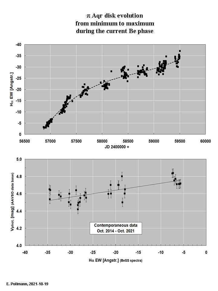

It is well known that most Be stars are photometric long-term variables, and that at least two characteristic behaviours can be recognized when simultaneous photometry and optical spectroscopy are available: positive and inverse (negative) correlation between the Balmer emission strengths and the stellar brightness (Harmanec, 1983). Indeed, a positive correlation has been observed in several Be stars as their Hα emission gets stronger when their photometric V magnitude increases:
Harmanec, P., 1983, Hvar Observatory Bulletin, 7, 55
Juza, K., et al, Astrononmy and Astrophysics Suppl., Vol. 107, p.403-411 (1994)
Koubsky et al., Astronomy and Astrophysics, v.328, p.551-564 (1997)
http://www.bav-astro.de/rb/rb2011-1/5.pdf
http://www.bav-astro.de/rb/rb2014-2/89.pdf
http://www.bav-astro.de/rb/rb2012-1/20.pdf
https://konkoly.hu/pub/ibvs/6101/6109.pdf
Obviously this is also applicable for pi Aqr. The attached plot (top) shows the Hα EW developement from JD 2456868 (2014/07/29). The plot bottom shows simultaneous V data (AAVSO data base) versus Hα EW (BeSS spectra) from Oct. 2014 to Oct. 2021.
Vmag versus Halpha EW.png (86.38 KiB) Viewed 412705 times
The current visibility of pi Aqr invites to take spectra in order to complete the correlation.

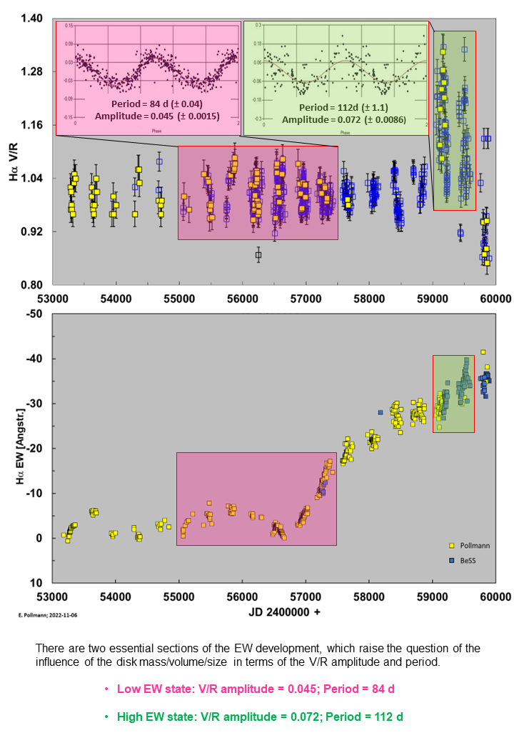

Here some news of the star:
We still have a lot of work before we fully understand those stars! But it's also true they're not really fashionable. Interest is low in the community for this kind of long-term stuff. On the contrary that it's absolutely necessary (comment of Yael Naze, Universite de Liege,Belgium)
