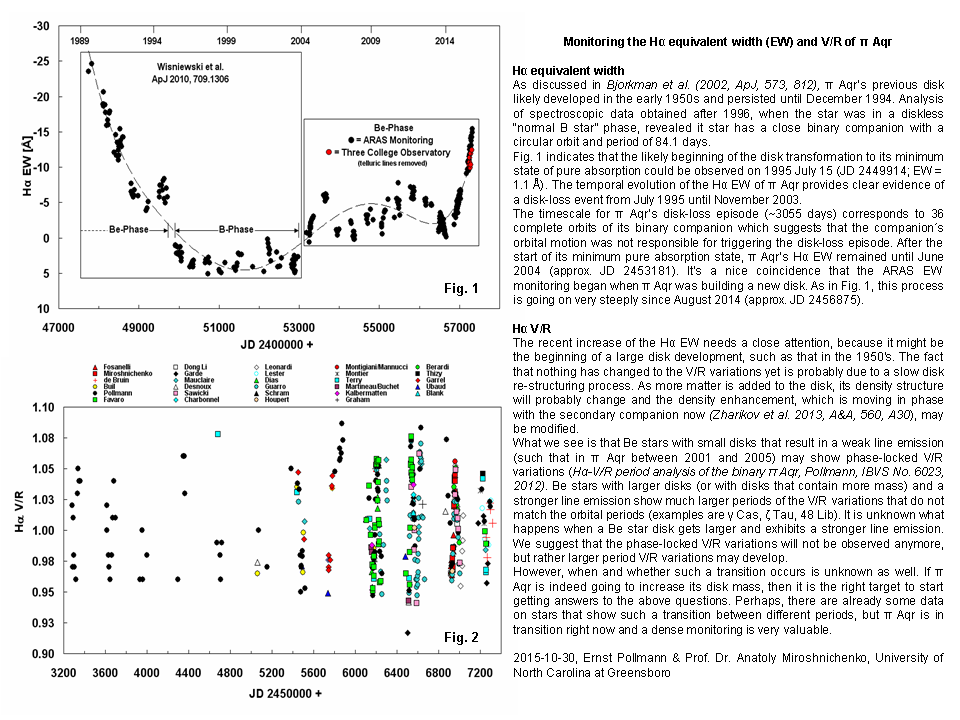

As supplement to Valerie´s monthly report, here the evaluation of the current Halpha EW & V/R long-term behavior of pi Aqr. Obviously the EW long-term component is on the way to a minimum. The Halpha-V/R 86day-period does not fit well to the current time behavior of the 2013 measurements.
Period shortening ? Observations during the next months are going to show, whether a shortening of the period will really happen or not. Therefore an active observation participation will be very important!
- EW_VR_Zeitverhalten.png (178.29 KiB) Viewed 106586 times

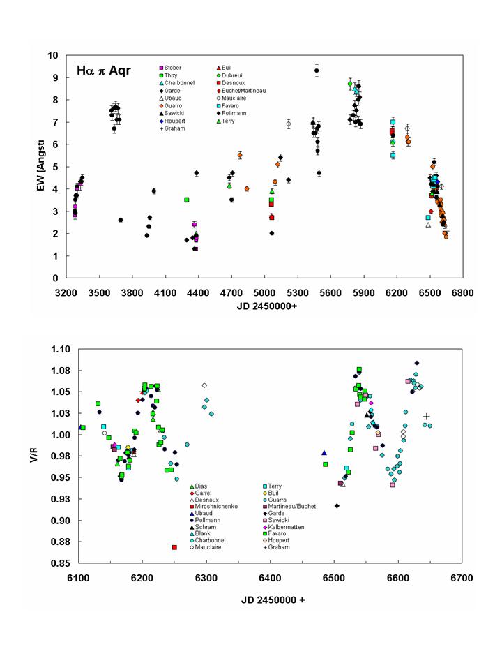

The visibility phase of the Be binary star pi Aqr is more or less past, and we can look back on a fantastic collaboration of observation in terms of the V/R and EW measurement (see attachment). We have been able to detect two V/R maxima and minima. Thanks so much to all participants for your contributions.
While the Halpha EW is on the way to its minimum (the primary almost without any disk), the V/R ratio seems in spite of that to have had a growing amplitude (compared with its behavior during the last observation campaign).
I will contact our professional colleagues Anatoly Miroshnichenko and Sergey Zarikov in order to ask, how we have to understand this fact.

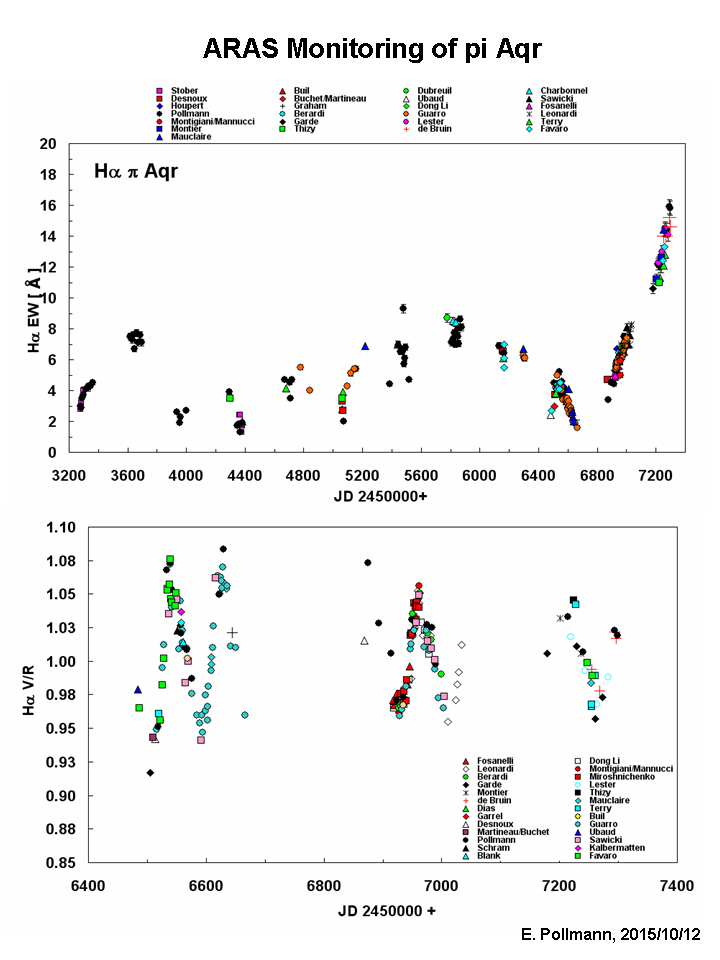

- Posts: 461
Re: pi Aqr V/R and EW monitoring

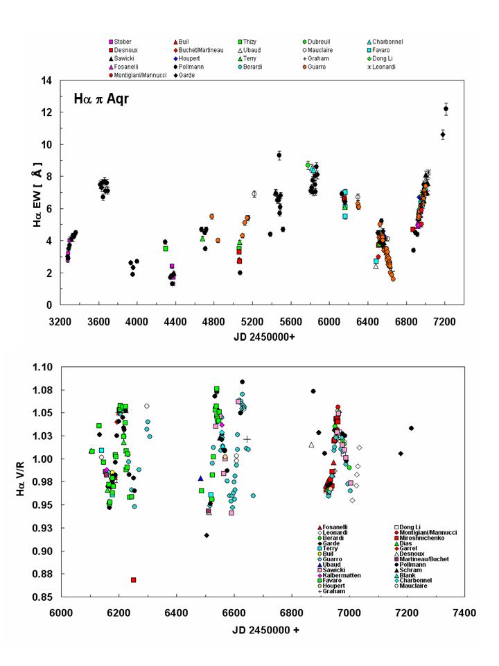

Dear colleagues,
attached you can find the ARAS monitoring of pi Aqr.
- piaqr_monitoring.png (113.45 KiB) Viewed 105765 times

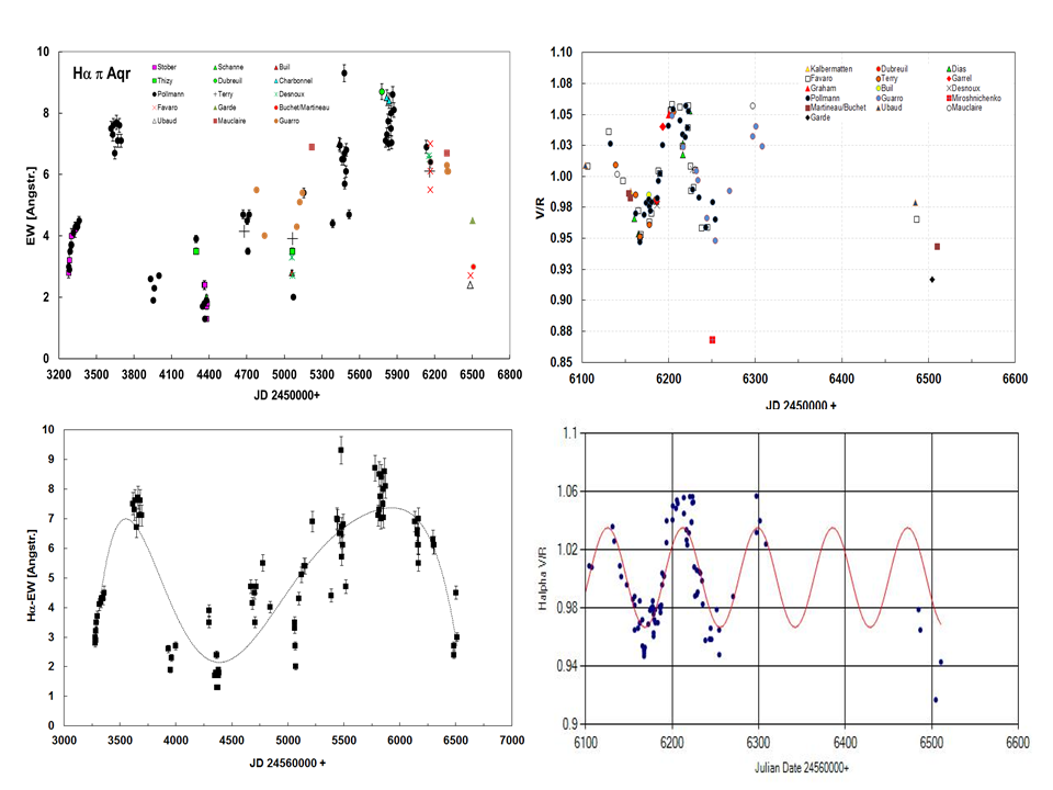

Disk enlargement of the Be binary pi Aqr ?
Related to the topic above, here a summary of the monitorings since October 2004 (Halpha V/R) and August 1989 (Halpha EW).
Comments are very welcome.

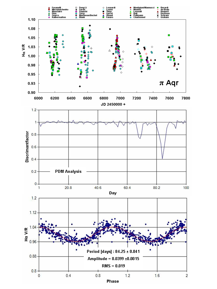

almost at the end of the visibility of the Be binary pi Aqr, here a summary of the V/R periodic behavior.
Compared with our publication in 2013 it confirms the periodicity with 84.25 days. See:
https://astrospectroscopy.de/.cm4all/up ... 8bb4&cdp=a
Thank you all for your observations and spectra which enables to draw this overview. Comments are welcome!! Ernst Pollmann

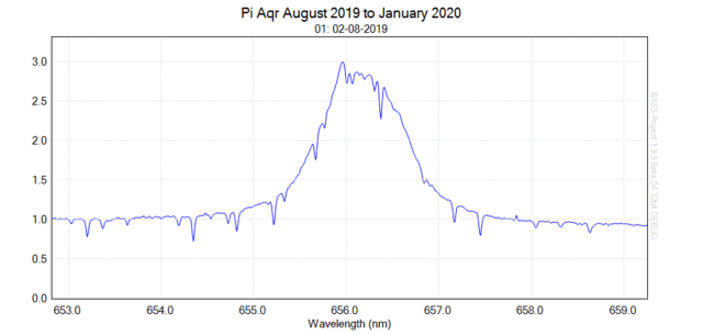

Here is my time lapse of 9 observations of pi aqr h alpha profile with Atik 460 mono C14 Lhires III 2400 l/mm grating from 02-08-2019 to 10-01-2020.
I think this is an effective way of showing changes in spectral profiles over time.
Many thanks to John Paraskeva creator of BASS for his help in creating this animation.
Enjoy,
Jack
Essex UK
Enjoy,
Jack
Essex UK
