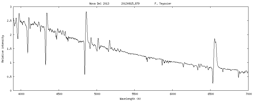

Posts: 1565
Reference star :
HD 196724 = 29 Vul
AD 20 38 31.33888
DE +21 12 04.24
Une A0V de mag V = 4.8
Francois

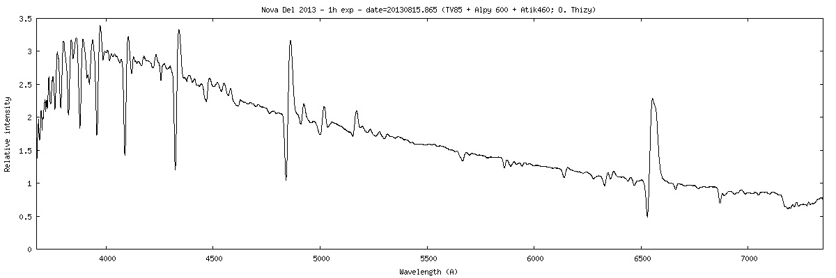

second night on the new nova Del 2013.
Equipment: EQ6 mount + Televue 85mm
Spectrograph: Alpy 600, 23µm slit, Ar-Ne calibration module
CCD: Atik 460EX (-10°C)
web_IMG_7174 Olivier et Alpy behind.jpg (123.16 KiB) Viewed 107564 times
Reduced spectrum of 1h exposure (12*5min):
http://www.shelyak.com/en/
Posts: 1565
Elle est magnifique.
