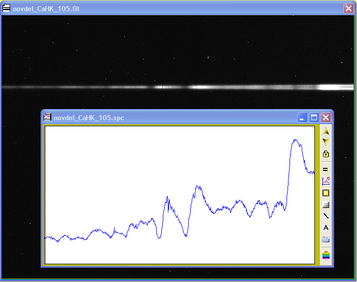

Sitting on the Ca H K lines (centred on ~ 3950A) currently using the LHIRES 1200l/mm
Broad P Cygni profiles with two very narrow absorption lines superimposed. Fascinating !

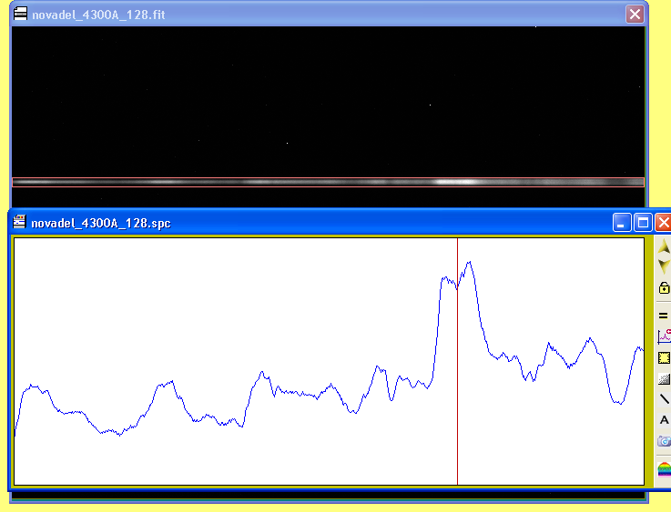

I have now moved up to ~4300A but the clouds have arrived
I did get the reference star and one exposure on the nova first though
There is an interesting double peak at the H gamma emission line
I have not yet worked out exactly how to wavelength calibrate yet but do not worry - I will find an answer
. There are many weak lines in the neon lamp. If I cannot identify enough of them I can use lines in the reference star spectrum instead and use the neon lines to check if there is any shift.
