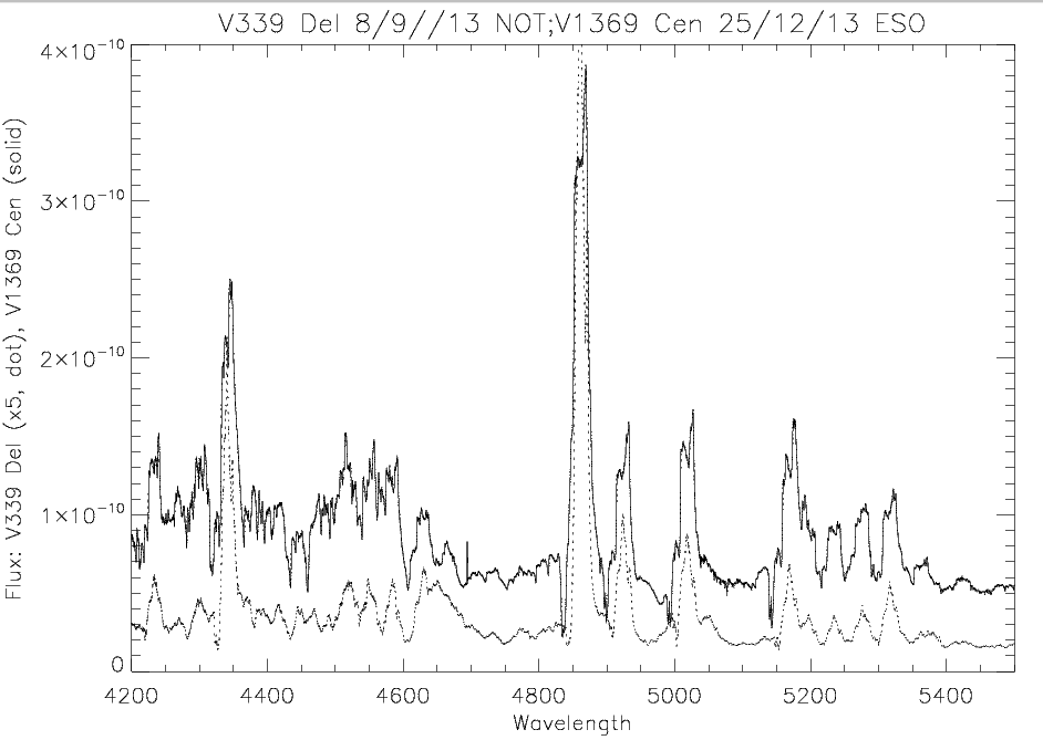

A spectrum from Steve Shore (comparison between Nova Del and Nova Cen)

Hmmm
Some of the detail looks comparable...loss of detail/ resolution down around Hgamma - probably due to focus?
Re. the continuum - I see the rise in my spectrum above the Hb - camera response?

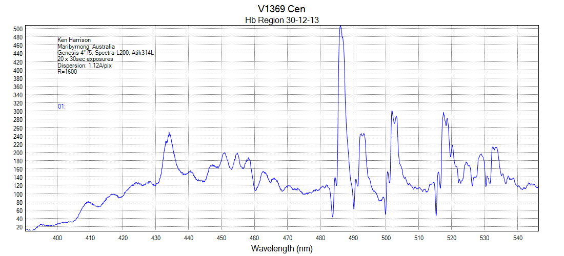

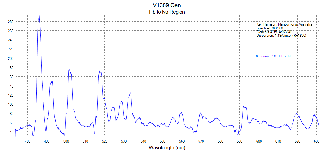

I managed to get a spectrum of the Hb region before the clouds moved in.
The Hb and Fe line profiles seem to be showing a "secondary" (P-Cygni?) dip.
Any comments??

Ken
My spectra from the previous day shows a similar structure. I note a big difference in the Hg region though comparing the 2 spectra.
Terry

Ken : this is the classical multi-absorption system, well discribed by the precurssors, as Mc Laughlin (1960) or Payne Gaspochkin (1959)
Premaximum spectrum : "broad, blue shifted- absorption lines, often with addition of P cygni profiles"
Principal spectrum, at visual maximum : stronger and more blue-shifted absorption lines. They often show multiple substructures and they evolve into emission lines
Diffuse enhanced spectrum : appears after the maximum light : similar to principal spectrum but about twice as broad and blue-shifted

Terry Bohlsen wrote:Ken
Terry
Soft focus at the blue end in Ken's spectrum perhaps? The Achromatic doublet in my LHIRES for example would certainly struggle to keep things sharp from 5400 to 4000A. The optics in the ALPY (and LISA) are so much better in this respect.

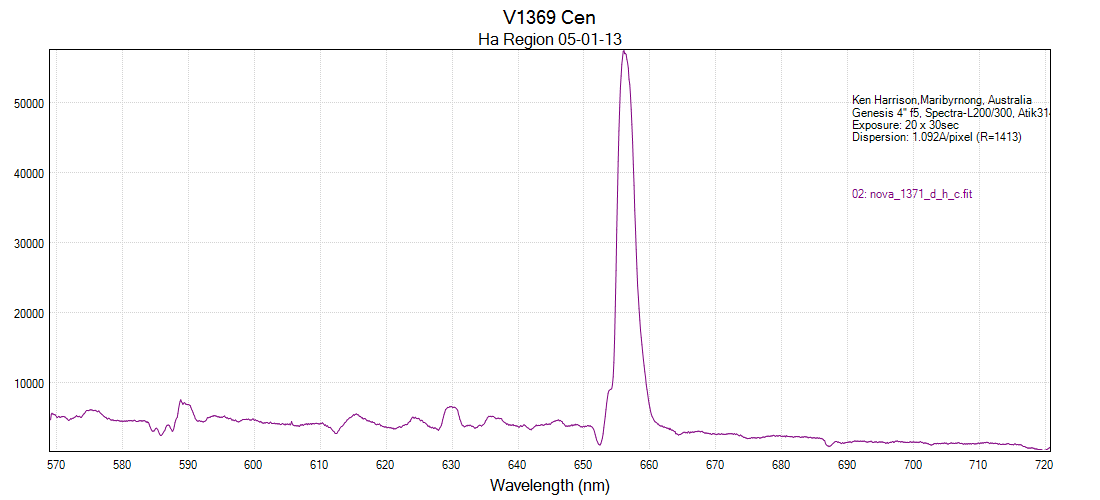

Sorry for the delay.

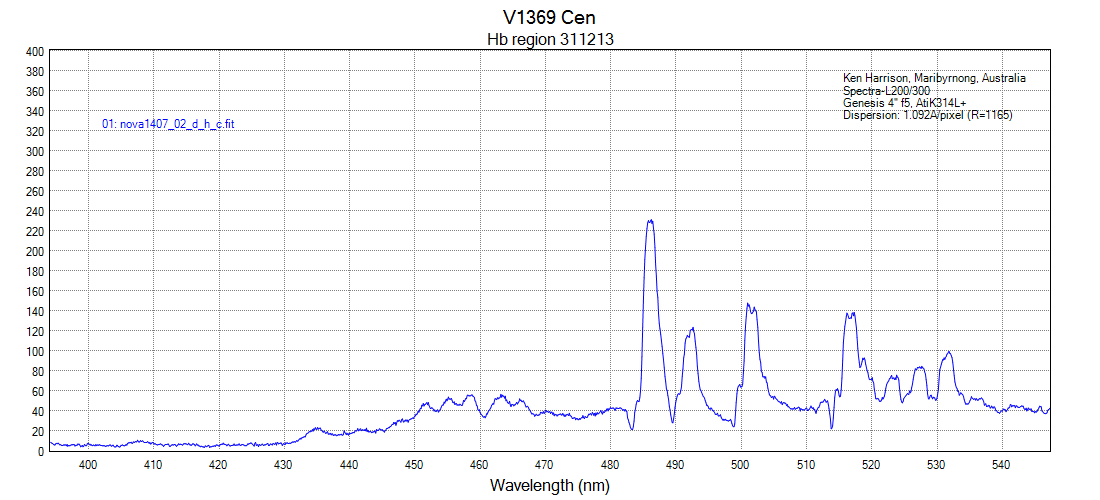

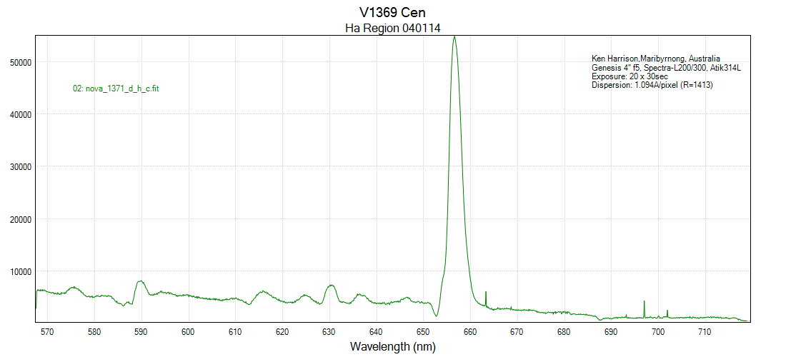

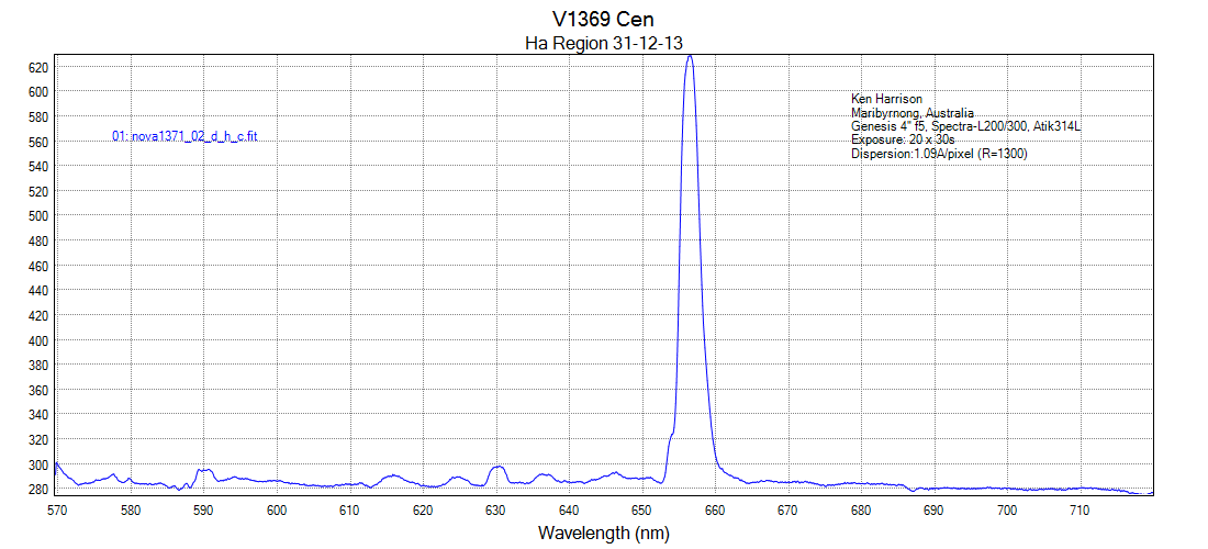

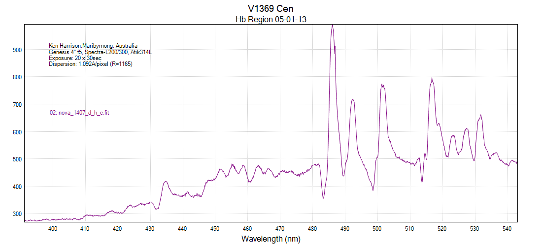

Here's a collection of the nova spectra from 31stDec, 4th and 5th Jan.
(Francois - I've sent you a fit file for evaluation - let me know)
nova Cen_Ha_311213.png (31.74 KiB) Viewed 21518 times
nova Cen_Ha_040114.png (32.27 KiB) Viewed 21518 times
nova Cen_Ha_050114.png (31.12 KiB) Viewed 21518 times

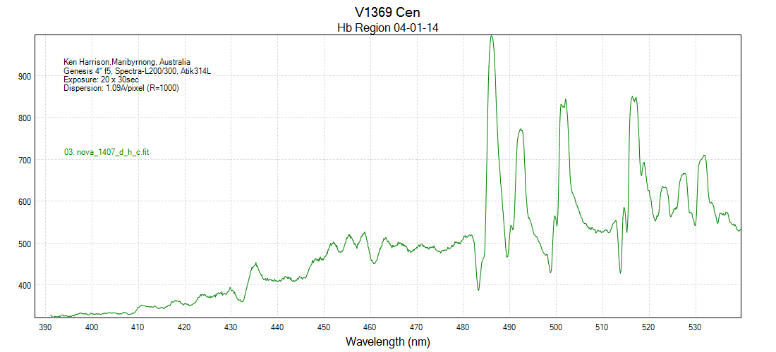

nova Cen_Hb_311213.png (35.08 KiB) Viewed 21518 times
nova Cen_Hb_040114.png (41.25 KiB) Viewed 21518 times
nova Cen_Hb_050114.png (40.95 KiB) Viewed 21518 times

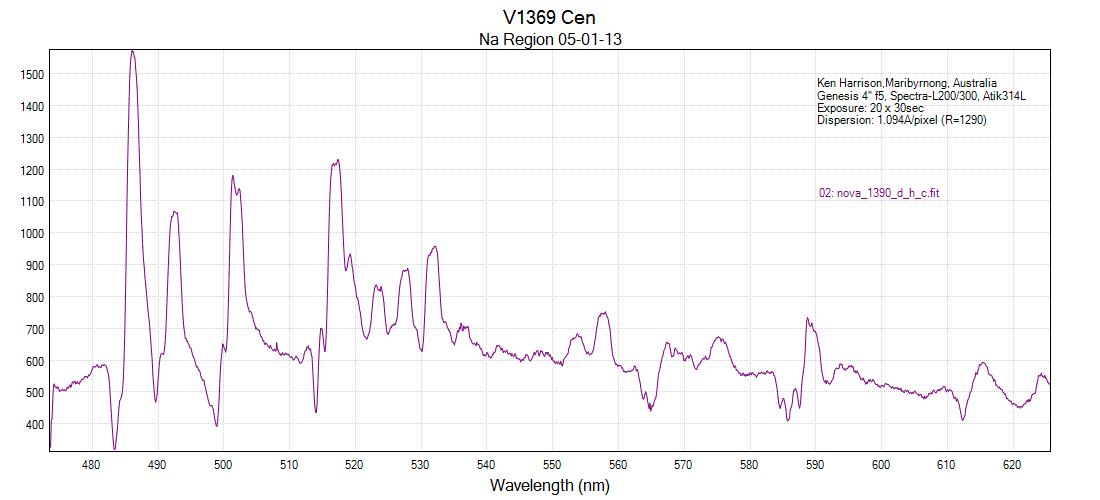

nova Cen_Na_050114.png (45.29 KiB) Viewed 21518 times

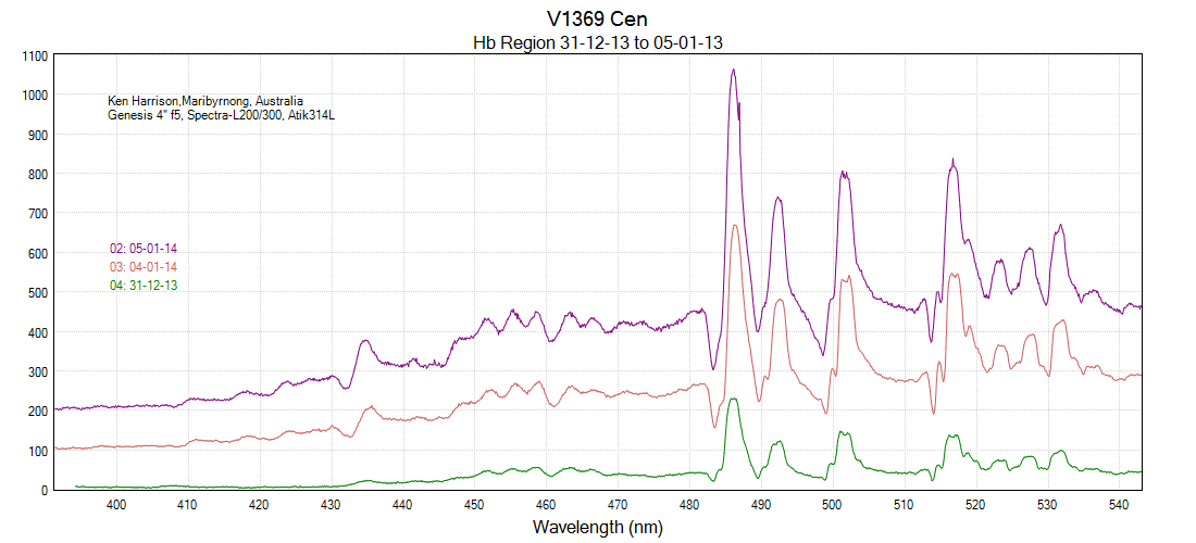

novaCen_Hb_3112to 050114.png (59.86 KiB) Viewed 21518 times

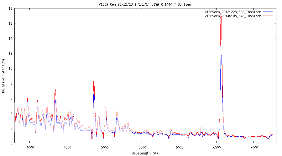

This is my effort from last night. V mag has dropped from 4.27 on 28/12/13 to 4.88 on 5/1/14
The new version of Isis makes flux conversion very simple. I get exactly the same result using the single step in Isis compared with doing the conversion manually.
Terry

Posts: 1955
Re: V1369 Cen
Hi Ken,
The apparent large increase at all wavelengths with time you are seeing in the Hb region looks rather strange compared with Terry's results which show only a small change over the same period. Your results almost look as though they are scaled relative to each other. How are your results plotted? Are the different days plotted with an offset ? (are they relative flux, absolute flux, raw counts? instrument response corrected?)
This could be a good opportunity to verify if the new BASS software produces reliable quantitative results. It would be interesting to see yours and Terry's data processed with both ISIS and BASS
