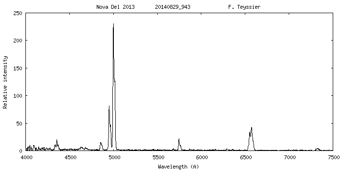

Posts: 1565
Nova Del 2013 one year
A spectrum this night
Only 1200 secondes exposure before clouds arrive.
One year and a few years after the outburst
