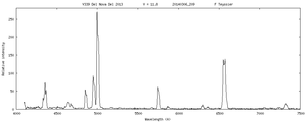

My first spectrum for this new saison
Only 4 exposures of 300 seconds each binning x 2
The AAVSO V Mag is 11.8
Impressive [O III] lines
Note that He II 4686 is now well detached
Spectra on :
http://www.astrosurf.com/aras/Aras_Data ... 2013_2.htm

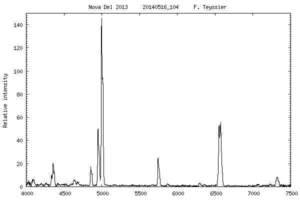

Today's spectrum

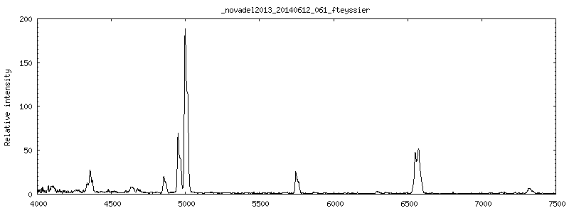

13-06-2014 spectrum
