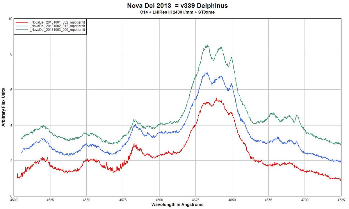

Is there a particular address to which I need to send spectra for inclusion in the database? I'm guessing that since these would be my first contributions that someone would want to validate the format, make sure I got the keywords in the header correct and so on. I did read the "BeSS FITS Definition" pdf document - I just don't know where or to whom I should send the spectra. Here's three nights of data in the 4500-4700 region using the LHiRes_2400 and a C14 from here in nicely polluted Baltimore skies!

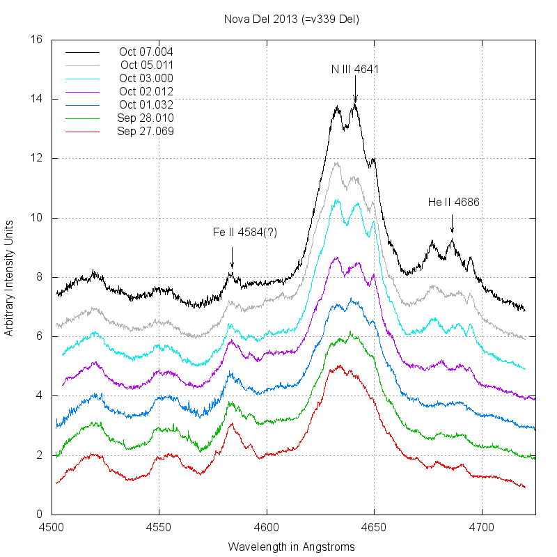

We've had a nice stretch of mostly clear nights lately so I've been able to get spectra on seven of the past eleven nights. Nice triple peaks on both N III 4641 and He II 4686. Just a very crude measurement of the blue and red-shifted peaks compared to the center gives an expansion velocity of about 550 km/s. Sadly the nova is getting fainter and I'm not likely to be able to get many (or any?) more spectra at this resolution. Not only that but I only have about three hours from the time it gets dark until the time the nova passes behind the maple tree in my back yard.

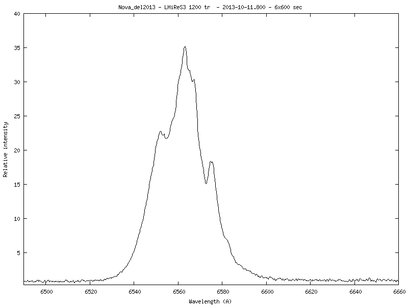

Change of spectrum aspect between 7 Oct and 11 Oct in flux unit (and log scale) - Alpy 600 spectrograph :
My most recent spectrophometric measure 11.892 Oct 2013:
B = 10.254
V = 10.303
R = 8.915
For the first time the nova is most luminuous in B than in V.

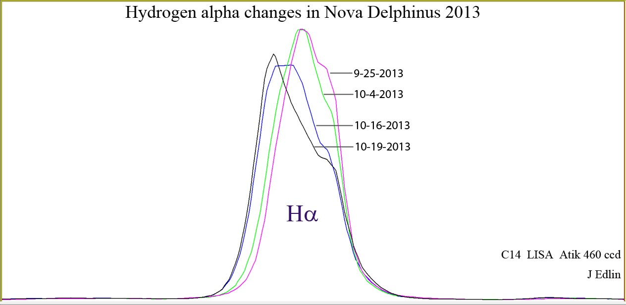

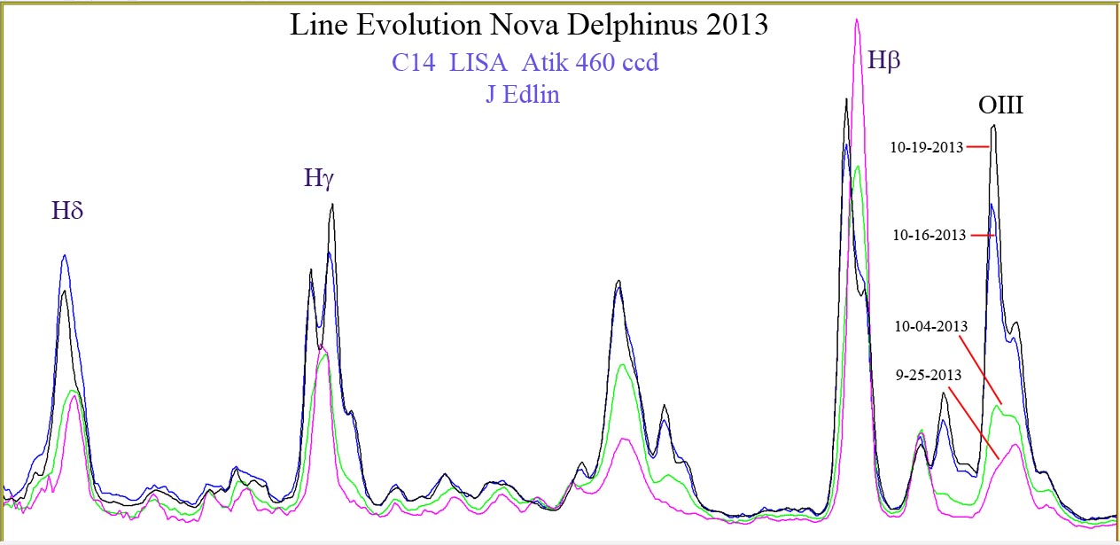

I have been following the nova as often as weather permits. The blue wing of hydrogen lines are evolving rapidly with marked blue shift. This was also noticed by Paolo. See my quick graphs from spectra over last 2 weeks. Very interesting changes!! These are from LISA spectrograph.
