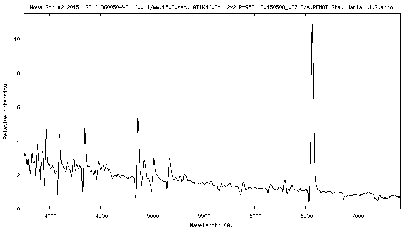

Re: Nova Sgr = PNV J18365700-2855420
Hi:
The Nova Sgr#2 2015 in the last night.
J.Guarro.
J.Guarro.
- _novasag#22015_20150508_087_J. Guarro.png (5.71 KiB) Viewed 11411 times

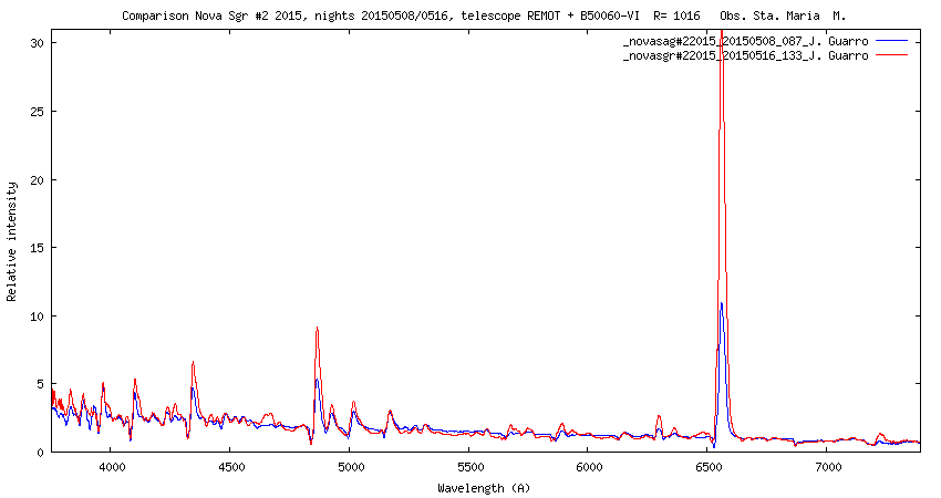

Hello:
Small variations in Nova Sgr 2015 # 2.
J.Guarro
J.Guarro
- _NOVASGR#22015_0508-0516.png (6.66 KiB) Viewed 11348 times

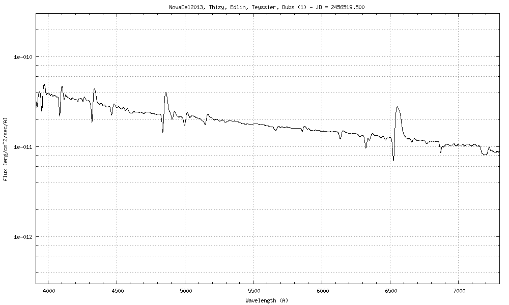

Hi Robin,
this looks similar to NovaDel2013, where about a month after peak magnitude this line appeared also, as can be seen from this animation, basaed on spectra from the ARAS database http://www.astrosurf.com/aras/Aras_Data ... l-2013.htm: Notice that the flux scale is logarithmic, quite useful for the spectra with large variation in flux. Robs asssignment to the NIII line at 4638A seems reasonable, maybe Francois can tell more about it.
Regards, Martin
Regards, Martin
- Posts: 1565
This is the 'N flash'. A blend of NIII/CIII from 4640 to 4660
Ionization is increasing as the ejecta becomes thin for UV.
In the red edge of the blend will appears He II 4686
See http://www.astrosurf.com/aras/novae/Nova2013Del-2.html
Spectrum of 05-09-2013
This blend also appears in C.V. in outburst.
That's rightRobs asssignment to the NIII line at 4638A seems reasonable, maybe Francois can tell more about it.
