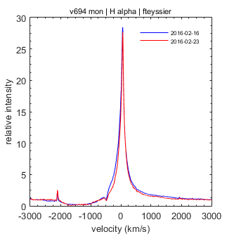

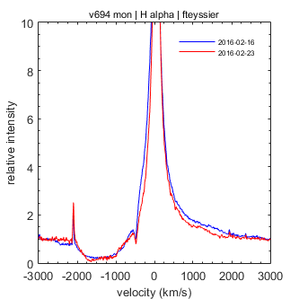

Variation of H alpha line
16-02-2016
23-02-2016
_v694mon_20160223_835_H alpha_1.png (13.68 KiB) Viewed 10168 times
crop
_v694mon_20160223_835_H alpha_2.png (14.03 KiB) Viewed 10168 times

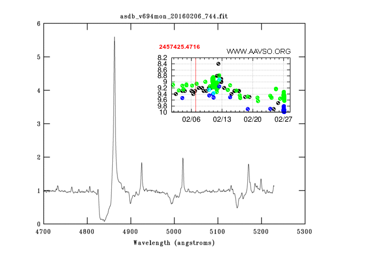

Re: v694 Mon
Let me present all my recent observations (including 3 new ones) around H-beta, together with acquiring data from AAVSO (putting together as an animated gif):
As you can see, only the three Fe II multiplets absorption seems to be changing (and line intensities).
Note: I have noticed a wavelength calibration problem - was using wrong calibration line on the right edge (asdb_v694mon_20160206_744, asdb_v694mon_20160211_884) - will send the fix together with the new spectra to the database soon. On this movie, the fix has already been applied.

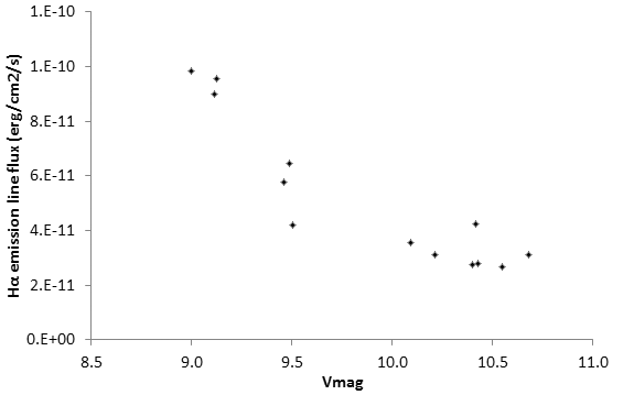

H-alpha flux vs V mag.png (7.96 KiB) Viewed 10122 times
This graph shows how the H-alpha emission line flux has varied with V magnitude as V694 Mon brightened from 10th mag in early 2015 to 9th mag in early 2016. The H-alpha flux increases by a factor of ~4, the same as the increase in the flux of the star.

Nice results and analysis
I took them for the next letter
David, could you show the evolution according to JD ?
Peter, should be interesting to produce measures of the intensities (EW)

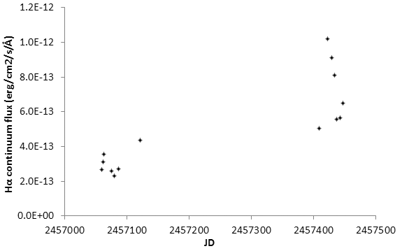

H-alpha flux vs JD.png (9.11 KiB) Viewed 10085 times
Hello Francois,
Here is the variation of H-alpha flux with JD.
Best wishes,

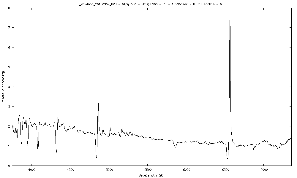

Bonsoir à tous, voici le profil de l'observation de 02/03/2016.
Profilo V694 Mon.png (7.25 KiB) Viewed 10054 times
Salutations Umberto
Re: v694 Mon

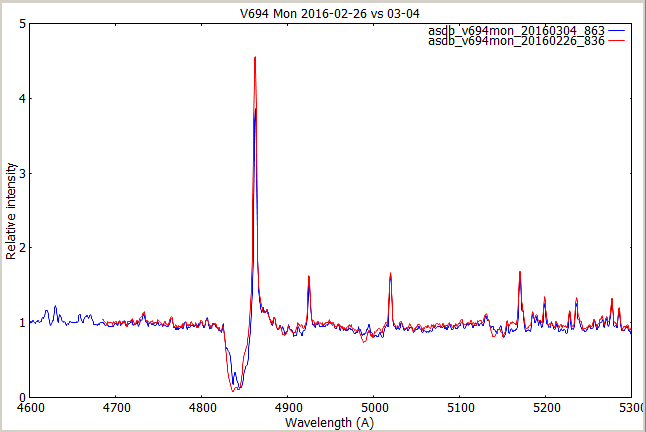

Yesterdays state (4 x 10 min, R~1900):
Absorption shiting to red. The rising spike at 4838.34A in the hole is visible well on all the raw images.
Interesting that the Fe II 4924A absorption looks changed differently than Fe II 5018A, 5169A, but maybe it's just a coincidence of changing there also something else.
Had no time to take any other region, veils closed in.

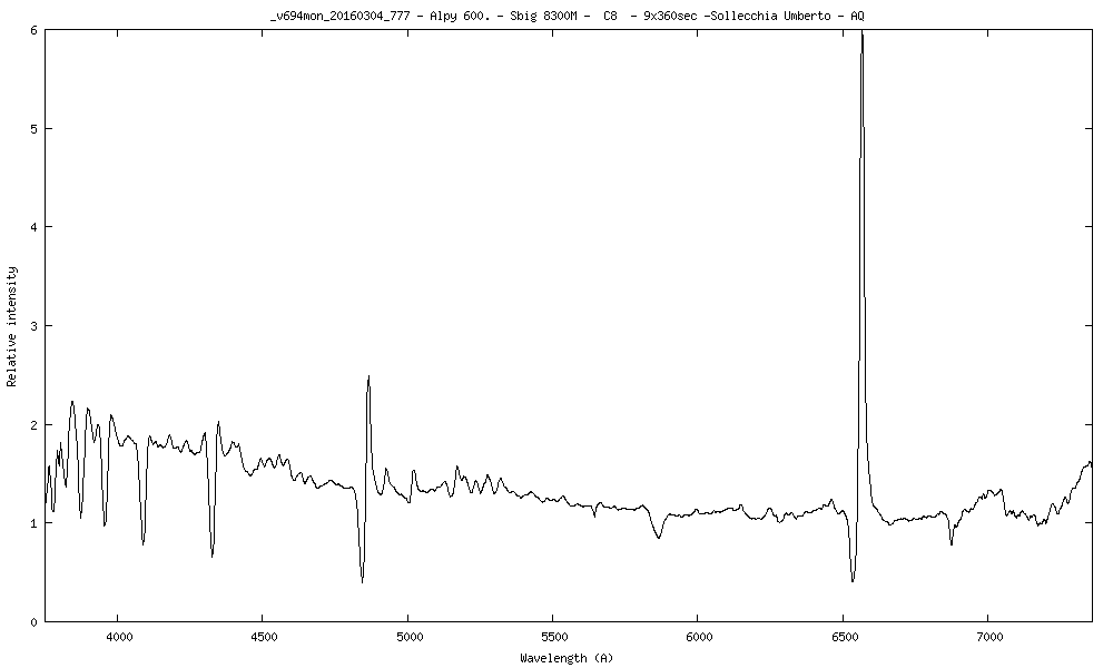

Bonsoir à tous, voici le profil de l'observation de 04/03/2016.
Profilo v694mon.png (7.42 KiB) Viewed 10015 times
Salutations Umberto
Posts: 1565
Re: v694 Mon
Hi Peter,
The faint emission in the absorption (or lack of absorption) seems interesting
The star is like a geyser : all moves before the eruption
Fe II : these are the 3 lines of a multiplet. To my knowledge, they must have (approximatively) the same behavior.
Umberto : nice !

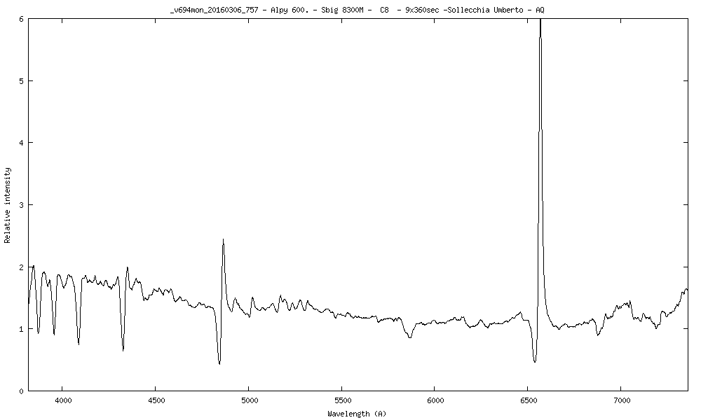

Posts: 247
Re: v694 Mon
Post by umberto sollecchia »
Bonsoir à tous, voici le profil de l'observation de ce soir 06/03/2016.Le P Cyg était légèrement ouverte
Profilo v694mon.png (7.38 KiB) Viewed 9988 times
Cordialement umberto
