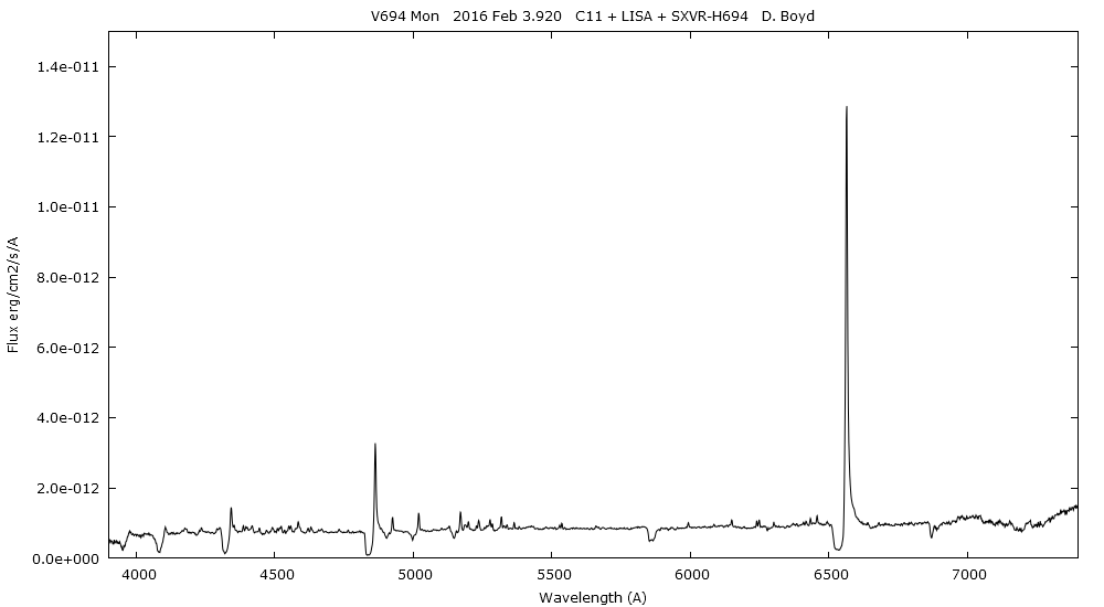

David Boyd
Posts: 164
Re: v694 Mon
Post by David Boyd »
Here is a spectrum of V694 Mon taken last night 3rd February starting at 22.00 UT. Its magnitude measured simultaneously with the spectrum and used to flux calibrate was V=9.12, almost 0.4 mag brighter than 2 weeks ago. There are strong P-Cygni profiles on all Balmer lines reaching a blue-ward extent on H-alpha of ~2500 km/s relative to the peak of emission. Spectrum sent to the database.

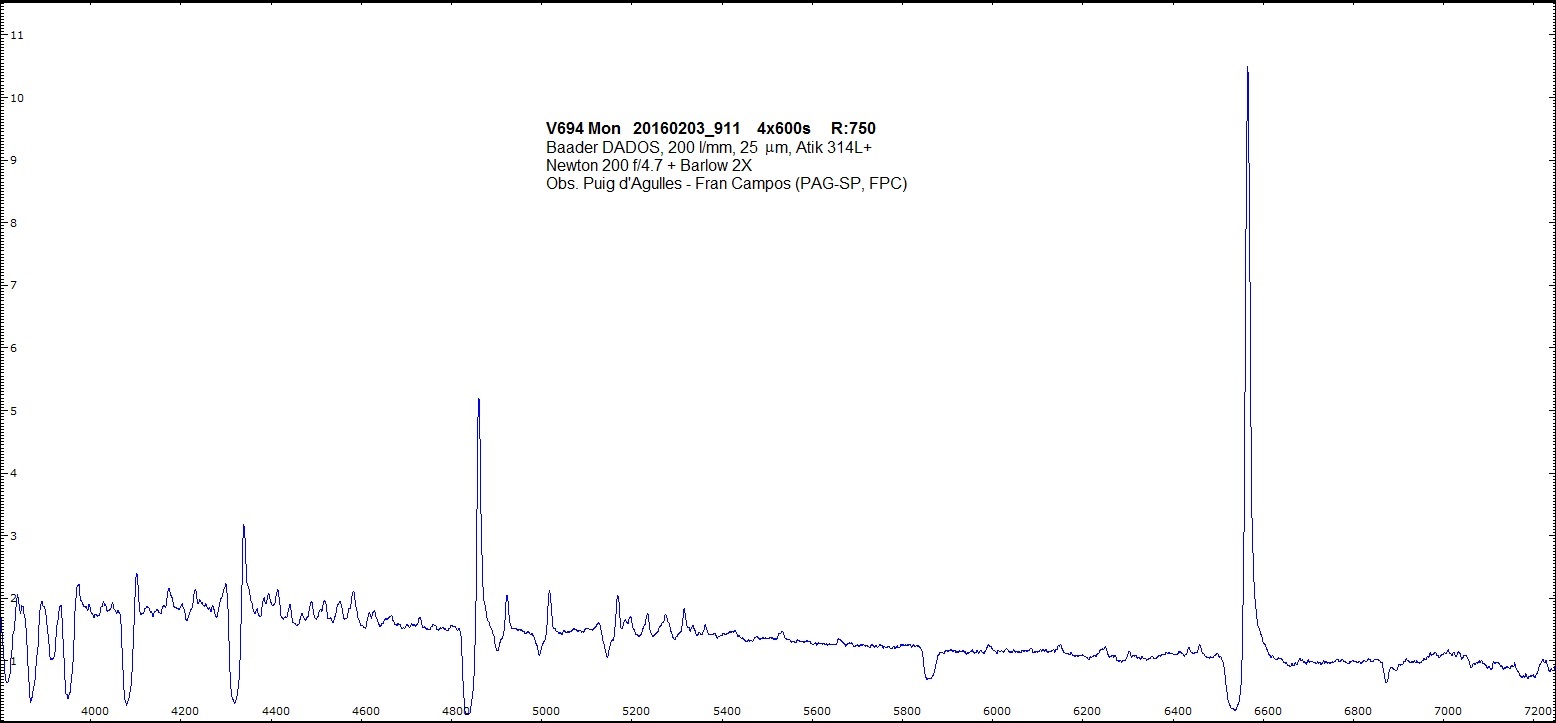

Francisco Campos
Posts: 88
Re: v694 Mon
Post by Francisco Campos »
the promised spectrum taken yesterday. The resolution is not as good as David one's (good job!), but happy to see how the DADOS works:
I have calculated Doppler shifts for the main Balmer bands, but my results are considerably lower than David one's: 1300-1600 km/s. Difficult to measure, due to the very broad absortion peak.
Greetings
Fran

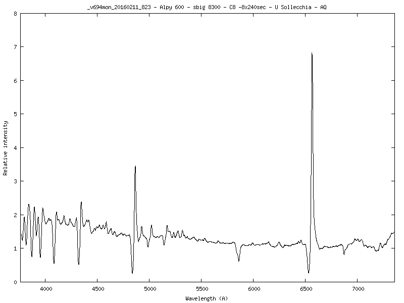

Posts: 247
Re: v694 Mon
Post by umberto sollecchia »
Bonjour à tous, voici ma contribution.
Profilo v694mon.png (5.53 KiB) Viewed 21699 times
cordialement Umberto

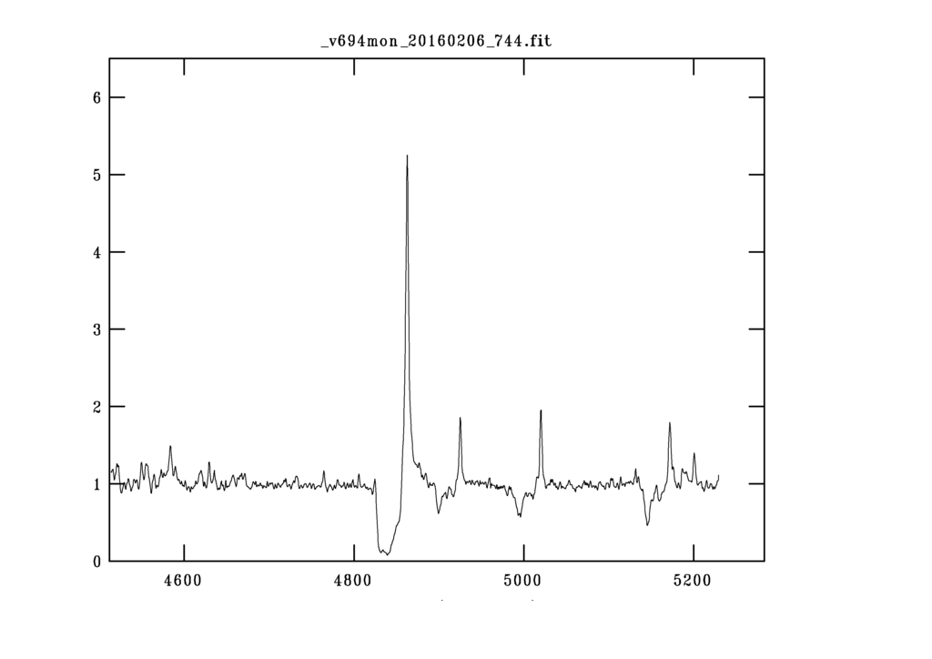

Posts: 578
Re: v694 Mon
Fran, thank you for reporting the outburst. My observations for February 2016, 5 and 6. H-alpha and H-beta. Lhires III 1200 & C9.25.
H-alpha region:
H-beta region:
Radial velocity of heliocentric corrected profiles (note there is a day apart):
With reference to classification by Iijima (2002), see ARAS Eruptive Stars Information letter n. 11 30/11/2014, it seems that at present there is no flat continuum between the absorption and emission components of H-beta line and the red side of absorption isn't steep. Furthermore, the blu-shifted absorption does not reach high velocities observed during the active stage. This should indicate that currently the star is in the stable stage (type A). Is it possible? I read that sometime the active stage occours without significant brightening in the V band, so the events are not always related.

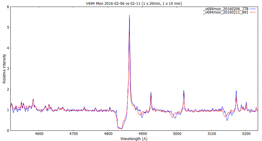

Re: v694 Mon
I was shooting it with Paolo in parallel on Feb-6 night at H-beta with 600/mm grating + 35um slit (somehow my coverage is also similar), but I was hunting for short-term changes, with per-exposure calibration before/after (using 2 ref. stars). First 2 x 20 minute were continuous, then the next 3 ones was 1 x 20 minute per each (shooting other targets in between), normalized for 4600-4800A:
It tells H-beta was definitely increasing, and maybe some other lines suspected for variation.
The velocities did not seem to change at this resolution, remained very much the same as Paolo published at H-beta.
Happy hunting!
- Peter

Posts: 247
Re: v694 Mon
Bonjour à tous, placez le profil d'observation de 11/02/2016.
profilo v694mon.png (6.08 KiB) Viewed 21481 times
Cordialement Umberto

Re: v694 Mon
Quick result from yesterday:
LHires III/600/35um/ATIK 414/25cm
All the 3 calibrations (ref.star/ArNe/flat) taken twice before and after again.
It is interesting that H-beta absorption had almost unchanged, while the multiplet to the right seemingly broadened by their absorb feature (look at the 3 peaks to the right)!
Does anybody know the name of that multplet?
