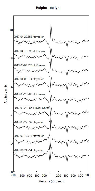

A comparison between 2 spectra taken about 1 month interval (28th march and yesterday).
H Alpha and H beta line intensity increase about 60% (corrected from heliocentric velocity)

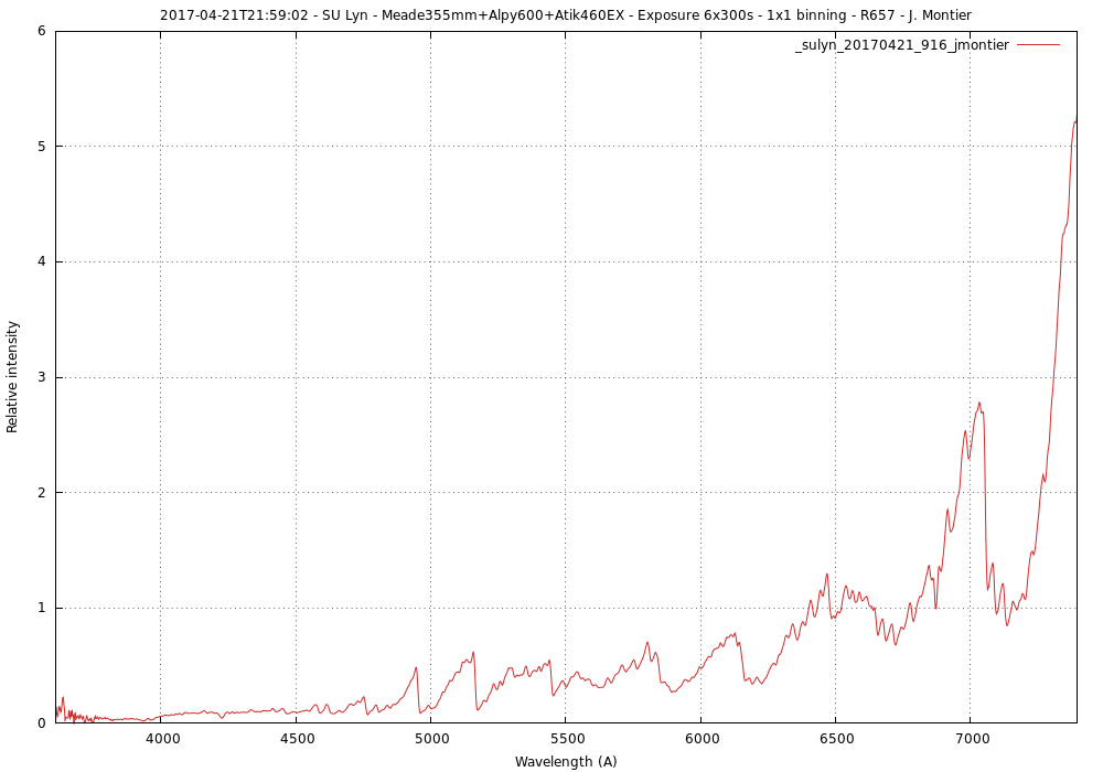

Re: SU Lyn Call for observations by Katarzyna Drozd
Post by Jacques Montier »
My contribution to SU Lyn
Regards,
Jacques Montier

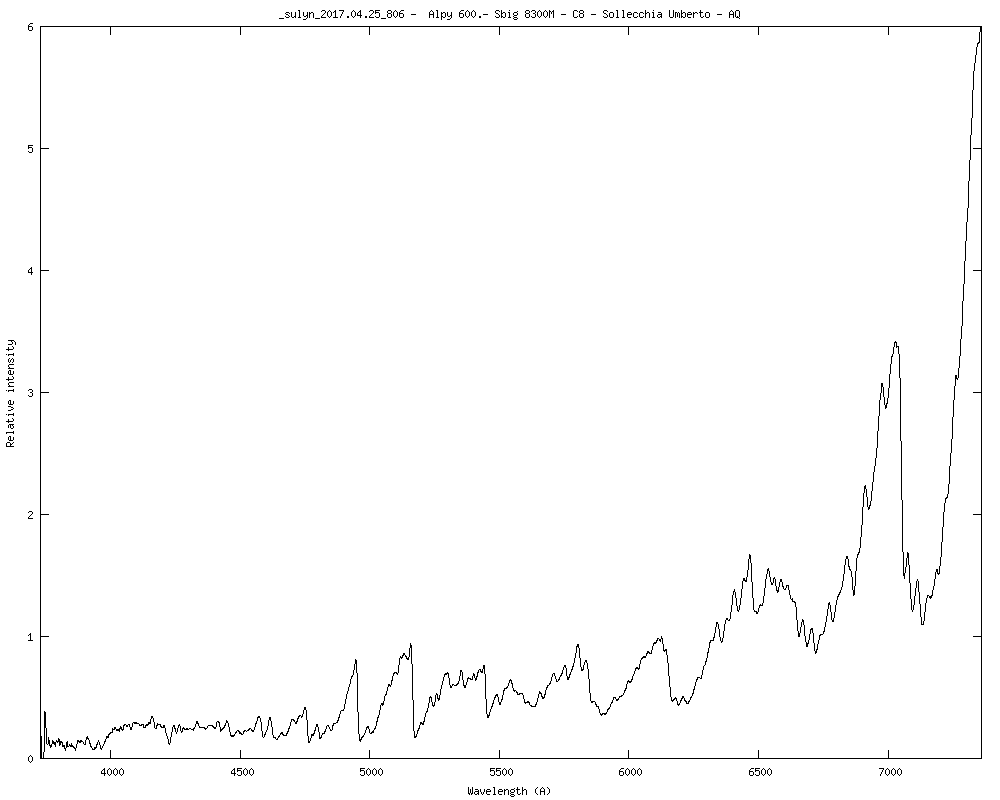

Post by umberto sollecchia »
Bonjour, mon observation de 25/04/2017.
Profilo SU _Lyn.png (8.02 KiB) Viewed 12658 times

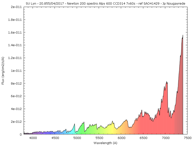

Post by JP Nougayrede »
Buongiorno,
SU Lyn en basse résolution le 20.8/04/2017, flux absolu, pour référence HD 50420 (V 6.15 à 5293A)
Bon ciel,
Jean-Philippe
Impeccable, Jean-Pierre, j'attends ton spectre pour la base
James:
- OK for the Ca II absorptions
- HI balmer exist but are not visible at such a resolution (for this star at this phase)
- The other identifications (Ca and Cl) are wrong
You have only the variations of the pseudo contnuum
Cl III is not a common line in symbiotics. It appears, faint, in some planetary nebula
Highly ionized Ca lines can be observed in some symbiotics but require higher resolution
For lines identification, I suggest you choose stars with strong emissions, such as AG Dra, CI Cyg, CH Cyg, BF Cyg ...

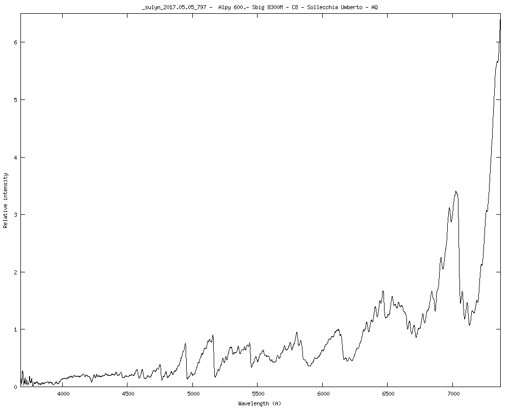

Bonjour à tous, placez l'observation du jour 05/05/2017.
Profilo SU Lyn.png (7.75 KiB) Viewed 12504 times

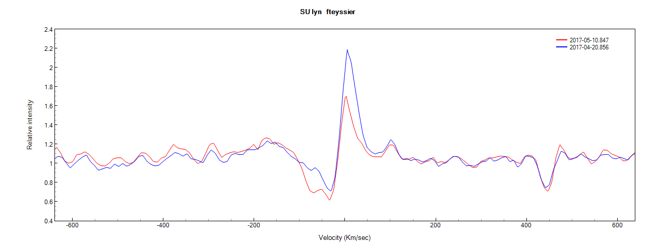

Posts: 1565
SU Lyn tonight
Impressive change in the absorption of H alpha
