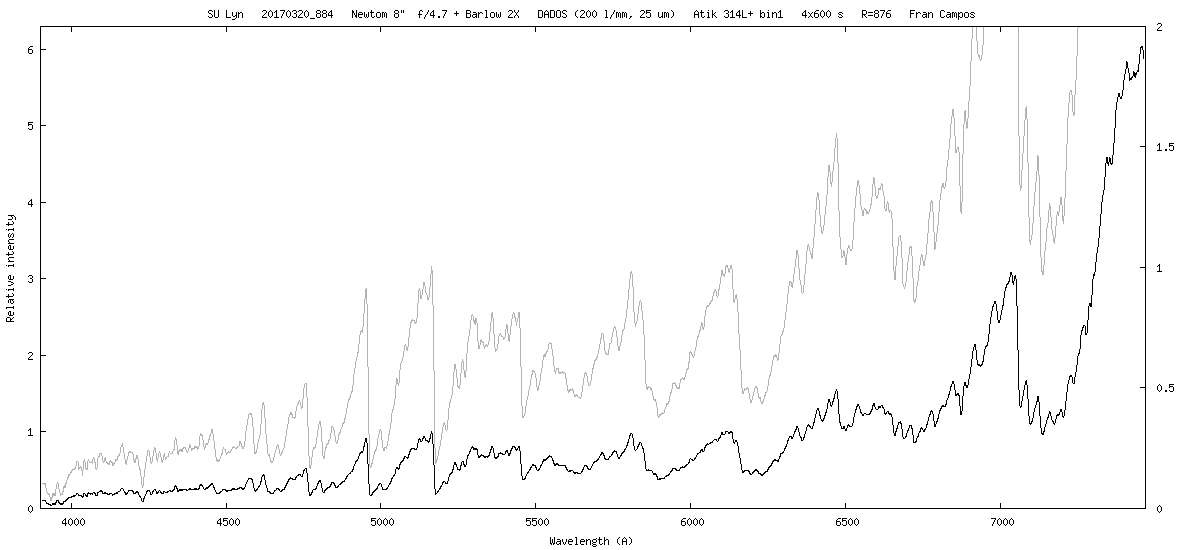

Ok, I will try to take a low resolution (R=800) and a medium resolution (R=6000) spectrum every month. For the moment, here is one taken five days ago.

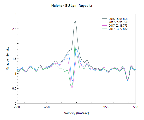

Here's a spectrum taken last night with eShel Spectrograph R=11000
The full spectrum (23 orders merged)
Order 34 (H Alpha line)

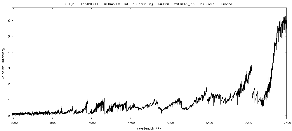

Is the SU Lyn, inthe night 2017 03 29.
J. Guarro.
J. Guarro.
- _sulyn_20170329_789_J. Guarro.png (7.16 KiB) Viewed 18016 times
