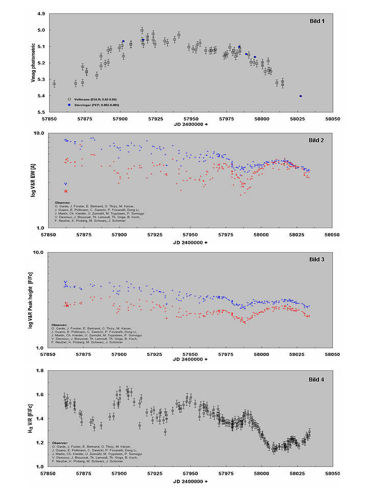

Dear colleagues,
I would like to inform you about the current state of the campaign:
The Hα components V&R in the emission strength (EW) (Fig. 2) and peak height (Fig. 3) show as expected the currently intensity decrease in analogy to the Vmag decrease (Fig. 1).
The eclipse of VV Cep has never been observed as dense as this time. Even if the variability of the fine structure of the Hα components shows an enigmatic behavior, this is the first time that this becomes apparent in this form.
How we have to understand this behavior in conjunction with the periodic precession of the disk rotation axis, as manifested in the V/R plot (Figure 4) is still unclear. It will be interesting to see how this dynamic looks, the closer the total eclipse comes.

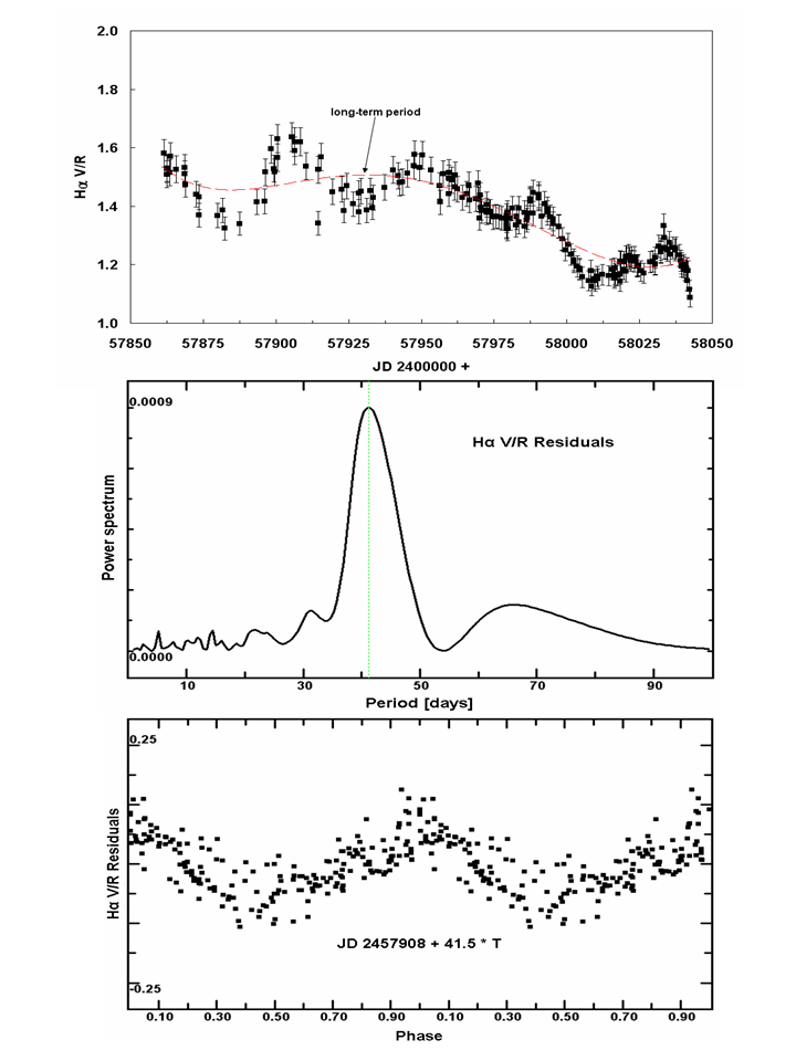

Dear colleagues,
here a sumary of the Halpha V/R periodic behavior.
Fig. above: V/R time series with a long-term period
Fig. middle: Scargle periodogram (power spectrum) of time series data subtracted by long-term period. Period = 41.5 days
Fig. bottom: Phase diagram of the 41.5 d period.
Interpretation: confirmation of nodding (precession) of the accretion disk? More data are required.

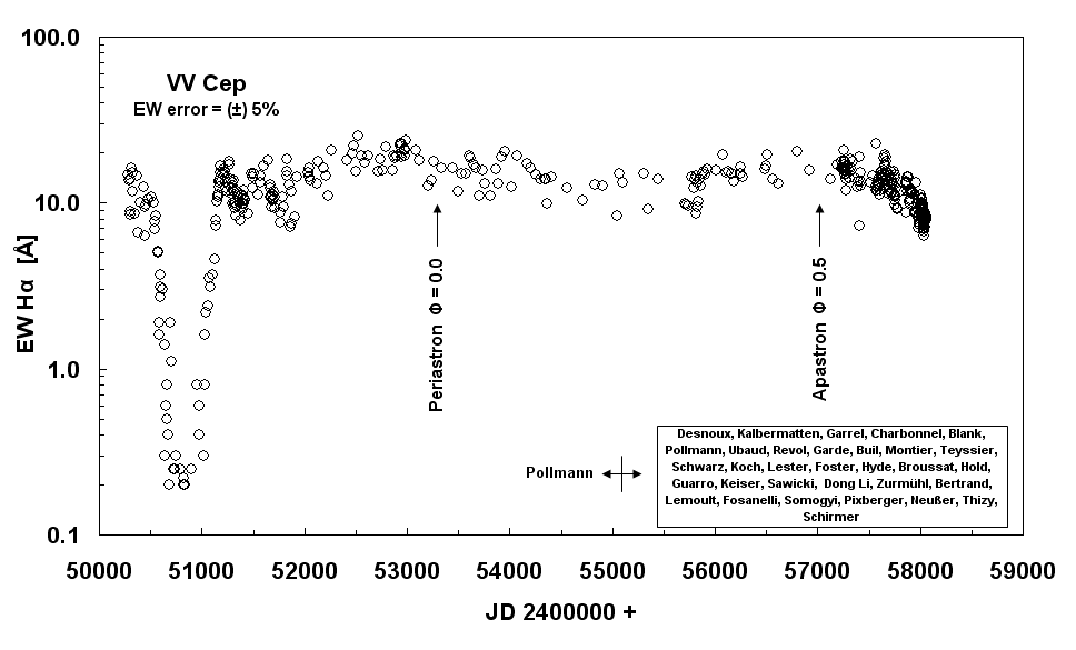

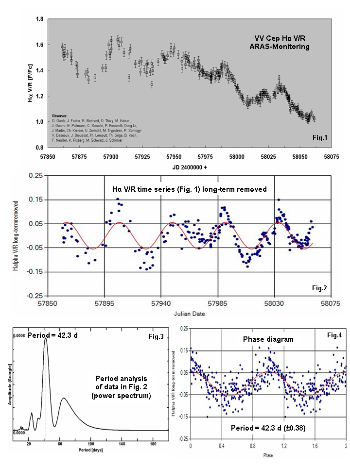

I would like inform about the current state of the Halpha campaign results:
Total monitoring of the Halpha EW:
V/R periodicity as indicator of precession of the disk rotational axis:
Comments are welcome!

Dear Ernst,
The more observations are appearing, the more our initial "hunch" of a possible wobble/precession behaviour can explain the course of the corrected V/R diagram.
The Scargle periodogram shows a significant cycle of approx. 41-42 days.
The small changes between the consecutive periods could be caused by accretion disc dynamics, as a result of unequal mass distribution.
Thermonuclear mini-bursts are probably absent as the light curve analysis doesn't indicate such a behaviour.
I think this is the first time report of such a detailed observation of this proposed behaviour within the VV Cephei binary complex.
Together with further professional teamwork results it deserves an interesting article for journals as A&A or AJ.
Perhaps attempts for synthetic spectra calculated by PHOEBE modelling would be also interesting to compare with our results.
Many thanks to all members/colleagues for their ongoing efforts, despite sometimes disappointing weather conditions.
To fully understand what happens more observations are needed.

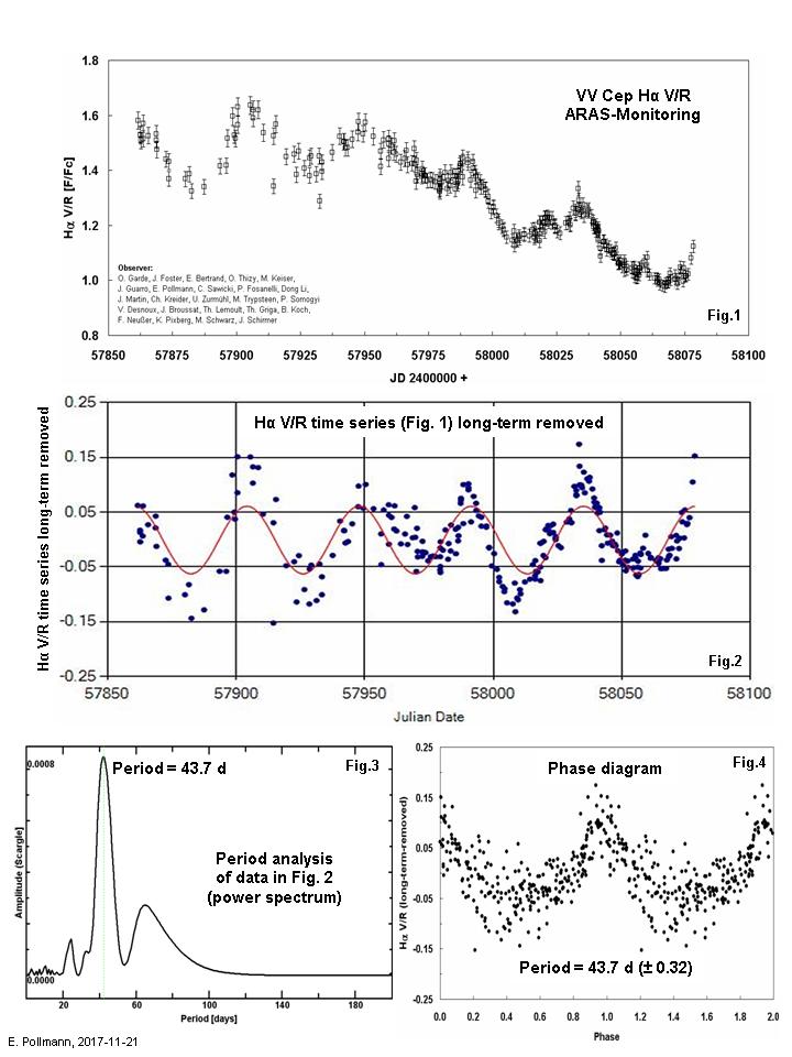

Dear colleagues,
in addition to the campaign state above, here the period analysis of the V/R oscillation. The fantastic high observation density enables to determine the periodic behavior more precisely. It is now 43.7 (+/-) 0.32 d.
It is great that some colleagues of the group have such high energy and obviously excellent observation conditions in order to contribute to this unique result.
