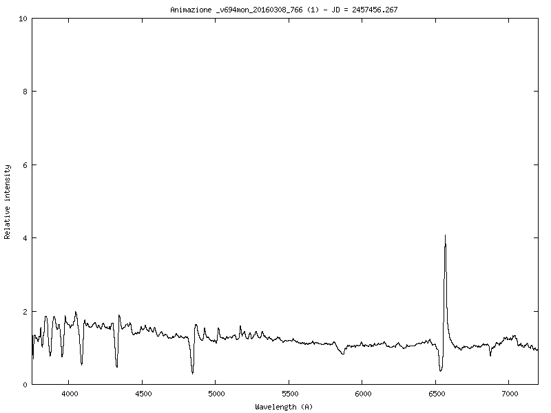

Bonjour à tous, un nouveau profil et l 'animation d'observation 03.08.2016.
Animation Salutations Umberto

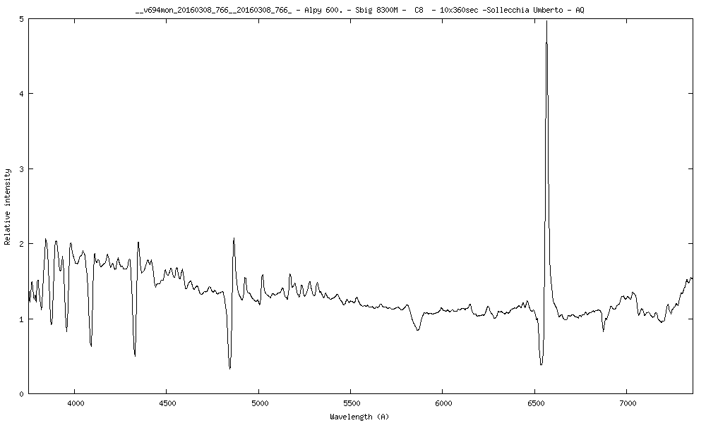

- Posts: 246
Re: v694 Mon
Bonsoir à tous, le profil de ce soir.
salutations umberto
salutations umberto

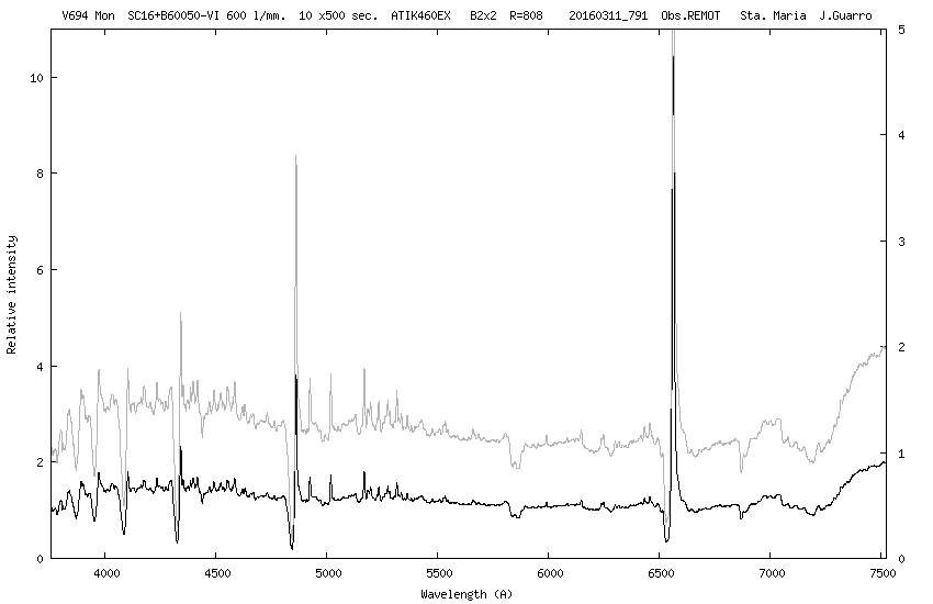

- Posts: 691
Re: v694 Mon
Hi:
It is also a graph of last night, which complements that of the Umberto.
Regards, Joan.
Regards, Joan.
- _v694mon_20160311_791_J. Guarro.png (9.23 KiB) Viewed 10790 times

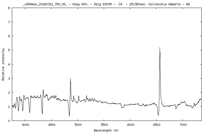

- Posts: 578
Re: v694 Mon
Hi Joan, Umberto and all. A mid-res spectrum for the same night (between many clouds...):
Plot of radial velocity:
It seems to me that maximum radial velocity has increased (~ -3000 Km/s).

- Posts: 578
Re: v694 Mon
Thank you François, Joan.
I add a H-Alpha Vrad comparison between 5 feb and 11 mar 2016.

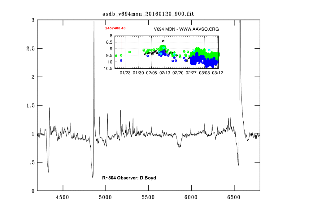

- Posts: 420
Re: v694 Mon
Nice series for the lores full spectra, ideal for a real data mining!
Just for my curiosity I've compiled a LoRes serie of v694 Mon picked every day, to get an insight what is changing and how does ARAS correlate with AAVSO.
Hope authors don't mind to publish such a compilation (2016.01.20 - 2016.03.07): This is the way I produced this animated gif:
- downloaded 22 spectra from here one by one via normal http, trying to cover the most interesting AAVSO-reported peak around 2016-FEB-11/12:
http://www.astrosurf.com/aras/Aras_Data ... 694Mon.htm
(at this time 2016.03.07 is the last downloadable)
- created continuum for each spectra via IRAF task 'continuum' with params:
sampling region: 3700:4800,5000:5800,5900:6400,6700:7200, order: 9, function: legendre, iteration: 100 (rejects outstanding peaks/holes)
- then divided each spectra by their extracted continuum
- generated AAVSO chart from http://www.aavso.org
- used ImageMagick to put aavso + annotate AUTHORs noting resolution at the bottom of pictures (and a set of linux commands, all free and opensource)
- of course, all thandled with my local script ecosystem...which is a set of random script stanzas in bash + IRAF commands I have gathered in the last 4-5 years + now.
Hope others find the animation useful for gathering insight what is changing.
Happy hunting!
- Peter
Happy hunting!
- Peter
