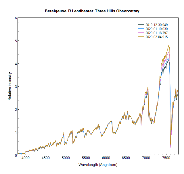

Here is my updated trend since the end of last year. The spectrum is still evolving in the 7400A region relative to 2020-01-18
(2020-01-10 was taken using the ALPY 200 so lower resolution, the others are with the ALPY 600 at R~500)
