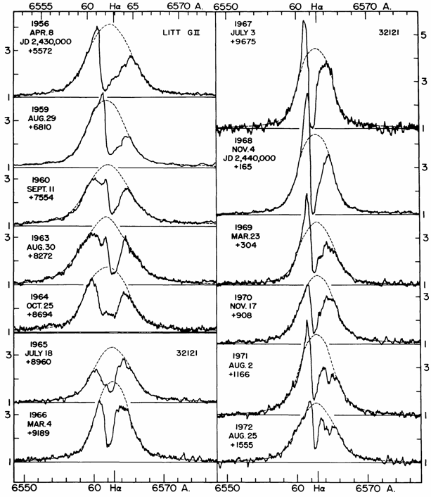

I want offer for discussion the following thoughts concerning the V/R variability in VV Cep:
The investigations of Wright (1977) show that the H-alpha emission component is formed within the accretion environment of the B star, as an undisturbed, intrinsic single emission (dotted lines in the following Fig.).
Fig. 1.png (157.9 KiB) Viewed 18934 times
After Wright the entire binary system is enveloped of a cloud of neutral hydrogen, which produces in the observers line of sight, a central absorption line in the Halpha emission center. For this reason this emission appears split into two components, the V and the R components.
Because of the orbital movement of the B star around the M star (the following Fig., above, RV curve), the H-alpha emission barycenter naturally follows the radial velocity of the B star. In other words, the intrinsic single Halpha emission and its components V and R moves back and forth behind the central absorption line, which leads to a periodic change of the V and R intensities, which is exactly what we have observed in our long-term V/R monitoring (following Fig., bottom).

Hello Ernst,
Looking at these graphs, H-alpha looks still rotational rather than coming from a bow shock: almost constant {height, width} of the approximated bell curve.
At least I would expect very different bell curves at phases {0, 0.25, 0.5, 1} (the random absorbtions appearing on top of the V peak can be ignored, that's a shortterm change I often saw in the UV end too).
But maybe you have better quality data from the recent decades to present here.

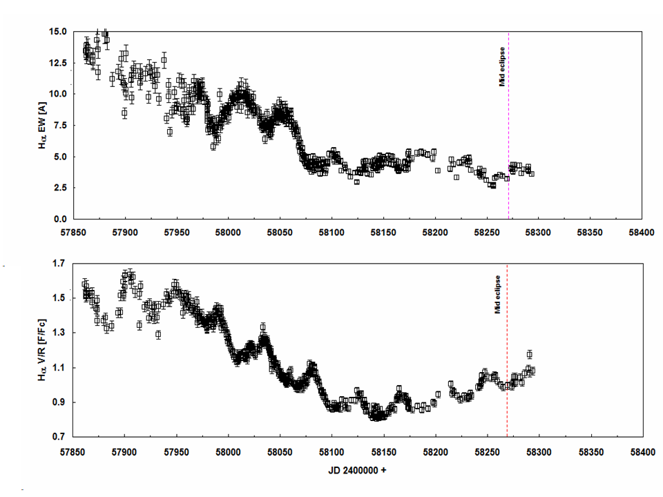

Dear colleagues,
after a long break here an information to the current state of our joint monitoring. How the variations of EW (plot top) and V/R (plot bottom) are to understand, we want to describe soon in a corresponding publication. Until then I ask still for some patience.
EW & VtoR.png (127.4 KiB) Viewed 18762 times

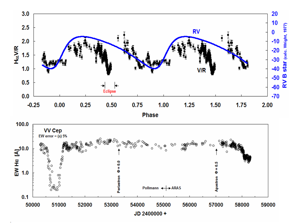

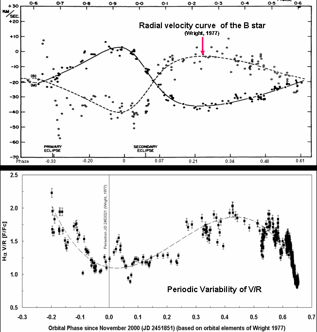

Dear colleagues,
here some further thoughts:
1) In our IBVS paper we wrote that Wright found that the emission centroid follows the velocity of the B star on its orbit. I have tried to confirm that with the attached Fig.(top). It shows at first on the right ordinate the calculated orbital radial velocity of the B star as blue curve.
I inserted in this diagram on the left ordinate our V/R monitoring since JD 2451413 (with T0 = JD 2438461 = time of periastron after Wright, 1977) but with - 0.15 shifted in phase. This process led to a very well accordance of both curves (subjective judged by eye). The amount of the phase shift comes from period changes since JD 2438461 (1964 March 06). This superimposed diagram might be used in order to confirm the statement of Wright.
2) The attached Fig. (bottom) shows that the Halpha EW of the current eclipse does not reached the depth of the 1997/98 eclipse. For my understanding this says that the "emission region" in the vicinity (or around ?) the B star is corresponding clearly smaller in size than during the eclipse 1997/98.
Because of this smaller size we have been able to find out the small precession period of "only" 43 days. This was not possible while the eclipse 1997/98 because of
- the use of a prism spectrograph with too low spectral resolution,
- too low observation density,
- a larger size of the "emission region (disk?)" and hence
- the (probable) corresponding much larger precession period.
Comments?

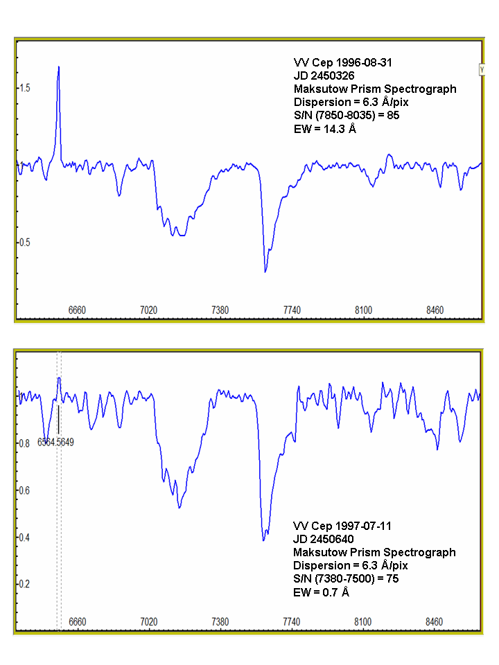

Hi Peter,
you wrote:
Looking the earlier H-alpha eclipse much deeper, it raises the need for a deeper historical investigations (e.g. depth of earlier eclipses? wasn't just the signal below a minimal SNR? ).
The attached two spectra (50326 out of eclipse and 50640 in eclipse) shows that in spite of the modest spectral resolution of the used prismen spectrograph, the Halpha emission was evaluable without any problems. The S/N with 75 to 85 was sufficient to determine the EW.
With other words:
there is not doubt on the depth of the 1997/98 eclipse.
Ernst
