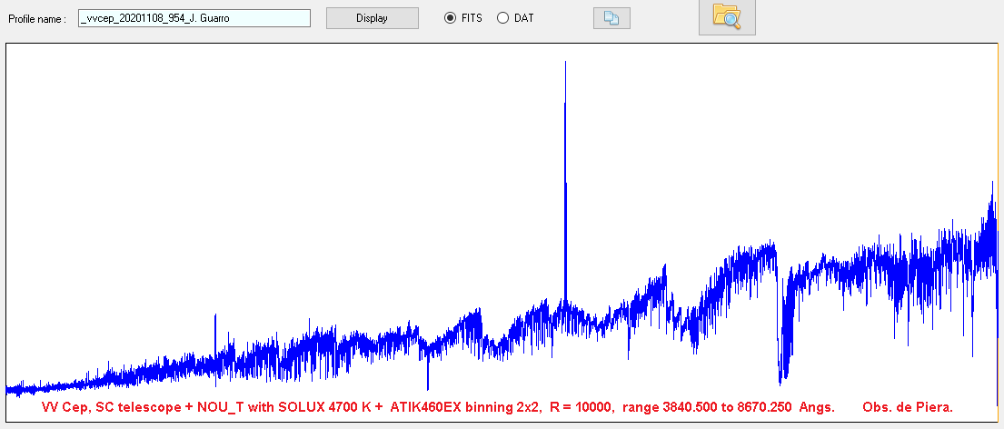

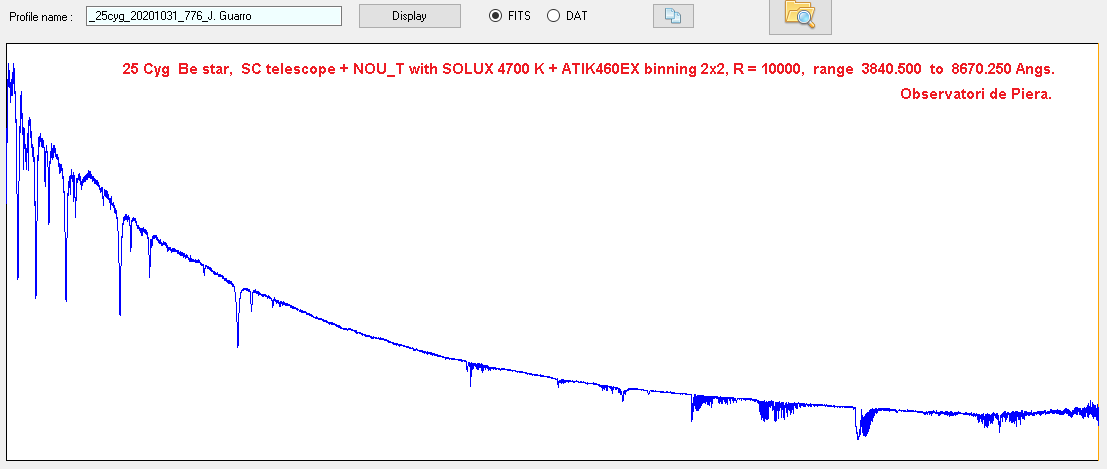

I show here four new graphics, the use of a SOLUX 4700K lamp has improved the results, I think the graphics are better now.
The other hand, in few months, two new NOU_T will be see their first starlight, one of them is for Santa Maria de Montmagastrell REMOT Telescope
and the other one is for the telescope of one member of this Forum. We hope that all will be right.
Greetings, J.Guarro.

- _47K_Ag Peg.png (13.25 KiB) Viewed 18486 times
- _47K_GAM CAS.png (14.91 KiB) Viewed 18486 times
- _47K_VV Cep.png (27.72 KiB) Viewed 18486 times

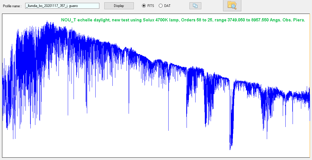

- Posts: 731
Re: NEW NOU_T ECHELLE RESULTS
Step by step, the NOU_T echelle is going to win some Orders and consolidate old ones.
The Solux lamp helped achieve this job. We will be able to see what passes in the sky tests.
You know that the best results of one set are as good as the more bad of their components.
There are things to improve yet.
Cheers, J.Guarro.
Cheers, J.Guarro.

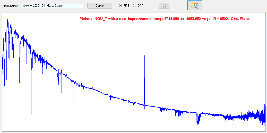

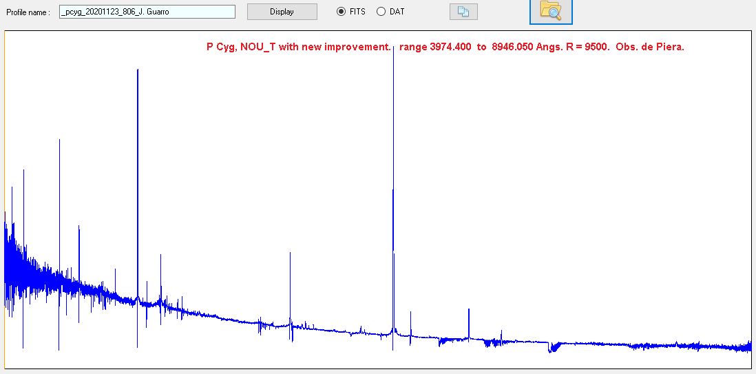

- Posts: 731

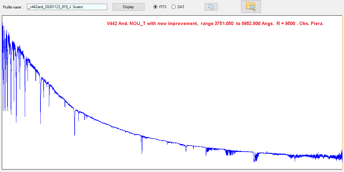

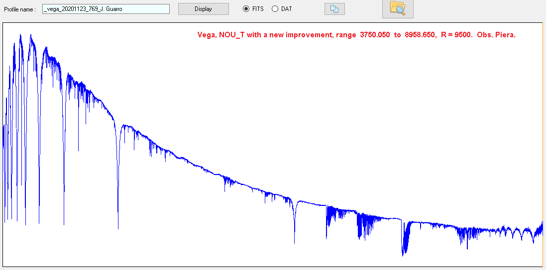

You can see here 4 NOU_T star graphics in the same night using the Solux 4700K Lamp and their possibility with one ATIK460EX with binning 2x2.
The P Cyg has short exposures due to strong emission H alpha and H beta lines, the result is a notable noise in its blue.
I think that it is possible to improve the graphics yet, we can hope to see the two NOU_T results in the next future, but also it is possible that the worst element there is the ATIK camera now..
Cheers, J.G.
Cheers, J.G.
- Vega20201123.png (21.47 KiB) Viewed 18346 times
- P Cyg20201123.png (19.15 KiB) Viewed 18346 times
- Pleione20201123.png (21.77 KiB) Viewed 18346 times
- V442 And20201123.png (16.69 KiB) Viewed 18346 times

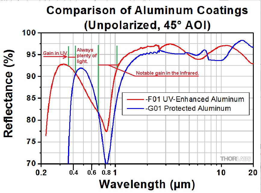

The second NOU_T for SMM has an advantage over the Piera one, because it has UV-Enhanced mirrors, ( see the graphic ), if you have in mind the CCD spectral response you can note that is the reason because the second NOU_T is better in the infrared. I will change the mirrors of the first one.
It has passed me sometimes that, you have one thing opposite at your nose for a long time and you never have see it. Well, I have realized that I can improve the Alan Gee Mark II Telecompressor position, after a lot of time, I achieve a F=5.6, the NOU_T can works very well on this relation, it gain about 35% more brightness. I can apply it at SMM telescope.

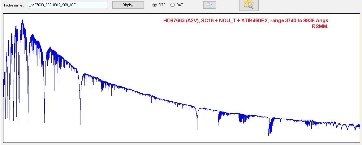

- Posts: 731

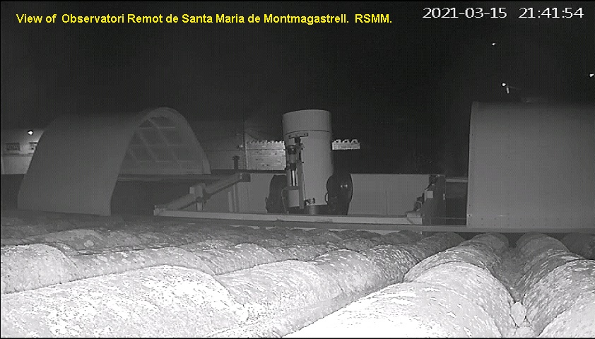

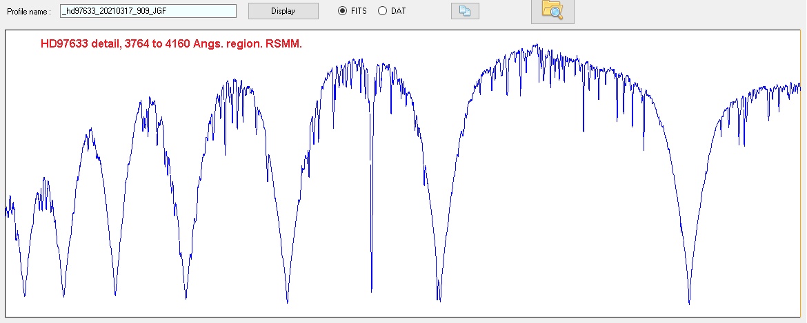

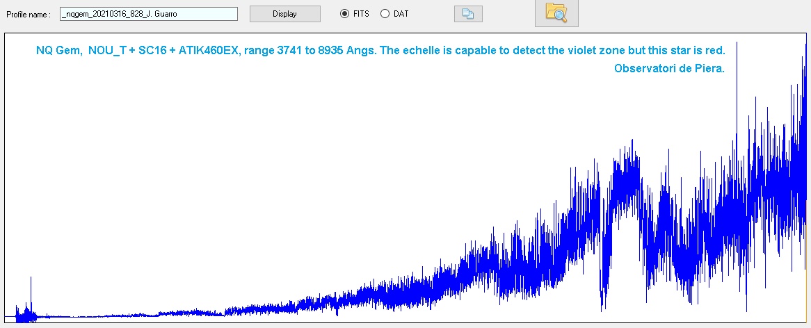

At "Observatori de Piera" I have changed the mirrors of the NOU_T echelle for another UV-Enhanced aluminium ones,also I have mounted the same mirrors in other NOU_T for the " Remot Observatori de Santa Maria de Montmagastrell". ( RSMM).
Despite the bad weather I have been able to start to test these two echelles, and using these new mirrors the improvementis notorious. I leave here some results.
I hope that the good weather comes soon..
Cheers, J. Guarro.
Cheers, J. Guarro.
- 20210316_NQGEM.jpg (120.42 KiB) Viewed 16270 times
- RSMM.jpg (163.35 KiB) Viewed 16270 times
- 20210315_HD97633.jpg (89.61 KiB) Viewed 16270 times
- 20210315_HD97633_1.jpg (100.67 KiB) Viewed 16270 times

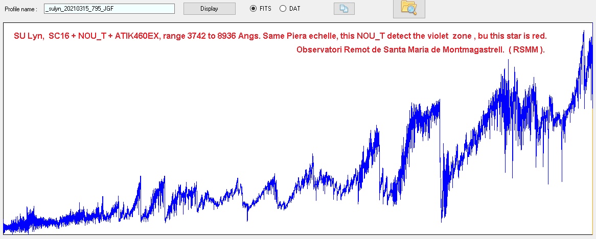

- Posts: 731
I forgot to send this SU Lyn yesterday,
J.G.
J.G.
- 20210315_SULYN.jpg (131.09 KiB) Viewed 16245 times

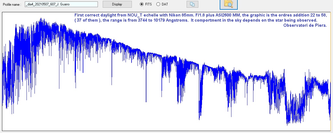

After a long time, can show you the first test of the NOU_T with the ASI2600MM. I hope that after unusual bad weather months I will show
you the first star graphics.
Regards, J. Guarro.
Regards, J. Guarro.
- _ASI PROVA 1.jpg (161.49 KiB) Viewed 15496 times
Superb results Joan. 16 bit CMOS spectroscopy has arrived!
You still use the 85mm lens here, how does the camera handle a longer lens?
