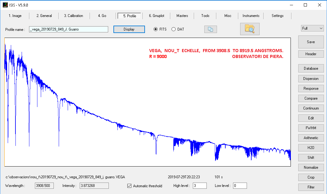

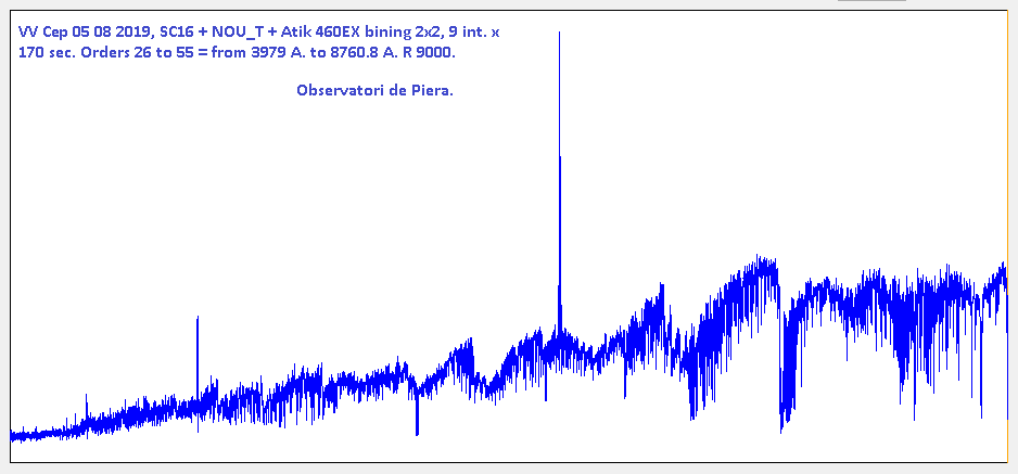

NEW NOU_T ECHELLE RESULTS

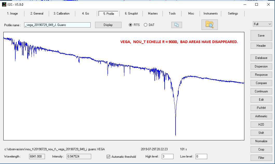

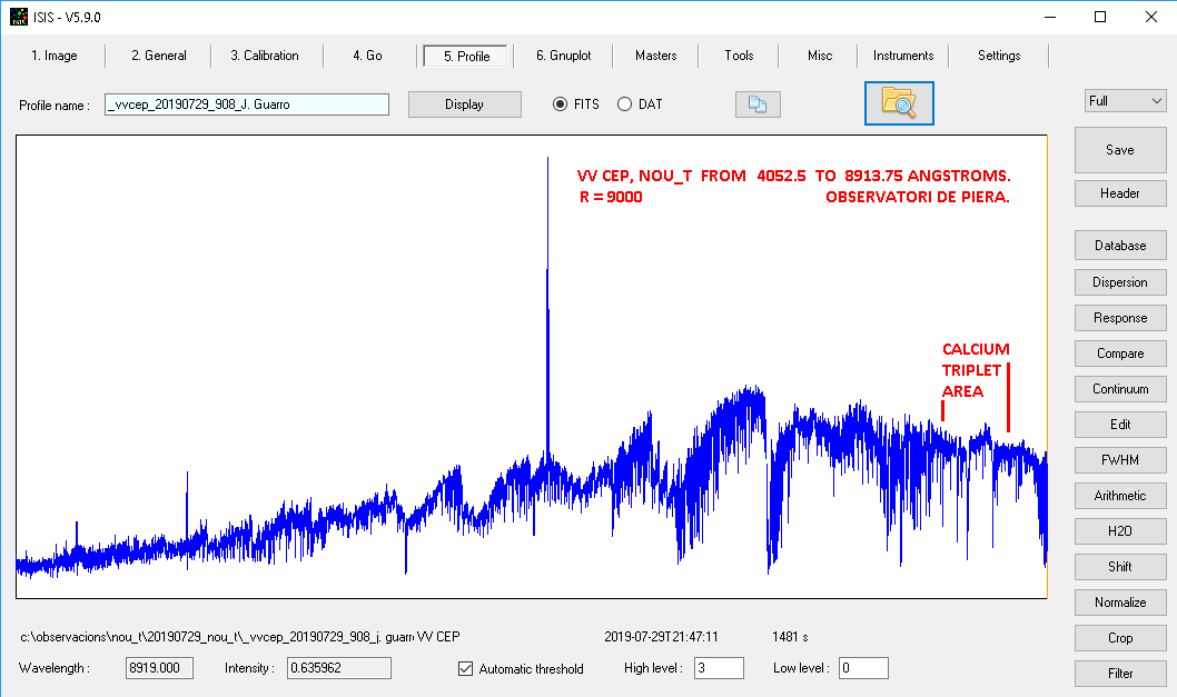

Slowly I'm improving the results of my new NOU_T echelle. I'm showing you two test stars at last night. 20190729.
Friendly, Joan.

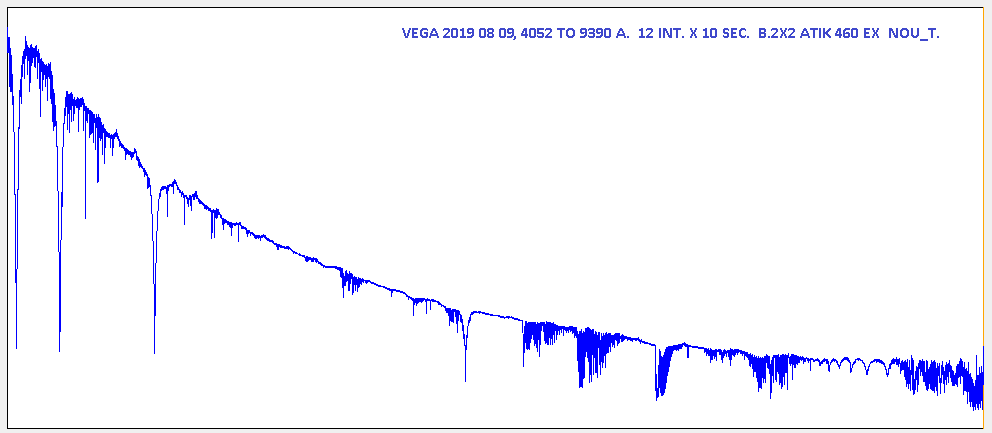

- Posts: 731
Re: NEW NOU_T ECHELLE RESULTS
send results to last nigth, although I have some problems with the software I think NOU_T it's ready for work.
It's working well in the ordres 56/55 to 26, from 3910/3980 to 8670 Angstroms. I was very worry with his mechanical stabilty but I'm calm about it when I've seen desplacements = 0 in X and Y in the ccd image after the tour for these four stars.
The big dinamic rang it's due that using mirrors instead of achromatic lenses, with restes of chromatic aberration in them, and the Nikor objective 85mm. F/1.8 it has a aspheric lens and one compromissed focus between all his Orders. I don't want the best focus only for concret Orders, if not, the best relation between all of them.
I see that NOU_T it's better than the MUSSOL and LINX it has bigger dinamic rang and without optical fiber nor the fiber agitator indispensable for relation focals more longer than F/4 .
NOU_T it's arrived to stays here.( If I don't wrong ).
See you, Joan.

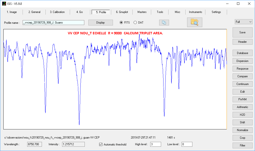

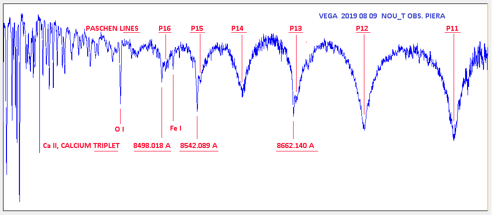

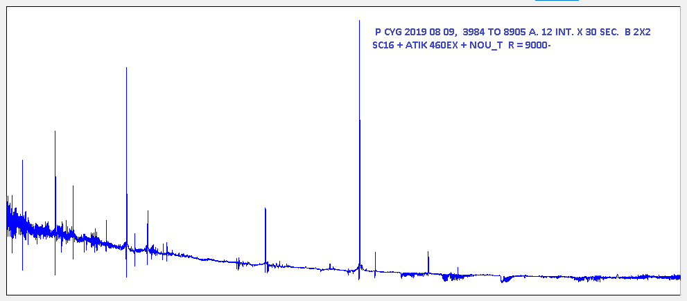

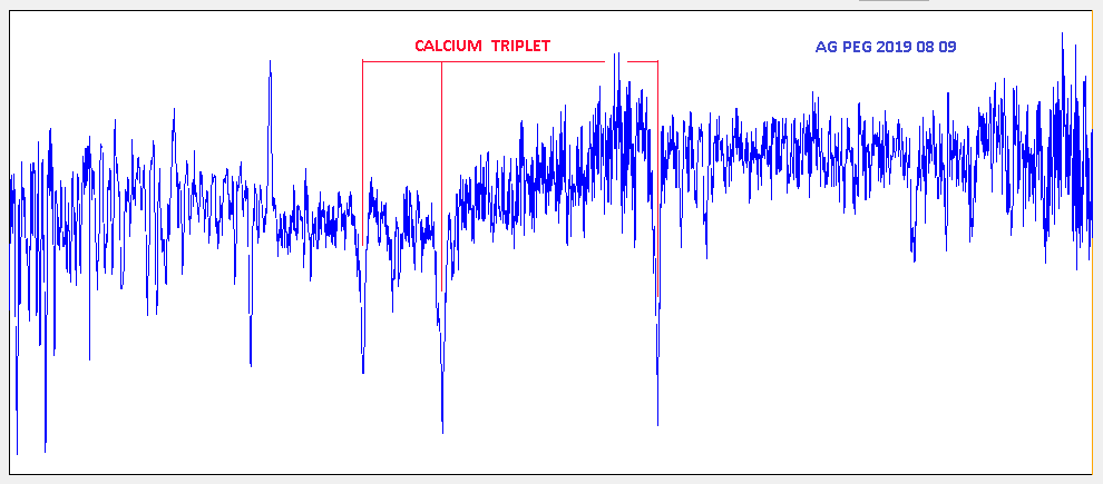

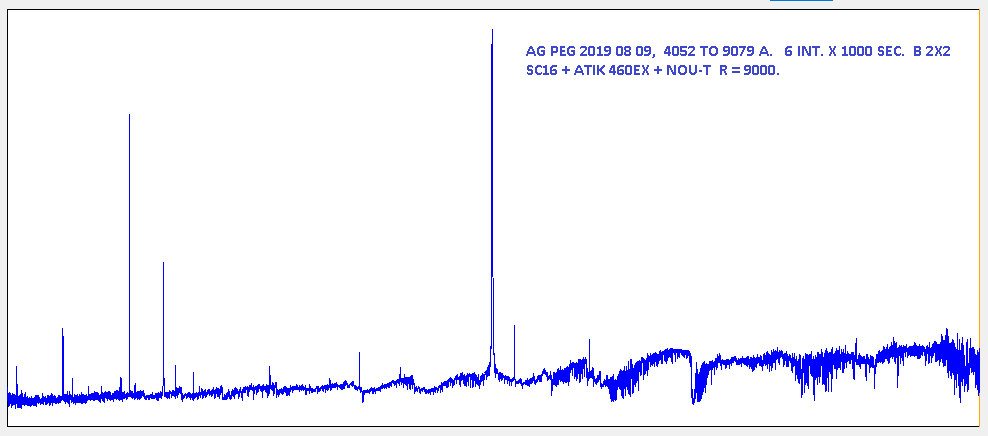

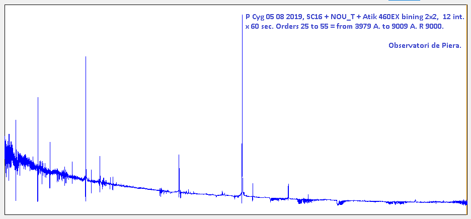

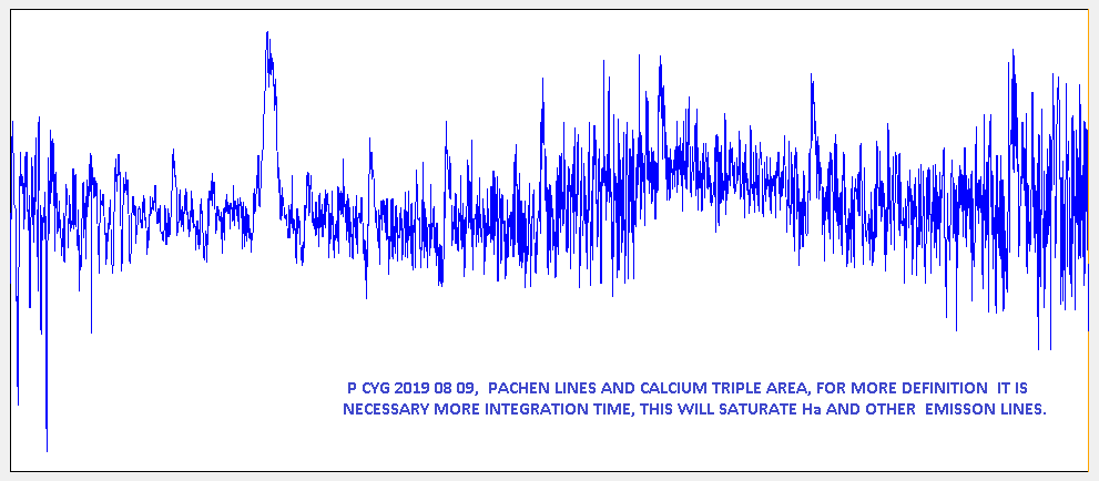

- Posts: 731
Although that some software problems the NIGHT it's ready for work. To fact I've started work seriously with it.
The mechanical part comportment it's excellent between the tour of these there three stars the maps pixels CCD variations are X0= and Y=1.
I think it's important in these graphics is can detect the calcium triplet at same time. I show you three examples.
Regards, Joan.

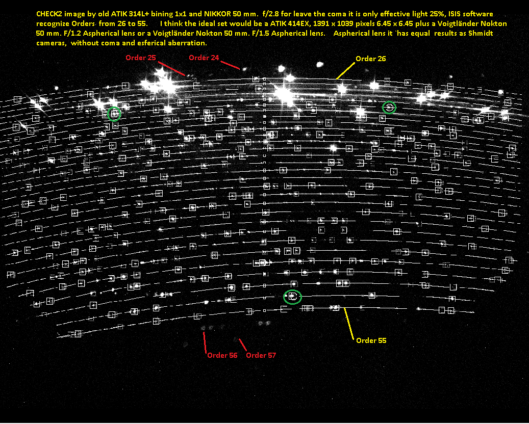

- Posts: 731
Hi only is a picture.
Joan.
Joan.
- CHECK2_55MM.png (565.94 KiB) Viewed 136926 times

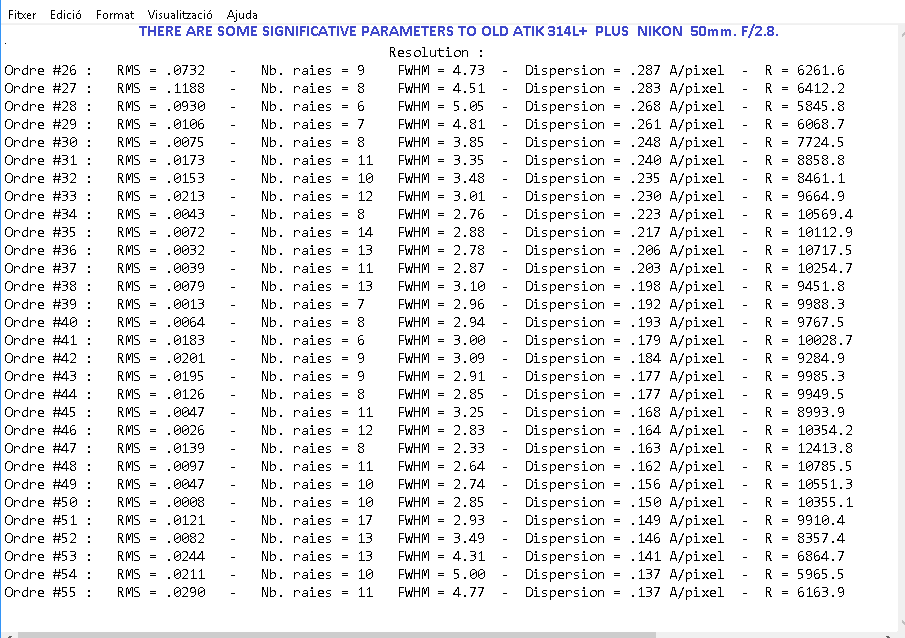

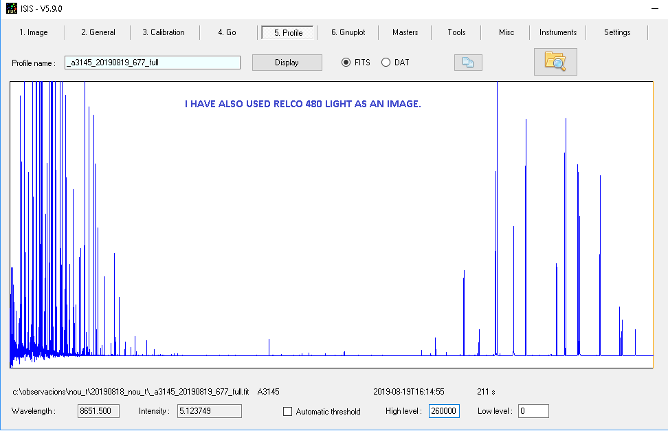

- COMP_ATIKS.png (877.43 KiB) Viewed 136886 times
- ORDERS 50 BO.png (391.32 KiB) Viewed 136886 times
- IMATGE RELCO.png (33.38 KiB) Viewed 136886 times
- PARAMETRES.png (57.79 KiB) Viewed 136886 times

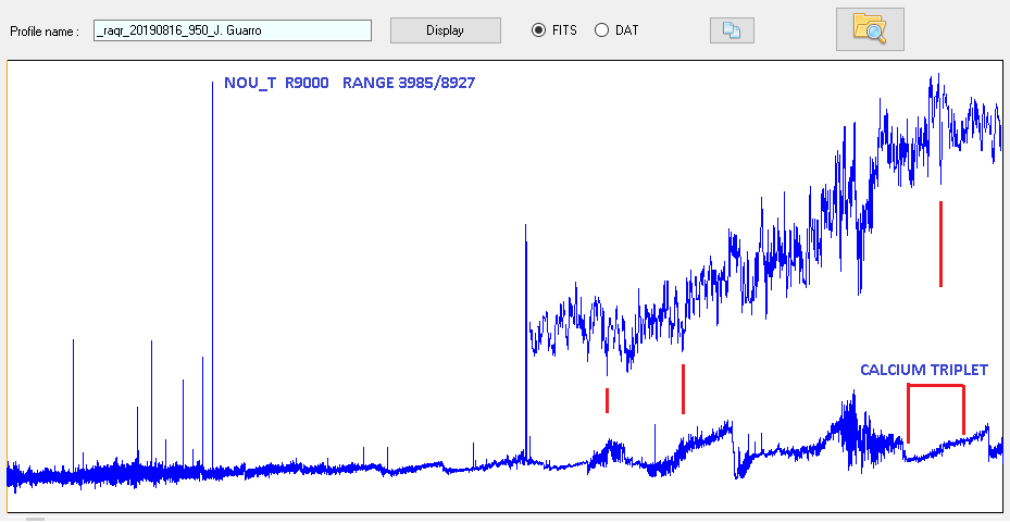

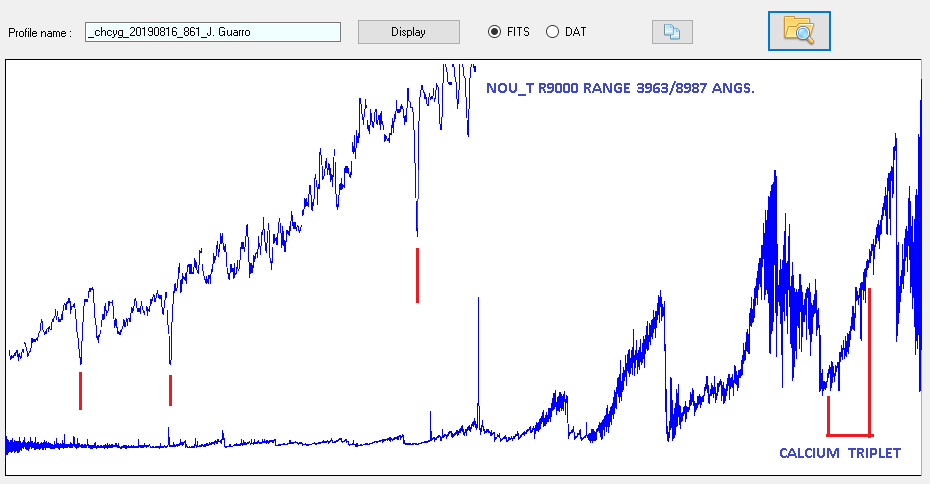

- Posts: 731
G.F.
G.F.
