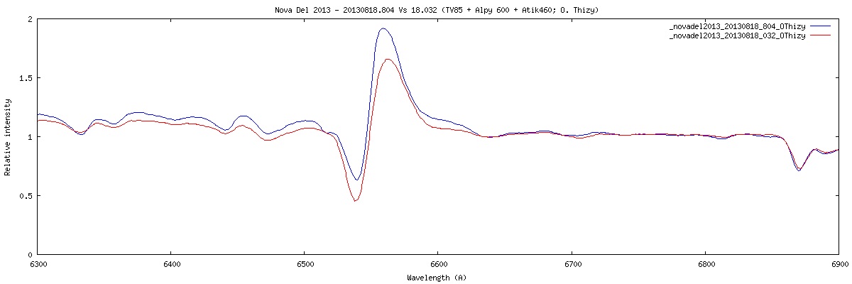

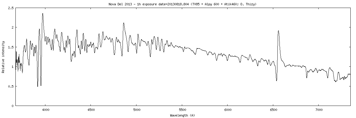

Fifth night on the nova... weather has never been so nice with me this year! :-)
Here is my first serie of tonight:
Changes are well visible in Halpha for exemple!

Evolution of HAlpha line since 24H.
In blue, the spectra taken yesterday
In red, the spectra taken just now.
Notice, that the Halpha line increase in emission and the part of HAlpha in absorption decrease.

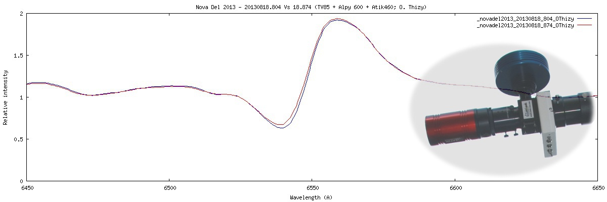

clouds are coming in so I have to give up observations tonight... Too bad as even between two exposures taken 1h40m apart tonight, I was able to see the change in Halpha which is happening at the moment: the emission is growing and Hlpha is now the brightest spot of my raw spectrum (was around Hbeta before)...

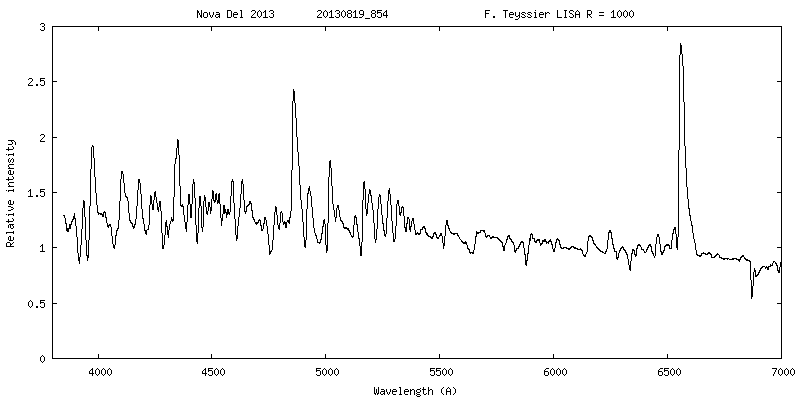

Spectre du 19-08-2013
Evolution très rapide - le profil P Cygni de H alpha a presque totalement disparu
