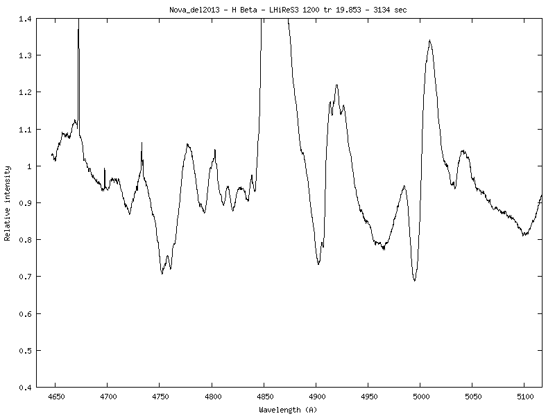

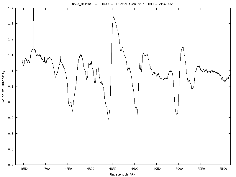

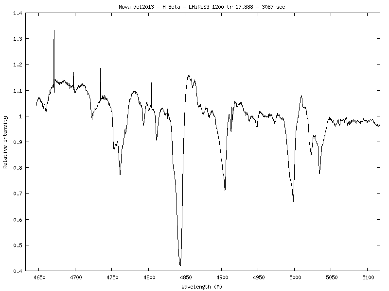

Bonsoir,
Et je confirme qu'en H Beta ça a aussi disparu avec une croissance impressionnante de l'intensité.
J'ai enfin traité mes images des 3 dernières nuits et ç'est réellement impressionnant de suivre cette bête-là.

A si, un petit détail ; dans mes images jointes apparaissent quelques "spikes" ; ce sont les défauts de l'images d'étalonnage qui ne partent pas bien au prétraitement. Mais en même temps, ça permet de vérifier que tous les pics se superposent bien donc que l'étalonnage est correct sur l'ensemble des images...
Eric

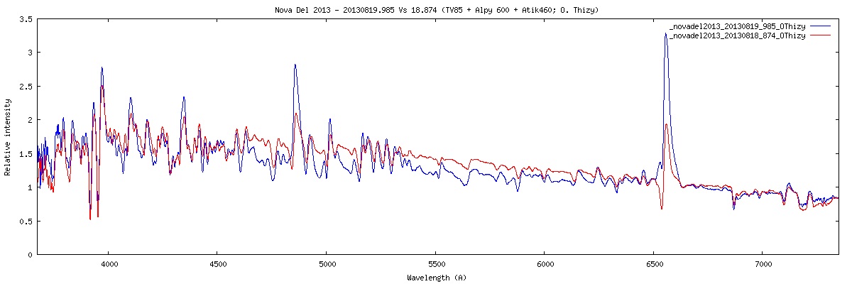

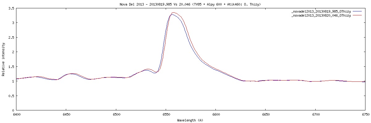

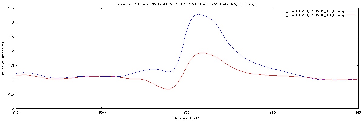

Huge change in the spectrum tonight (again!). Halpha is getting very strong and is the main feature of the spectrum (this is where I now check my raw spectrum doesn't saturate). I also had to reduce the exposure time from 180sec to 120sec so I am guessing the nova is brigther now than ever - is it confirmed by phometry?
Anyway, here is my first spectrum of the night which began with a cloudy sky but no a clear and nice starry sky with a bright Moon: A comparison with last night spectrum on Halpha show clearly the change: A comparison of the overall spectra:

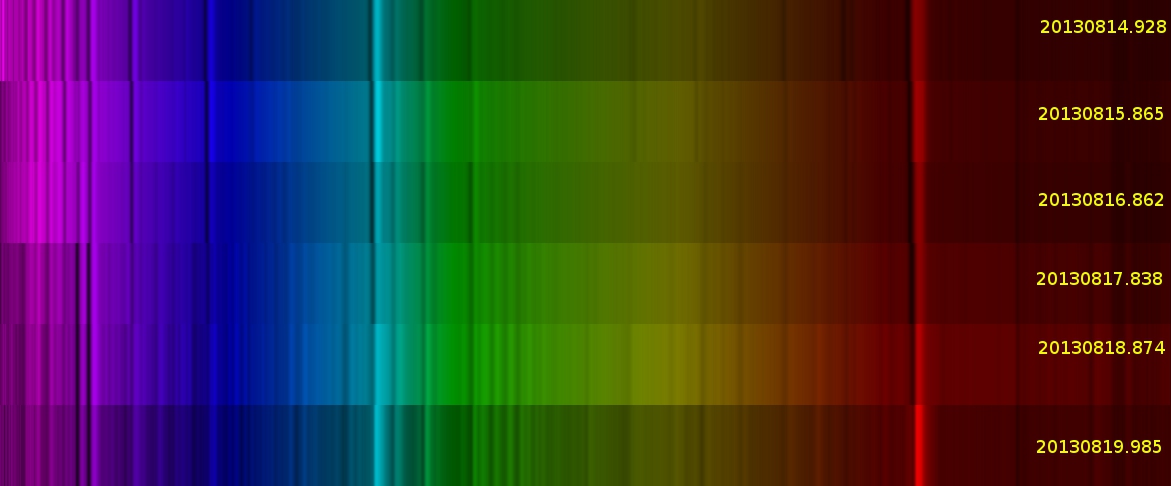

Last but not least, here is a compilation of 6 nights on the nova, showing the change night after night:

It's crazy... change is well visible at R=600 in one hour time:
Continuous spectroscopy is really required to monitor this!...

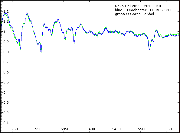

My first small contribution from last night (using LHIRES 1200 at one of the wavelengths I am using for the WR star campaign) shows good agreement between observers (spectra taken within 1 hour of each other) Tonight I have moved up slightly to ~ the Na D lines.
- nova_del_2013_20130818_THO_OGarde.png (12.53 KiB) Viewed 22532 times

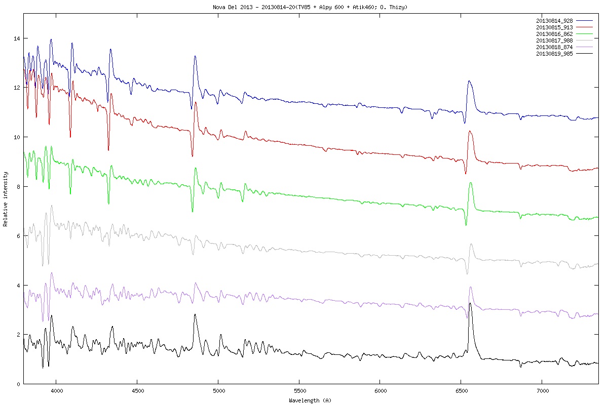

here is a graph with six spectra (one per night) showing, in low resolution (Alpy 600: R=600 resolving power), the evolution during this short time frame:

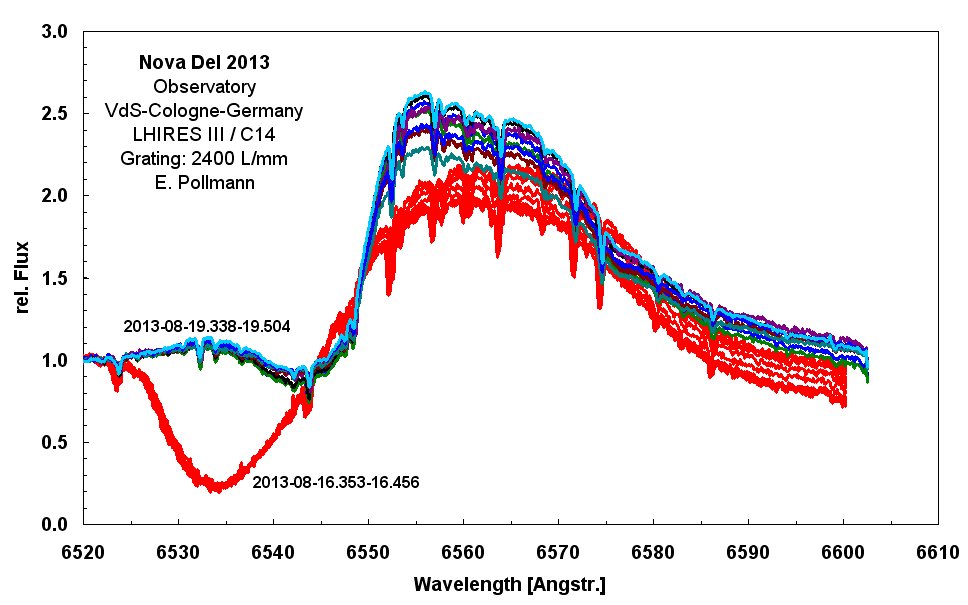

- Posts: 461
Here in a high resolution mode (Halpha range) the comparison of the development between August 16th & 19th.
