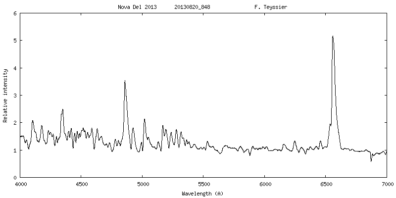

I confirm Terry's observation.
Very strong Halpha line in emission (no more absorption line)
Very strong HBeta
And some others lines between H Alpha and HBeta.
I reduce my exposure time from 200s down to 180s.
Very strong HBeta

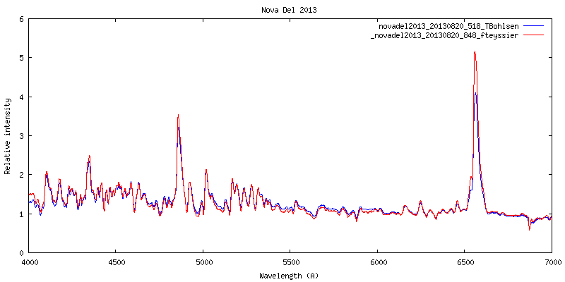

- Posts: 1562
Impressionnat cette augmentation de l'intensité relative de H alpha
Le spectre de cette nuit
Comparison with Terry's spectrum acquired only 8 hours before

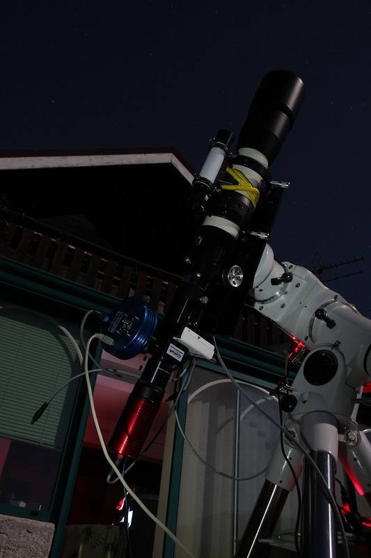

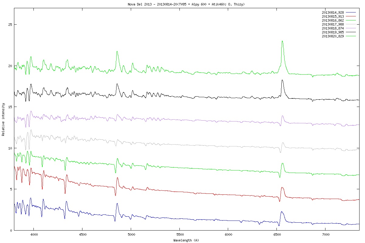

- Posts: 370
la petite lulu de 85mm est en route sur la nova. Effectivement, j'ai du réduire le temps de pose de 120sec à 90s pour ne pas saturer; et Halpha est vraiment en forte augmentation. Voici le graphe des 7 spectres (un par nuite depuis le 14-août); le spectre du haut est le dernier pris il y a quelques minutes:
Little 85mm refractor is active on the nova at the moment. I had to reduce exposure fro 120s last nigth to 90s now to avoid saturating. Halpha is growing. Here is the graph with 7 spectra (one per night since aug-14); top spectrum is the lat one from few minutes ago:
and a pic of the equipment by night, under the Moonlight:
http://www.shelyak.com/en/

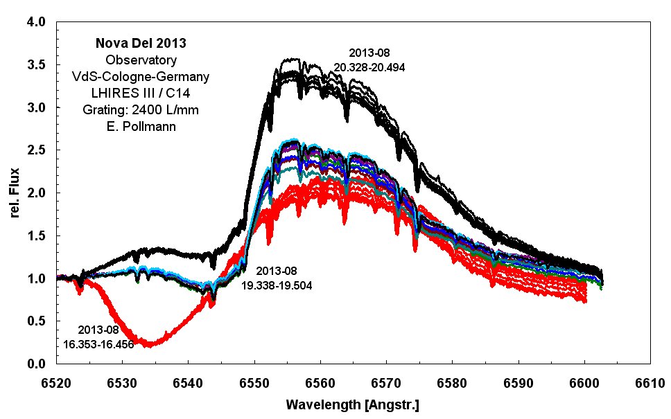

- Posts: 461
Here the compilation of high resolution spectra, taken with LHRES-III of last night.
The Halpha emission did increase clearly. Also the absorption component is filled up with emission.
http://www.astronomie.de/astronomische-fachgebiete
